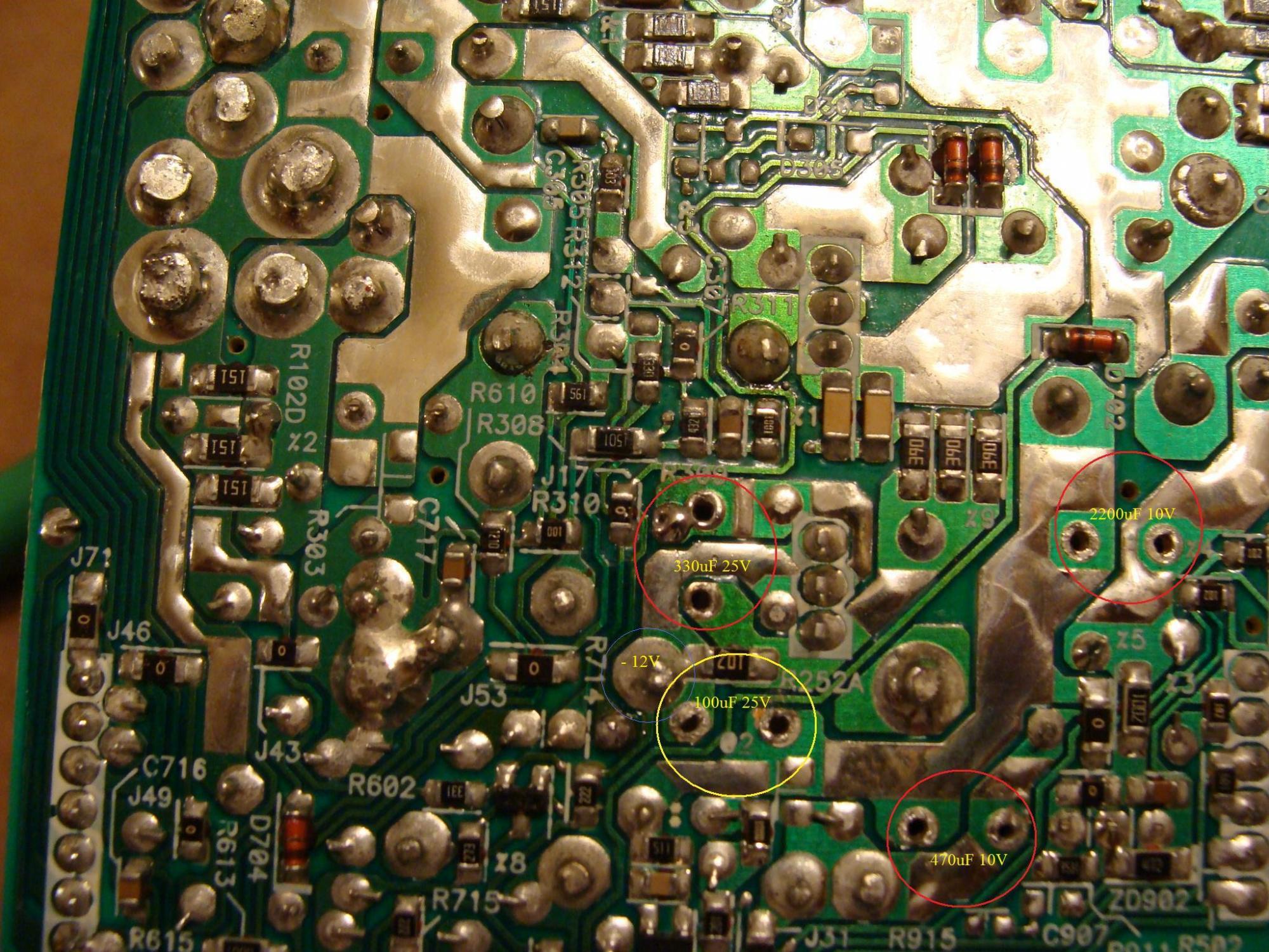

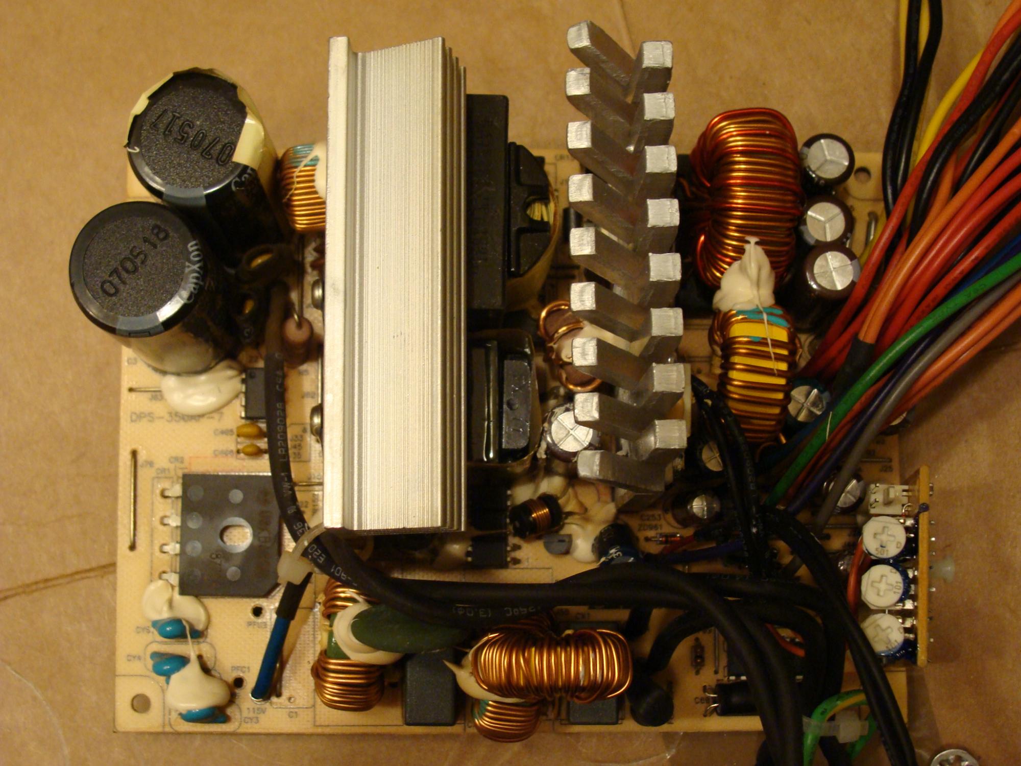

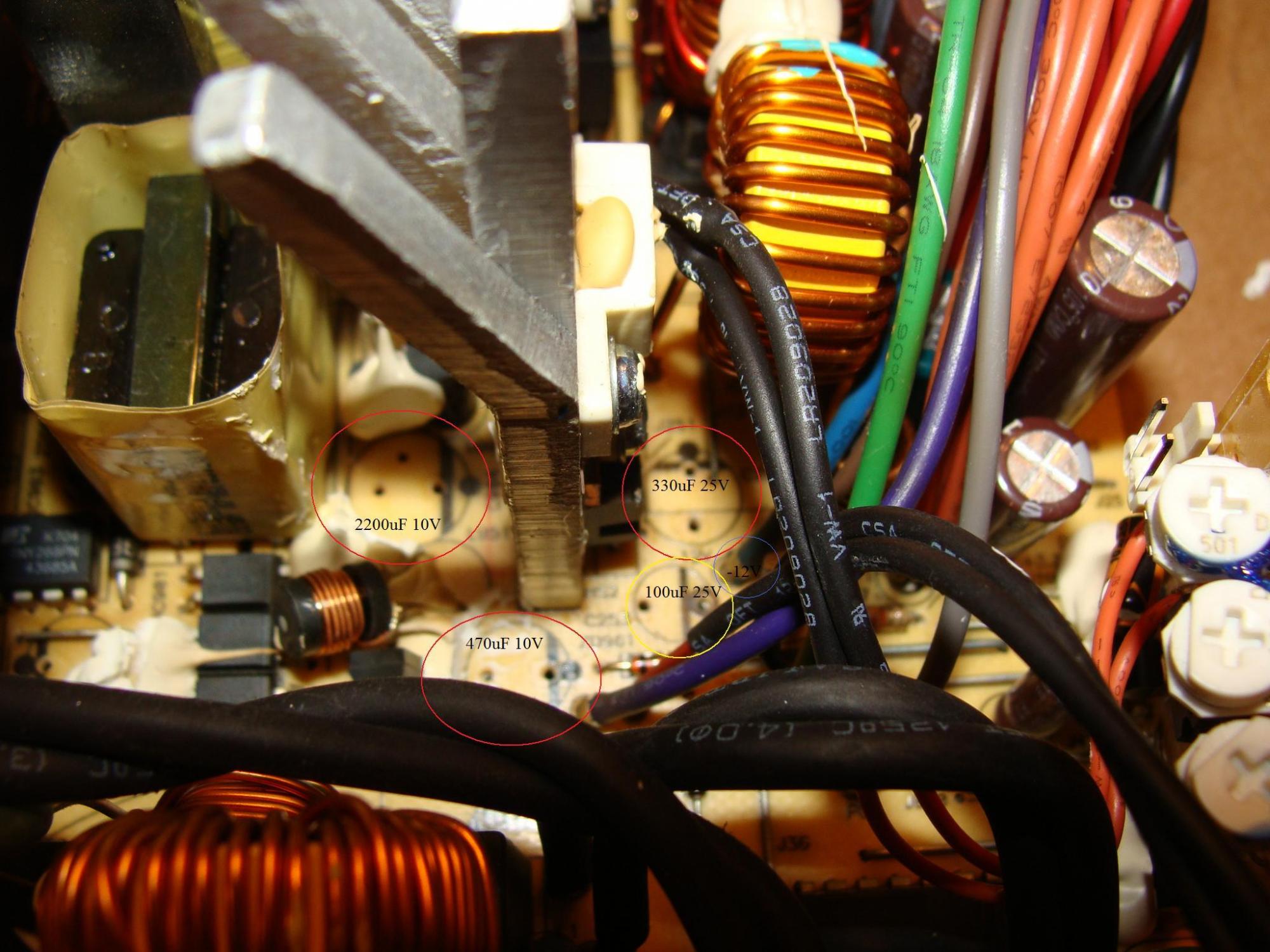

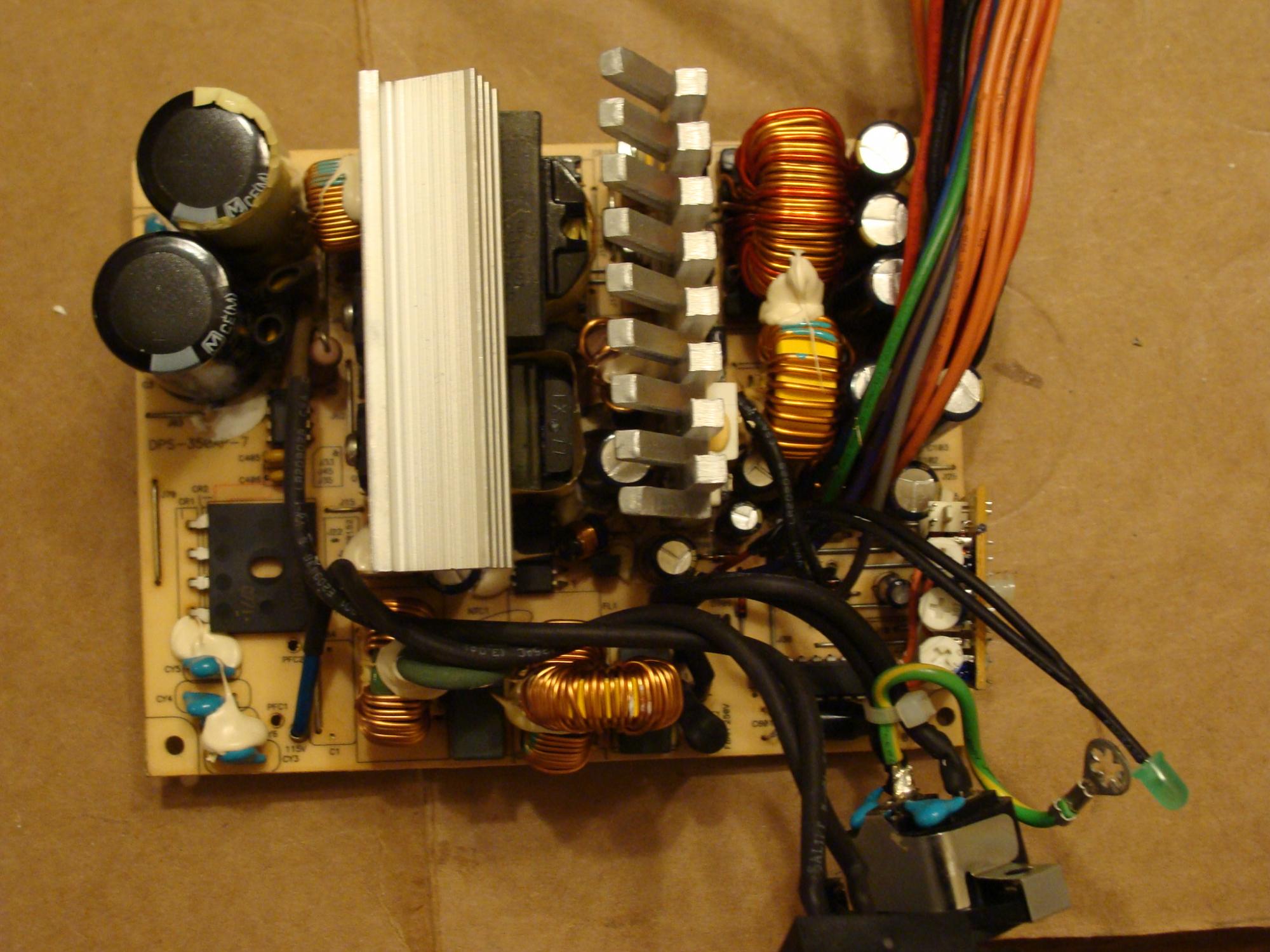

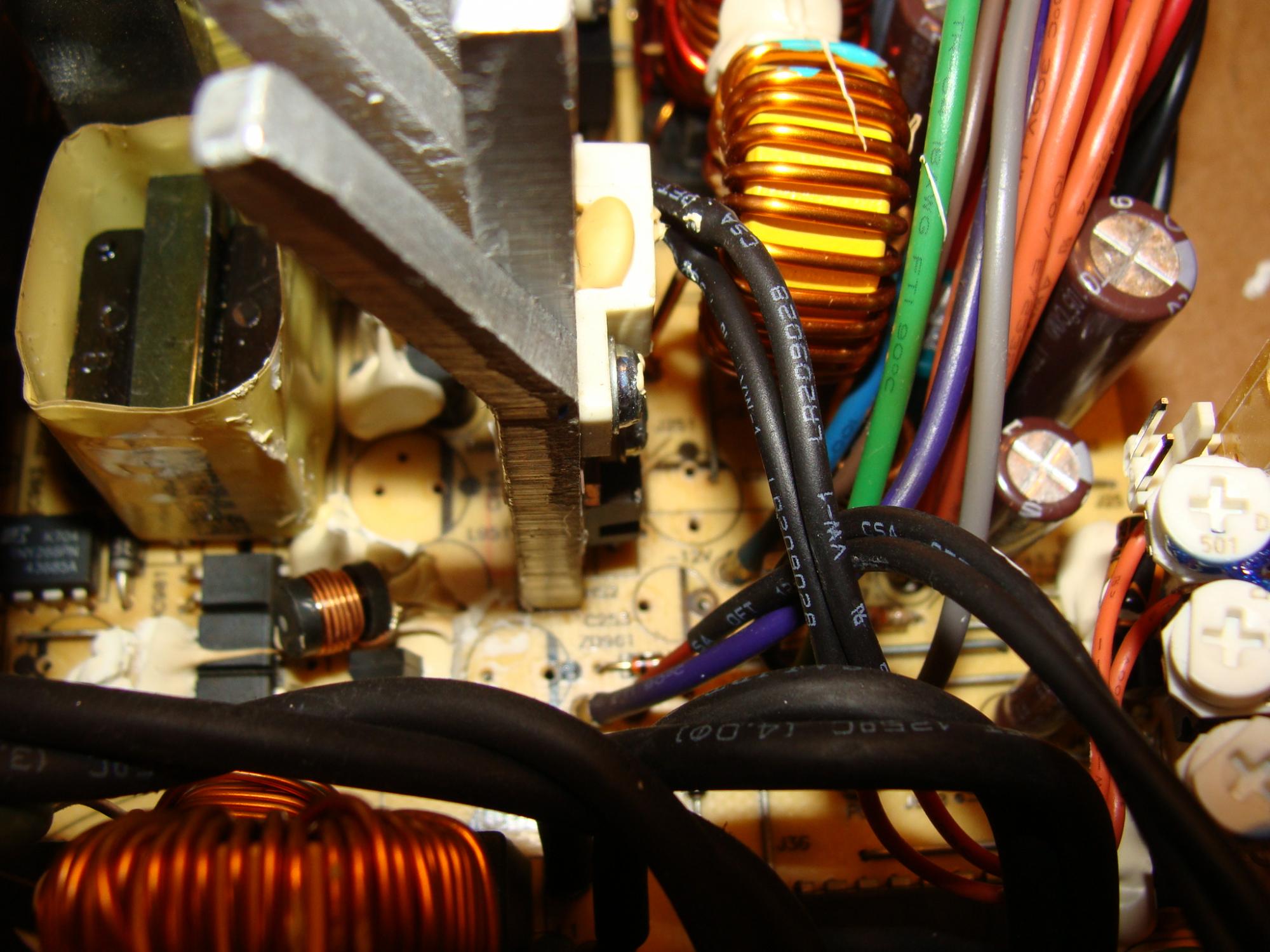

Found a bulging CapXon in my PSU, and I plan on completely recapping it.
It has the following caps:
CapXon (2) 680uF 200V LP 85c
(1) 100uF 25V GL 105c bulging and bung pushing out
(1) 22uF 50V GL 105c
(1) 10uF 25V SZ 105c
UCC (2) 1500uF 16V KZG 105c
Ltec (1) 470uF 10V LZG 105c
(1) 330uF 25V LZG 105c
(1) 100uF 50V LZG 105c
(1) 1000uF 6.3V LTG 105c
(3) 2200uF 10V LTG 105c
Taicon (1) 2.2uF 50V VT 105c
(1) 2200uF 6.3V PW 105c
Have the specs on all except for Ltec LTG series and Taicon PW series.
Plan on using Panasonic FC and either Panasonic TS-ED or TS-HC.
Any feedback would be appreciated.
