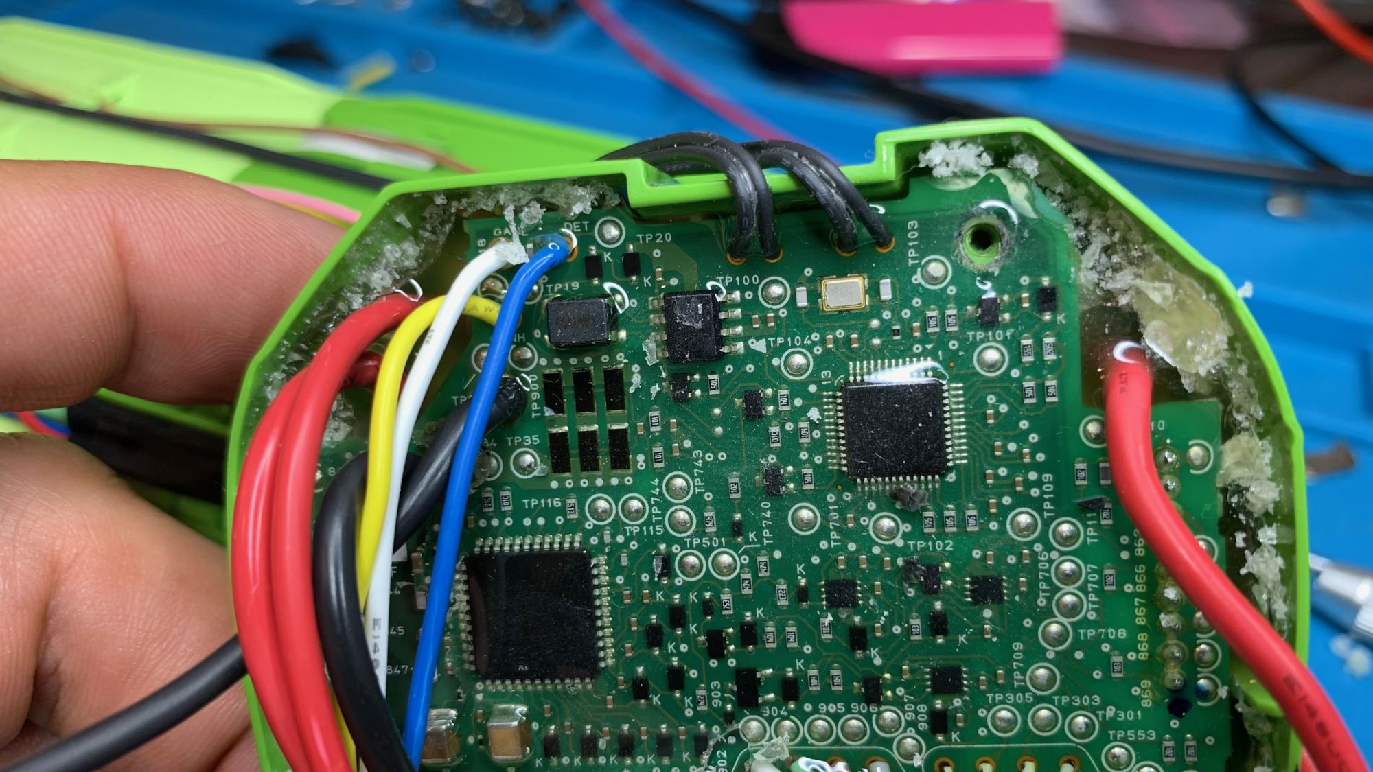

    I have a 36v ebike battery , and I managed to connect the charger in reverse way . Thank you Giant for not making the connector fool proof.
    The connector has the following pinout:
    P+ , A, B , C, D , P-
    P I am guessing is the power input
    A-D is to check the voltage from each cell bank

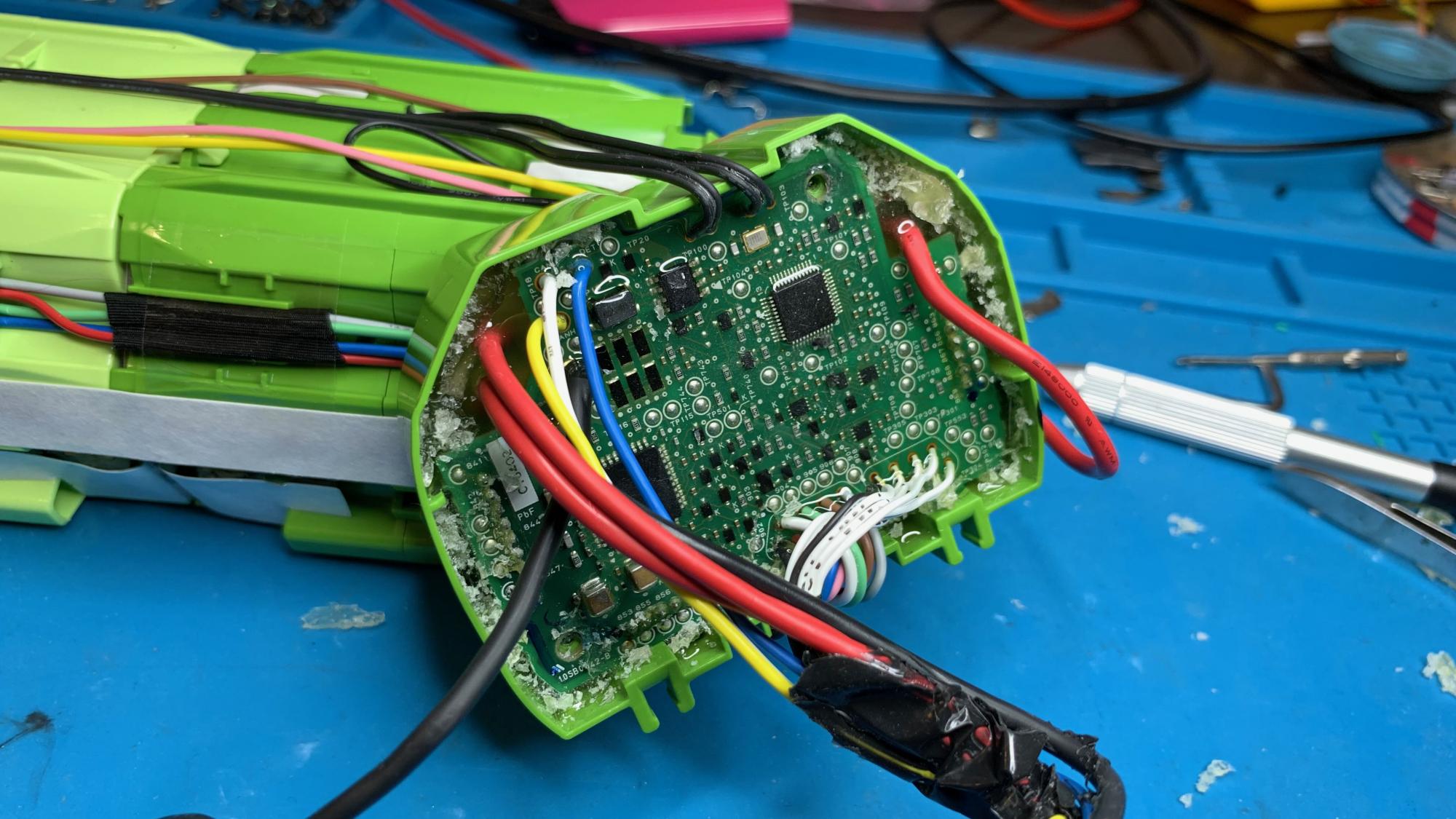

    I have taken the battery appart, but the circuitry is deep in some silicone ... to protect it from water.
    Before I go any further with digging , do you think there are any chances to repair this battery ?
    Could there be any protection circuit that might blow to protect the rest ? in this case any idea how I can identify that ? what to look for ?
    By looking the the components , there doesn't seem to be anything obviously burned / broken
    Thanks for the help

    post some close up in focus pictures .

      Re: E-Bike battery connected the wrong way
      Attaching some close-ups. Thanks
        have you checked the charger ?
          Yup. I have borrowed one from a fried and the battery behaves the same
            there might be a fuse that's blown
              Or you fried the BMS board
              With that said you should never assume that red is positive and black is negative you need to check it with a meter I have also done this myself before because some manufacturers do not always follow the normal guidelines for red is positive and black is negative also some battery cells are not normal either Lithium-Ion Lipo 4 battery cells are different than normal Lithium-Ion battery cells
                was there any heat or smoke involved?
                What are the voltages on each cell of the pack, are they normal?
                Strange you had access to the interstitial nodes, which means that it was monitoring something...wrongly... also I don't know what's doing balancing either, if you have access to the interstitial nodes, the charger had to deal with balancing too.
                  thats a lot of stuff on that board!
                  i'm not sure what the extra wires are for - more pcb pictures would help as it seems to have the wire-points labeled on the board
