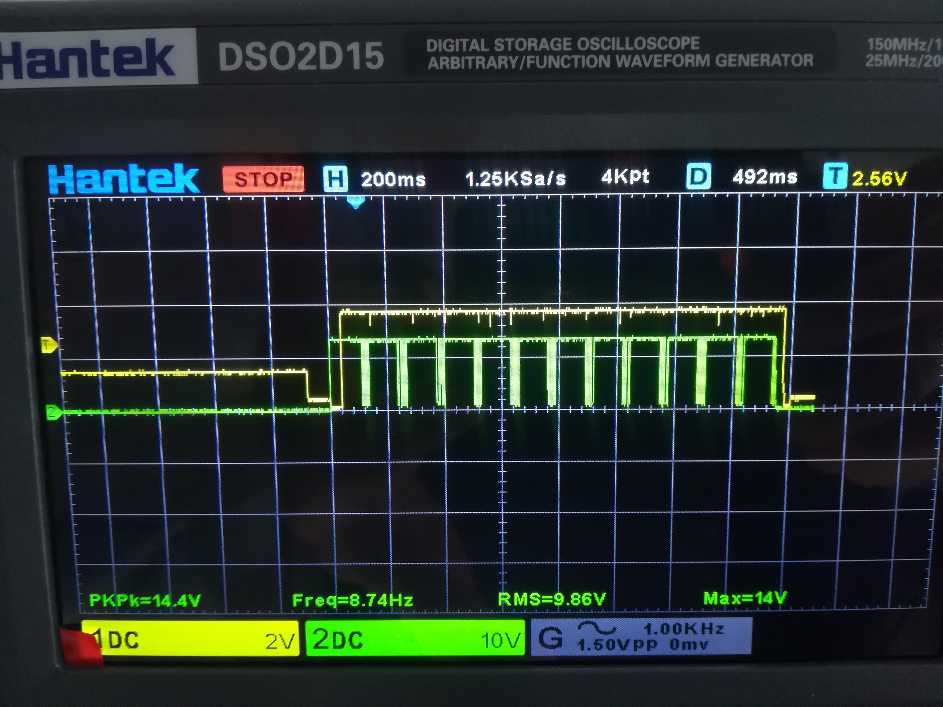

    Hi friends,
    I got to fix STIHL AL 300 battery charger, for mower machines, which works fine only when the battery is discharged ( haven't tried it already, since I got only fully charged battery, but that's why I have been told ). When the battery has some % of voltage, the charger doesn't work. In this case, the red LED starts to flash 10 times, and there is no voltage at the output. The customer tried more batteries, and it worked like this with all tried batteries ( so looks like not a battery related issue ).
    I would try to discharge the battery ( with few 12V lightbulbs in series, since I don't have any device to fit it in ), and would try to confirm that claim, but I would try to diagnose the charger so far.
    Between the charger and a battery, there are three power supply wires ( one for positive and 2 for negative voltage ), NTC BAT wire and DATA wire. On the first picture, you can see the communication between devices ( green is DATA, yellow NTC BAT ) right after plugging in a battery. I wonder, if the issue is related to DATA communication and if so, if I am able to identify it somehow ( maybe compare the communication between charged and discharged batteries with logic analyzer? ). Or if it is related to battery voltage itself ( some voltage comparator on the board, etc ).
    Does anyone have any experience with this weird fault? I would be thankful for any hint. If you need some more info, feel free to ask. Thank you in advance.

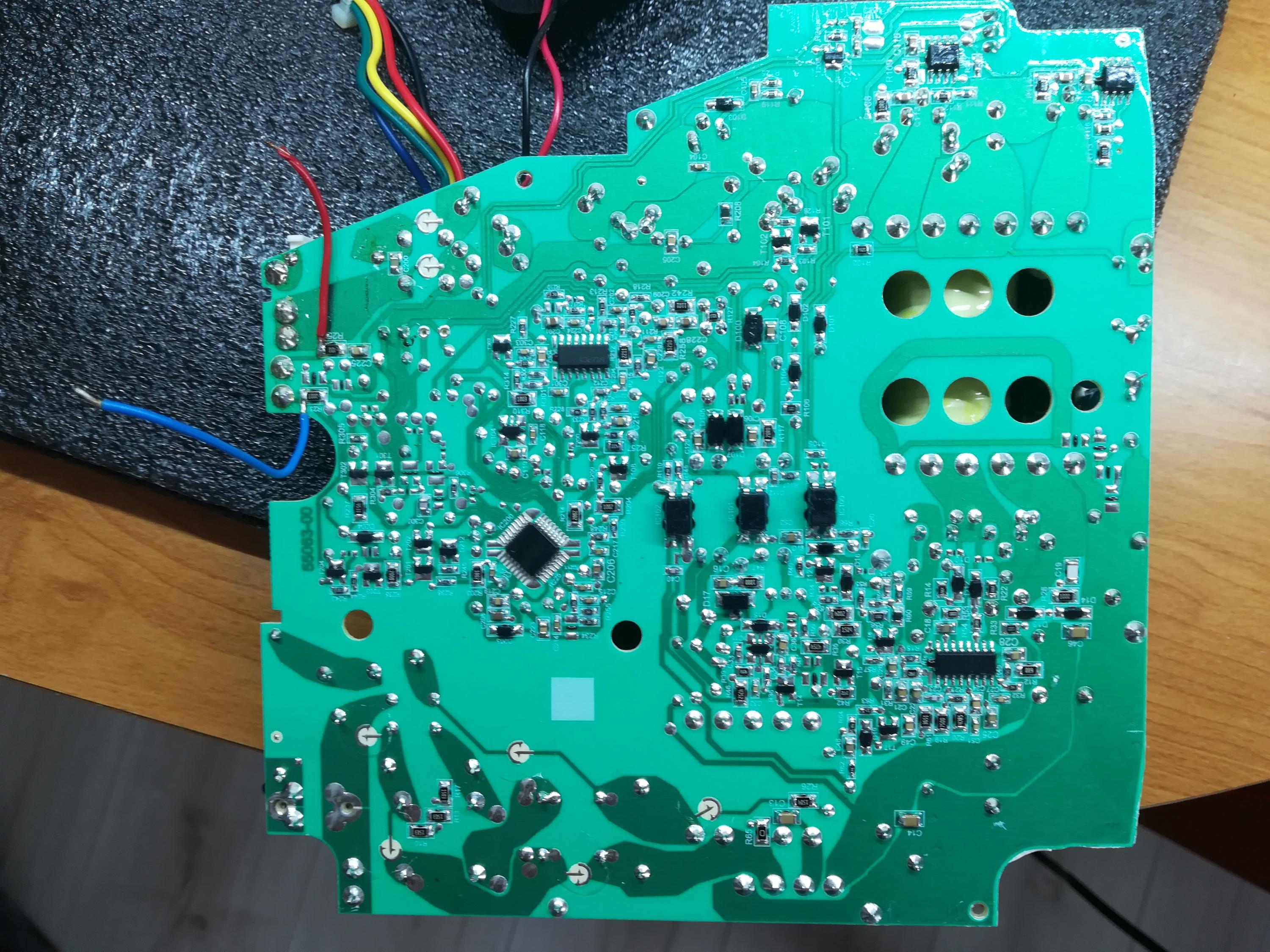

                    I am on 32V ( 36V stated on the pack ), LED status on the battery shows 1 from 4 and it flashes ( so its fully discharged ), and I am unable to make it charge - customer said, it is charging only when a battery is discharged, so its not working at all now.
                    I have already made some brief visual inspection, for bad solder joints, etc, but haven't found anything suspicious. Will give it another try, more precisely this time.

                      • 31293
                      Re: Battery charger - STIHL AL 300
                      about that scope-shot.
                      why is a logic signal 14v?
                      and did you zoom in to see if that was data packets or just pwm?
                        • 31293
                        also does it try to charge? is the charger outputting power for a second?
                        maybe the mosfet is dead if it's not
                        • YellowJacket
                          • Dec 2020
                          • 107
                          • Slovakia
                          - 14V is directly on wires coming from the charger. I traced the connection to pin of some uC, and there is exactly the same waveform, but with max voltage around 4.5V
                          - yes, I zoomed out, and its for sure some digital data
                          - yes, it does try to charge, but only for very brief time ( fan starts to spin, LED on the battery starts flashing ), less than one second. I have voltage on the secondary side of a transformer. It starts to fall after the charger decides to stop charging though ( after plugging the battery in again, voltage on the secondary rises again for a brief time )

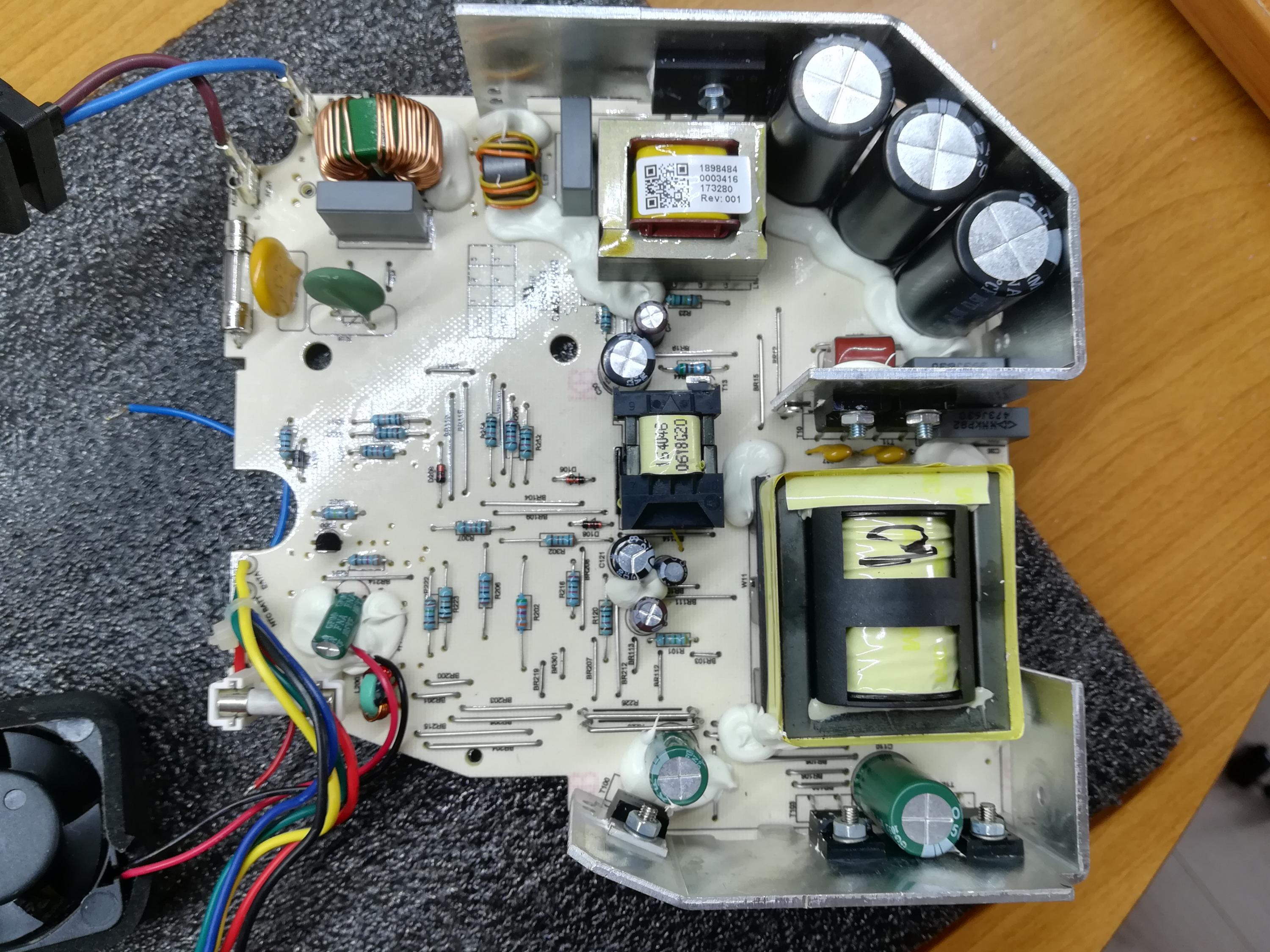

                                    Anyway, I observed a new fact - when I connect the charger to power source, there is no output voltage at the secondary side of a transformer! Before, I measured there voltage, but it was due fact, there is N-channel mosfet, between secondary and positive VBAT voltage, so after plugging the battery in, battery voltage appeared on secondary side via internal diode in that mosfet.
                                    So either, there is some problem on the primary side of a transformer, since there is no switching, or - I don't know, maybe it should start switching only after some condition is met? ( in my opinion - there should be switching right in a moment, when I connect the charger to power source, what do you think? ).
                                    I am going to dig around primary side now. Thanks for hints so far.
                                      • 31293
                                      time to fix the psu section - start with the caps
                                      • YellowJacket
                                        • Dec 2020
                                        • 107
                                        • Slovakia
                                        Main switching controller is L6599AD. I am afraid, I wont be able to diagnose anything without schematic - this controller is really complicated. It has 6V on VCC pin, but it looks like there are so many conditions, that have to be done, to make the controller start. It won't start switching at all, by the way. Without or with battery plugged in. Mosfets are fine.
                                        Measured voltage ( no battery plugged in ) at all pins are 0V, except:
                                        7 = 1.2V
                                        12 = 6.2V
                                        16 = 4.2V
                                        Am I understanding datasheet correct, when I say, that after VCC, there should be ramping up some other voltages? Datasheet page 25.
