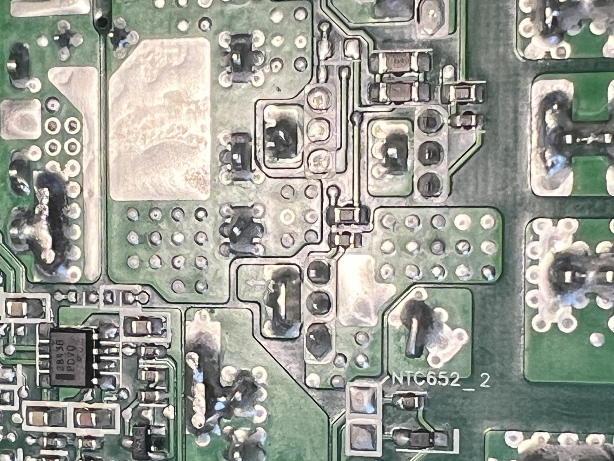

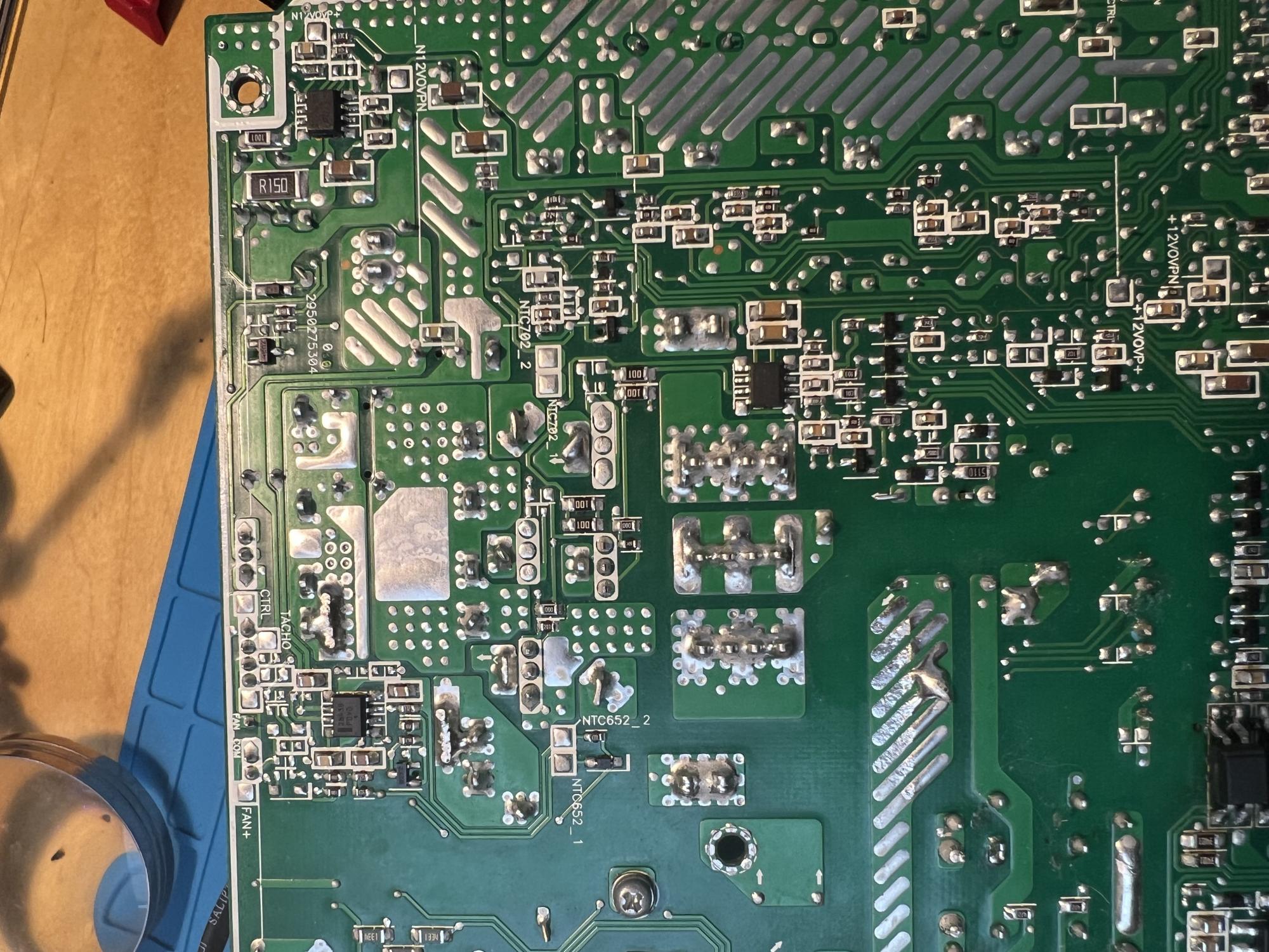

                      I haven't been able to trace much, since the PSU uses a double-sided PCB and there are too many components in the way to see how things are connected. But all I can tell you is that the 12V rail uses synchronous rectification. There are 2 N-ch MOSFETs located between the main transformer and main output toroid. You can see them on this picture of yours here (see towards upper left corner):
                      https://www.badcaps.net/forum/attach...6&d=1692212985
                      One of these MOSFETs is Q152. The other one I can't read the PCB designator. Both are attached to long aluminum heatsinks. Their connection is probably the same as the output of this PlayStation 3 PSU that I posted here:
                      https://www.badcaps.net/forum/attach...1&d=1526486481
                      In particular, your MOSFETs should be connected similar to how Q201 and Q202/Q203 are connected (Q202 and Q203 are in parallel, so you can regard them as one larger MOSFET.) However, please verify if that is true or not. To do that, use resistance measurement on your multimeter. If true, both MOSFETs on your PSU should have their Source pins connected to ground (you'll get 0-1 Ohms of resistance when checking between ground and the Source pin of each MOSFET) and their Drain pins should also show very low resistance to the 12V rail.
                      Now also verify that neither of the MOSFETs have a short-circuit between their Source and Drain pins, Source and Gate pins, and Drain and Gate pins. Let me know what you find.

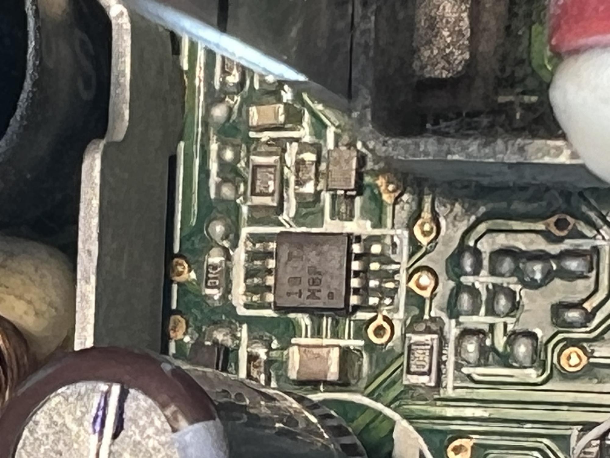

                        I have tested both the mosfets Q152 and Q154 and indeed the Source in conneted to ground and the Drain to the 12V rail.
                        I have only measured the mosfets in circuit so the readings on the pins are bit jumping arround. In diode mode i get 0,5V between S->D, about 20 KOHm between G and S (20K resistor) The rest of the measurements are jumping a bit, but no direct sign of shortcut...

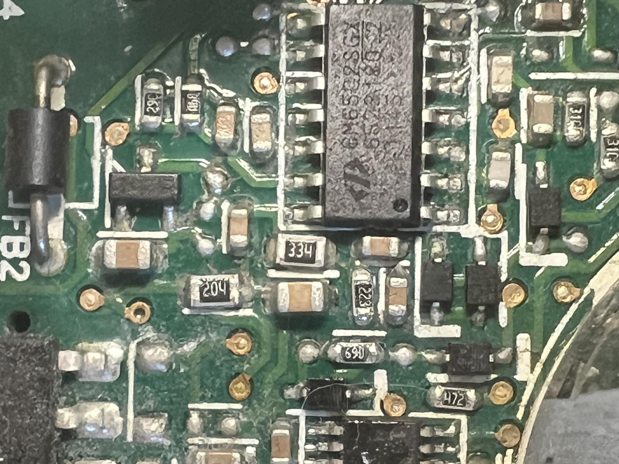

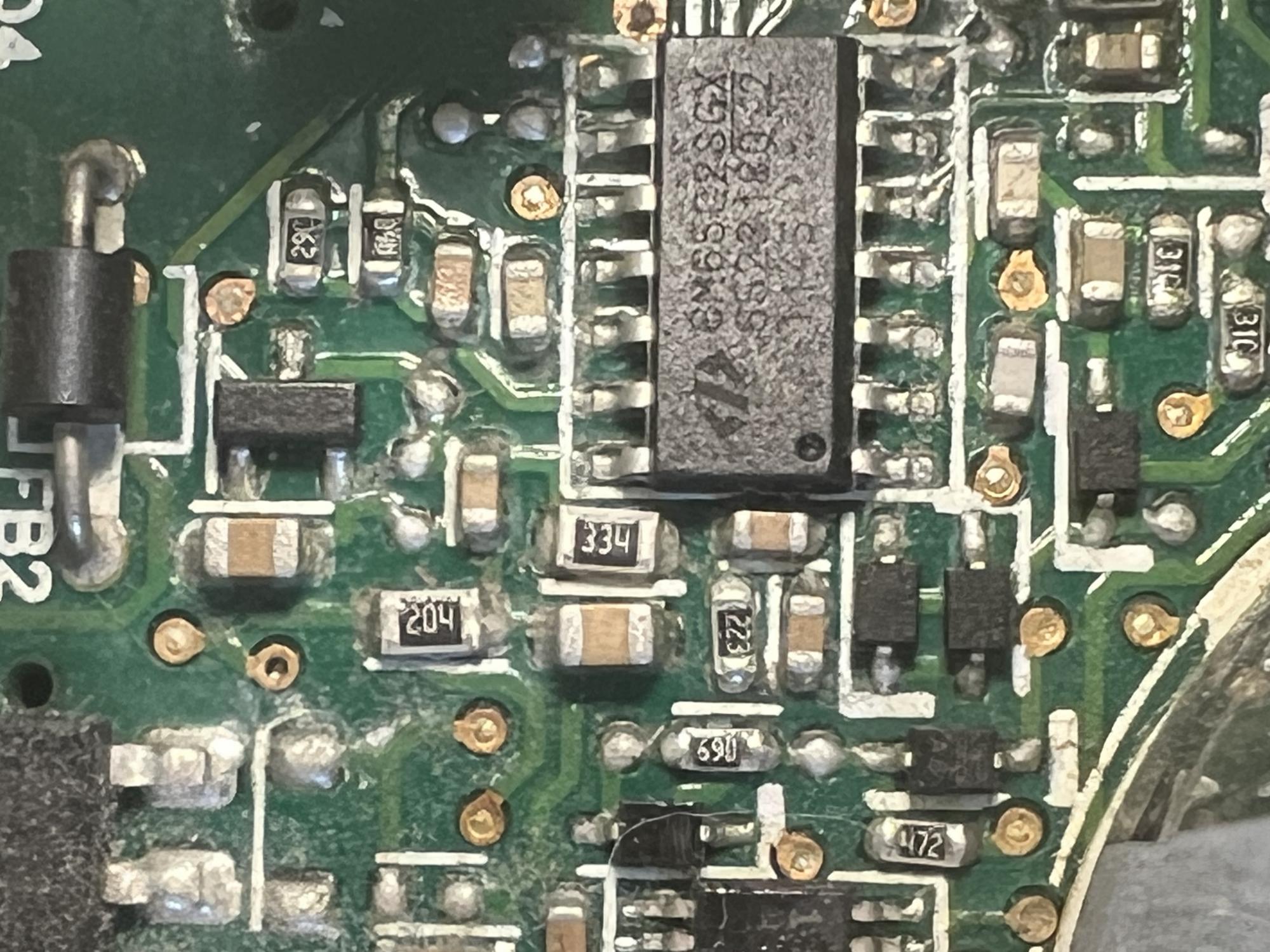

                        Both the Gates are routed via a 0 Ohm and a parallel restistor 5.4 Ohm to the controller chip PM8834 - EZ141

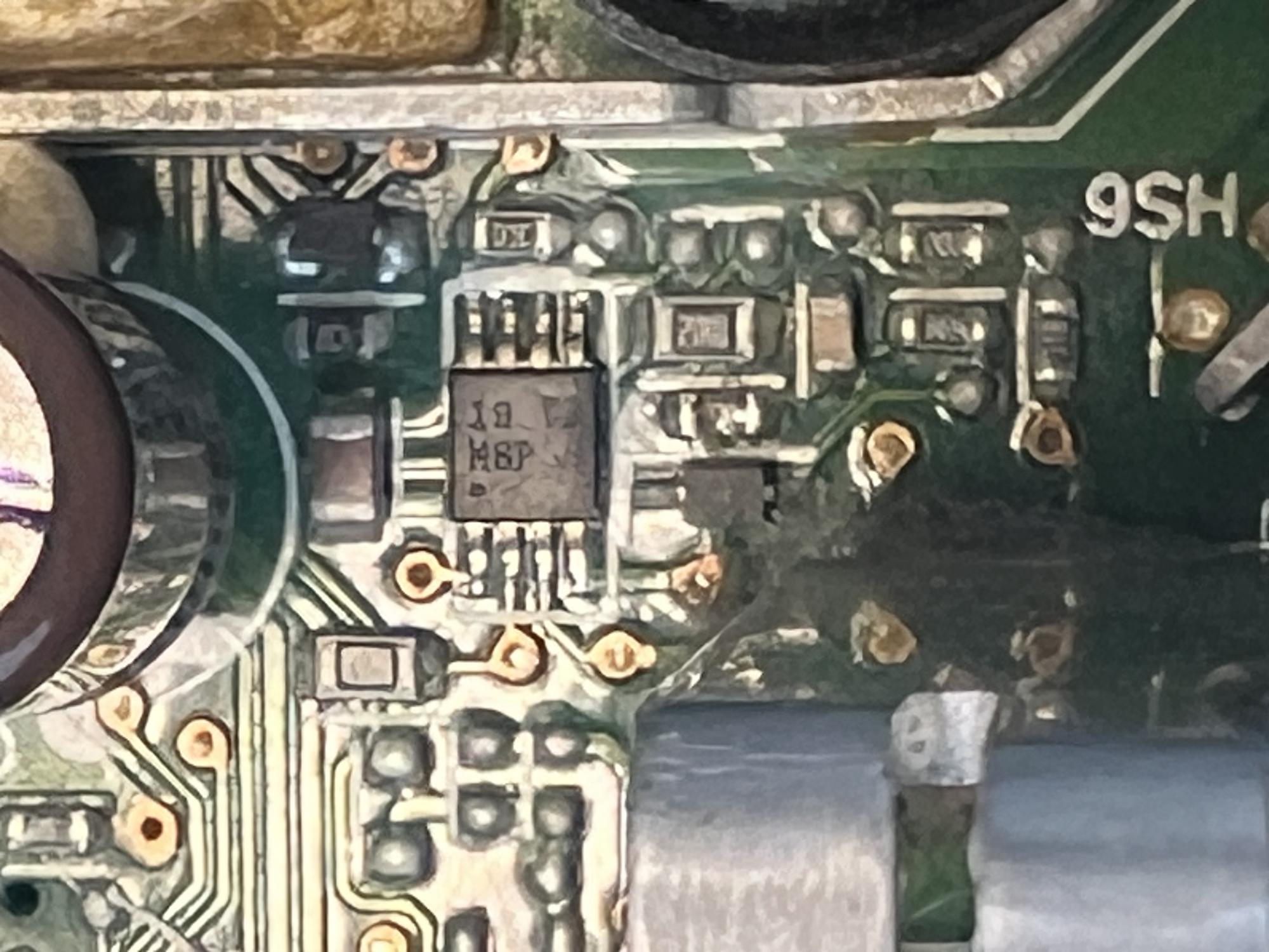

                        There is no Power supply on this chip, measured between VCC and Ground...
                        The VCC is leading via a 27kohm resistor to pin 1 of a chip 19 M8P TJ?
                        I have measured at some other location but it looks like there is no volage on the control circuit.
                          OK, at least that eliminates the MOSFETs as the culprit.
                          That's strange. Seems unlikely to me to have a 27 KOhm resistor in series with the Vcc, so perhaps that's not where the Vcc is generated from?
                          Does the 5VSB transformer have one or two outputs on its secondary side? If there are two outputs, the 2nd one could be used for Vcc of the controller chip (though likely won't be connected directly to it and probably would be gated by the supervisor chip at the same time the primary side is enabled via optocoupler.) And even if there is no 2nd output from the 5VSB traffo, perhaps the controller chip is powered by 5V via 5VSB. Though my hunch is that the Vcc should be higher than 5V, likely to drive the output MOSFETs a little harder for lower R_ds On state.
                          It could also be the Vcc is produced by a separate rectifier from the main transformer... though that also seems unlikely to me, since it would take at least a few cycles through the main transformer before Vcc is established, so maybe not the case.
                          If you have a datasheet of the controller chip, maybe try giving it something like 12V directly on the Vcc pin and try to power on the PSU immediately to see what happens. I'd save this experiment for a latter point or almost last resort, as you'll have to analyze first what would be the consequences of feeding 12V into the Vcc of the controller IC. To do it safer, you can use a 100 Ohm resistor in series, so in case something goes awry, the 100 Ohm resistor will limit the current to 120 mA.
                          Another experiment would be to feed the PSU's 12V rail with a 12V source (a small 2-3 Amp adapter should do, though using another ATX PSU should be fine too.) For this one, first power the 12V source (ATX PSU or adapter) and check if there's a high current drain going into the 12V rail. If none, then power On the PSU by connecting PS-ON to ground. Now try removing the 12V source and see if the PSU continues to run OK.
