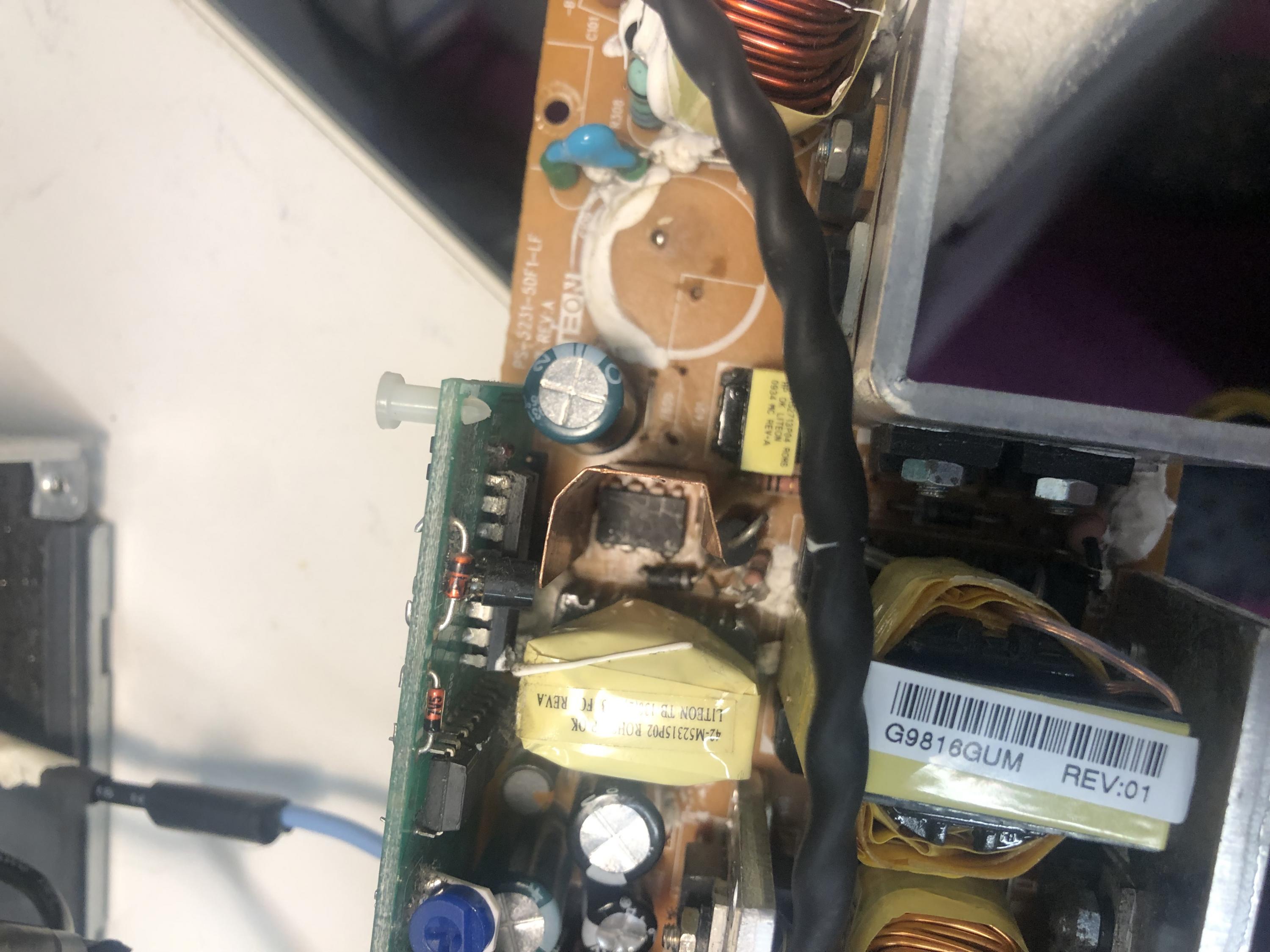

    I have an issue with this power supply. There is no output voltage on the standby section, the input section is fine, the bridge is fine and have stable 165 vdc on the bulk cap. While checking the stuff I saw IC501 along with the diode 532 (close to it) gets damaged (look at the picture, the one close to stb transformer). it's a 7 pin ic. I think this guy drives one of the mosfet attached to the heat sink. it looks as LinkSwitch-XT series IC but can't be sure as the top surface is destroyed. Any help would be appreciated. Please find attached.

    Usually the blown off lid pieces should be floating around inside the case. If you don’t have them, I suggest you carefully take that IC out and don’t damage it any further. Carefully look at it with a microscope and maybe we can piece together what was in there. Maybe there is a picture of it somewhere floating around too… other than that, we need a picture of the backside of the board and go by pin configuration of this IC.

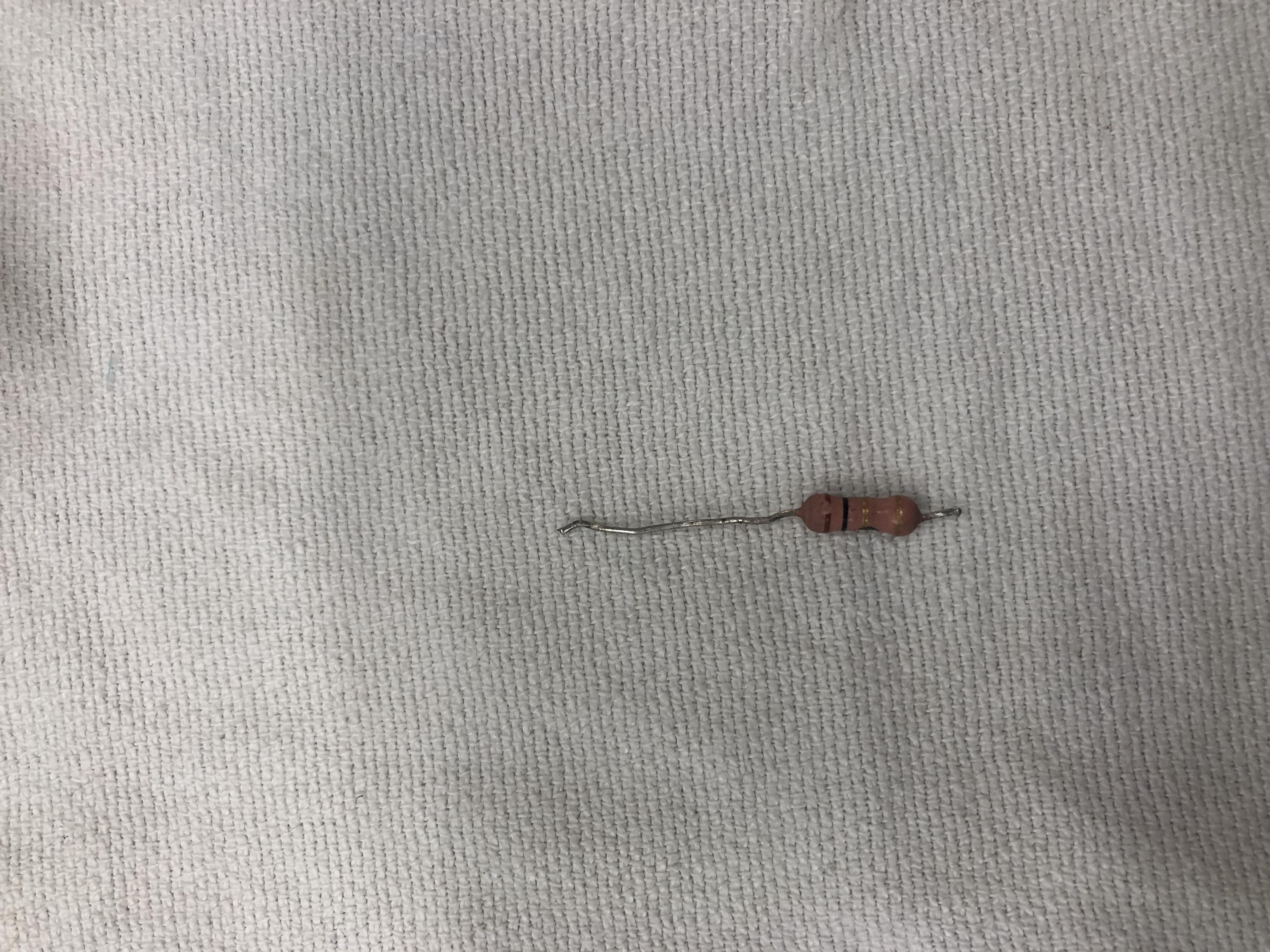

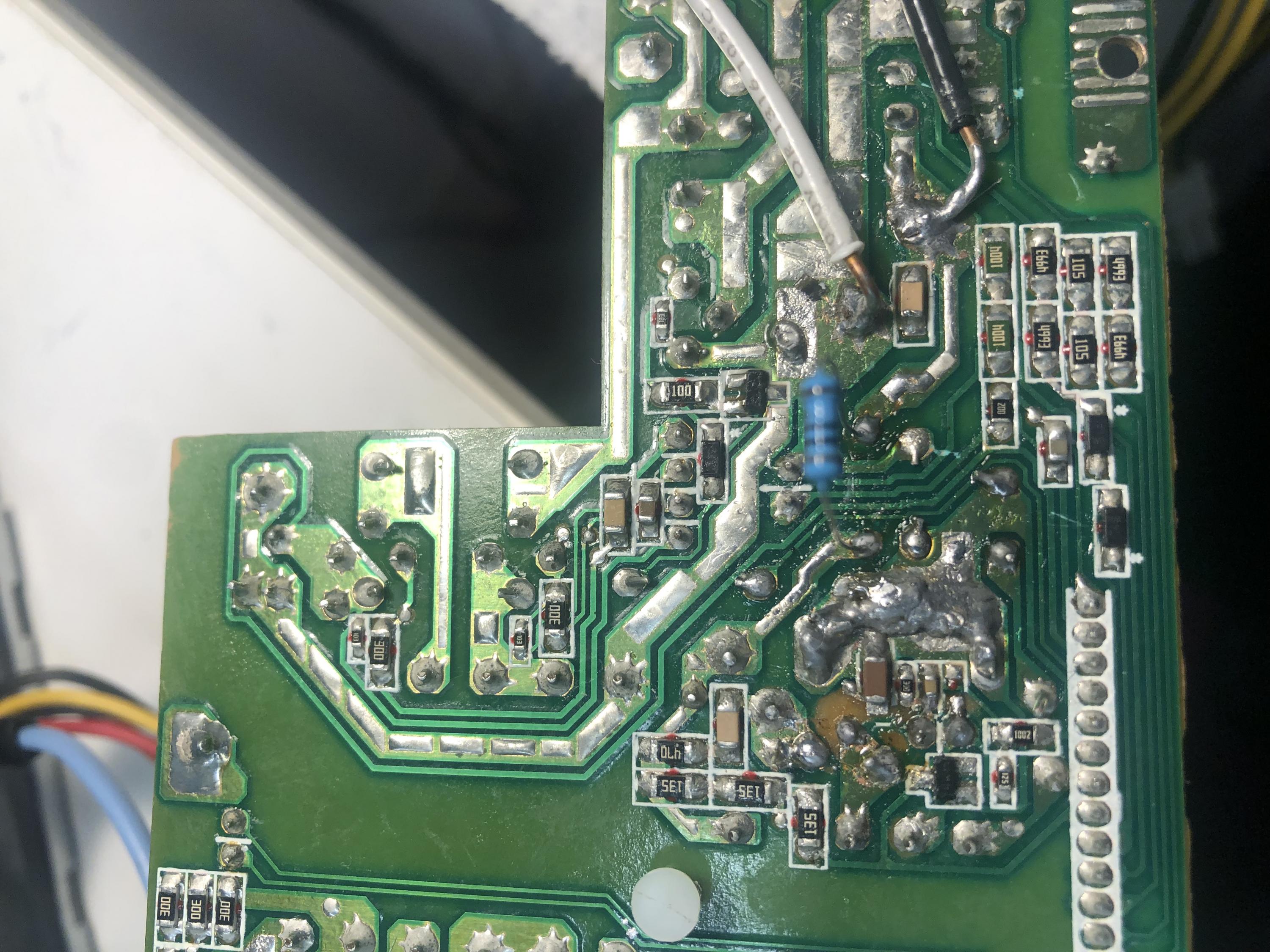

          Also, I found the attached resistor open, it's right after the main cap on the positive track. If I am not mistaken it's 1 ohm, 1/2 watt. After replacement I measured 170 vdc between the source and drain.

            You say a damaged diode was replaced… what diode was in there first place, which diode are we talking about and what is it’s function in a circuit? Your pic in the first post is too dark to see anything. Resistor is 1ohm, I read brown , black, gold, gold.
            I’d say your 13v must be quite a bit away from what should be on that enable pin.

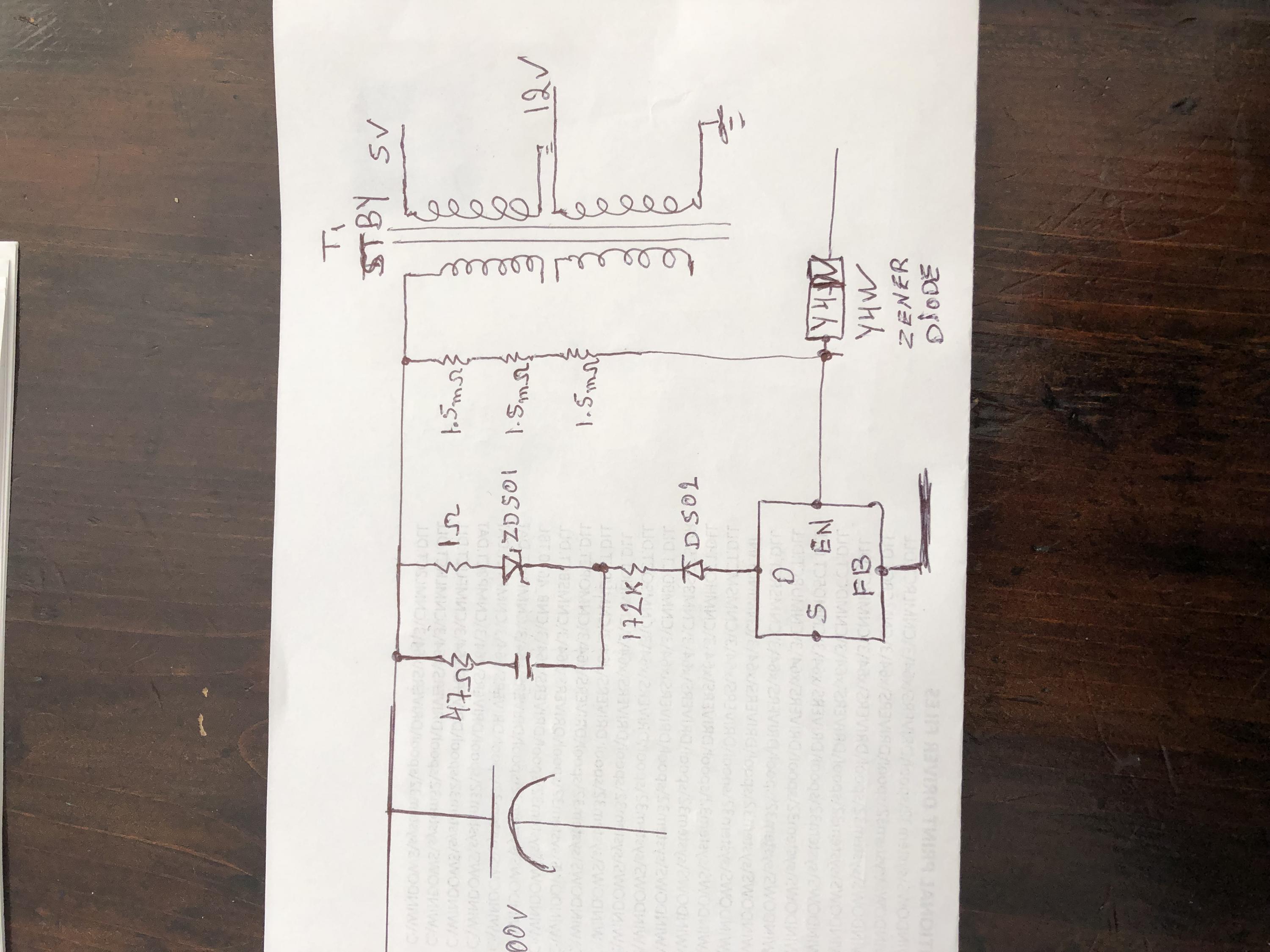

              this diode has nothing to do with EN/UV pin. See my drawing. I think there is something wrong with those three smd 1.5 megaOhm resistors. Sometimes I got 1.5 mega, sometimes 6, sometimes nothing (over limit). Also, is the brown smd component a resistor or capacitor?

                Take the resistors out and check them. However a higher ohm rating than spec suggests less voltage on the enable pin. Did you check that zener? What brown component are you talking about?

                    Rereading this, I don’t think there is anything wrong with these resistors. I think you are charging up an capacitor. That’s why you can’t measure anything after a while. Makes sense, the 13v got to come somewhere. I hate these small form factor PSU’s. Start scraping away all that glue / silicone, maybe there are more parts covered in this stuff. Cording to the data sheet, you should have have like 2.2v on that enable pin not 13.

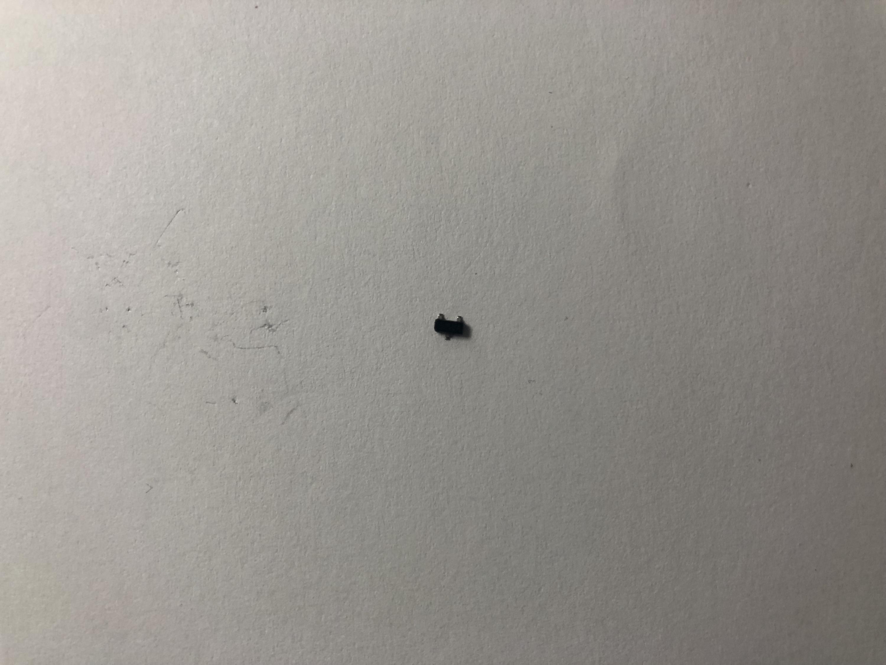

                      No. Resistors are fine but this very small voltage regulator diode Y4W (3 pin diode) near to EN/UV pin has no diode reading on it. its cathode (middle pin) is directly connected to the enable pin of IC. I tried all possible combinations. I am sure is dead. When it was removed from pcb, the measured voltage on En/Uv pin higher up to 36vdc. While waiting this from amazon can I install some zener (let's say with range from 2.2 to 15v) to test?

                        Y4W marking is a 15v zener diode. If you can’t measure anything from it, she’s bad anyway.

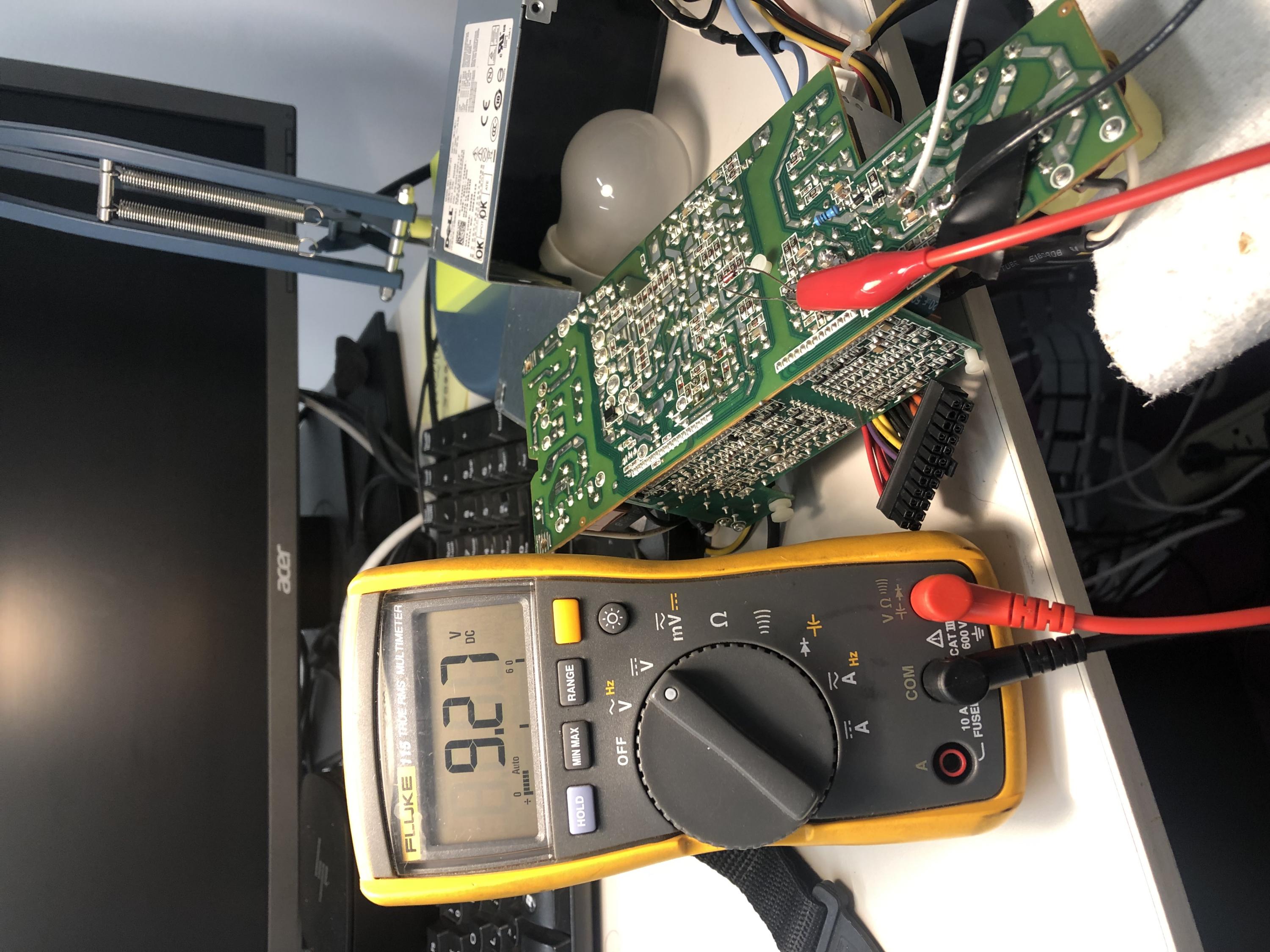

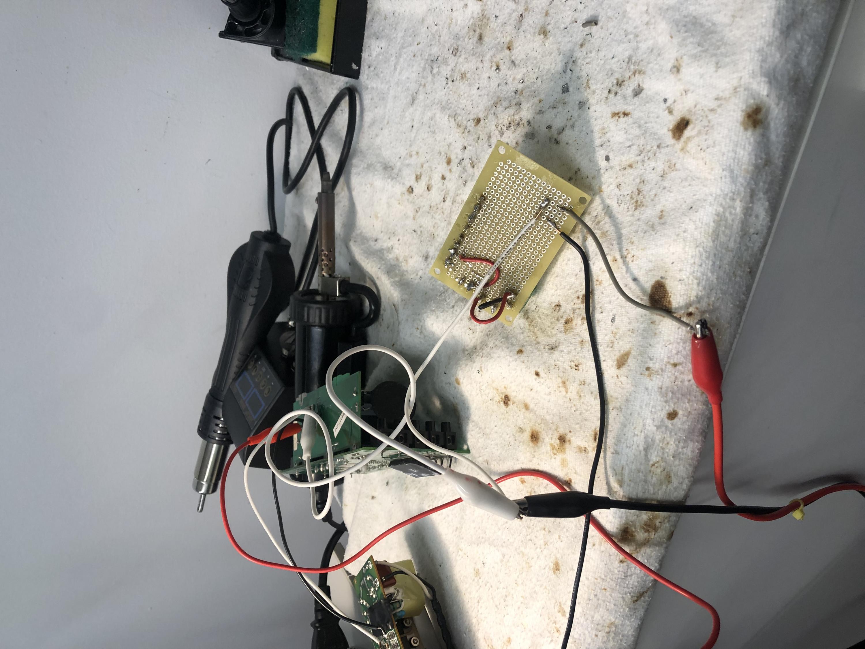

                                      Isolated the side panel and checked all optocouplers, all were found in good condition then I did another test. On my testing PCB I soldered a brand new TNY280PN. The source pins were connected directly to the negative rail and the drain one to the positive rail of the main cap then I got 1.6v between the source and enable pin. Why is that 36v on the psu's IC then? I'm still waiting for zener diode kit. Please find attached.

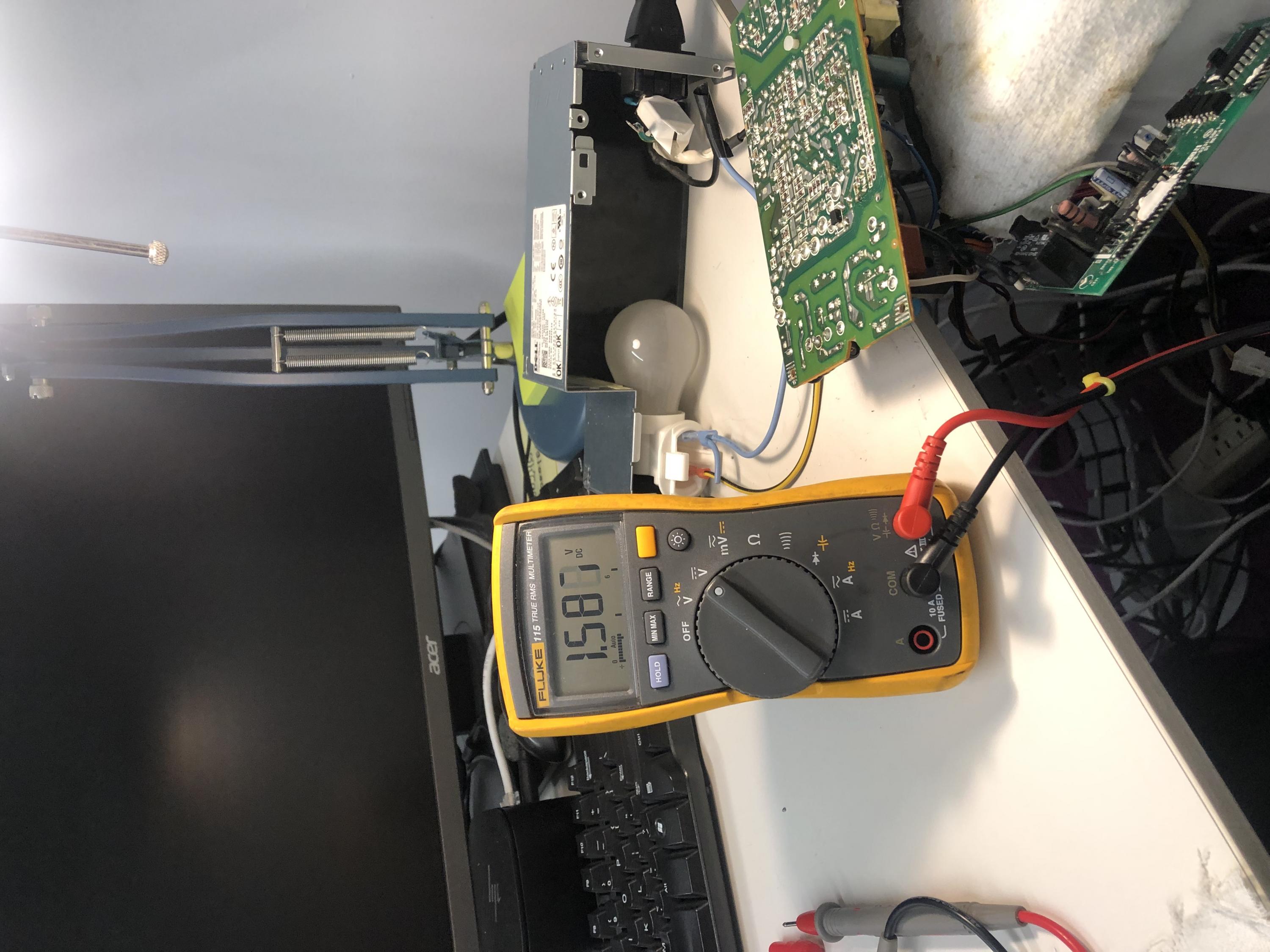

                                        Updates:: Replaced the existing IC from the pcb with a new one then I have measured 2.7v across the source and EN pin. Still have no switching but for sure there is some progress on it.
