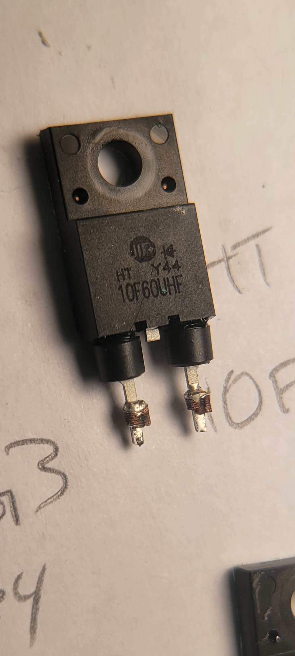

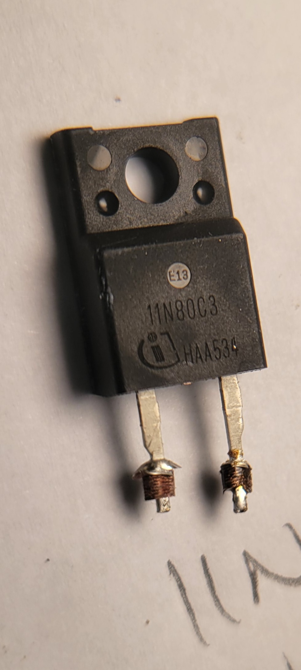

    Hi all. I am trying to locate a 2 pin (TO-220-2) 11N80C3. I can only find these in 3 pin packages. Are they no longer available in 2 pins?
    I am also looking for a 10F60UHF in the 3 PIN package. The one in the photo has a broken middle pin.
    Any help would be appreciated.
    Thanks,
    Al

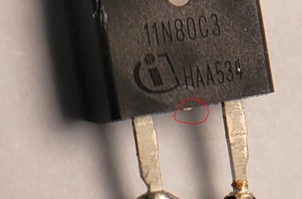

    Re: Are 11N80C3's available any more?
    How can a transistor 11N80C3 have two contacts, the middle leg is broken off.
    And 10F60UHF is a diode, it should have two contacts, not three.
      You also damaged the board by ripping out the feed thru's
        Thanks for the reply.
        If I replace the 11N80C3 with a 3 contact version, can I remove the middle leg myself and it will still work? That's the way it came out of the power supply.
        And a colleague of mine suggested I try a 10F60HF3 TO-220F to replace the 10F60UHF since we only saw the 2 contact UHF like you mentioned.
        • cooperus
          • Jun 2023
          • 4
          True...but there is still continuity on the traces. I may need to grind the holes a bit to get more solder in but the connections are good.
