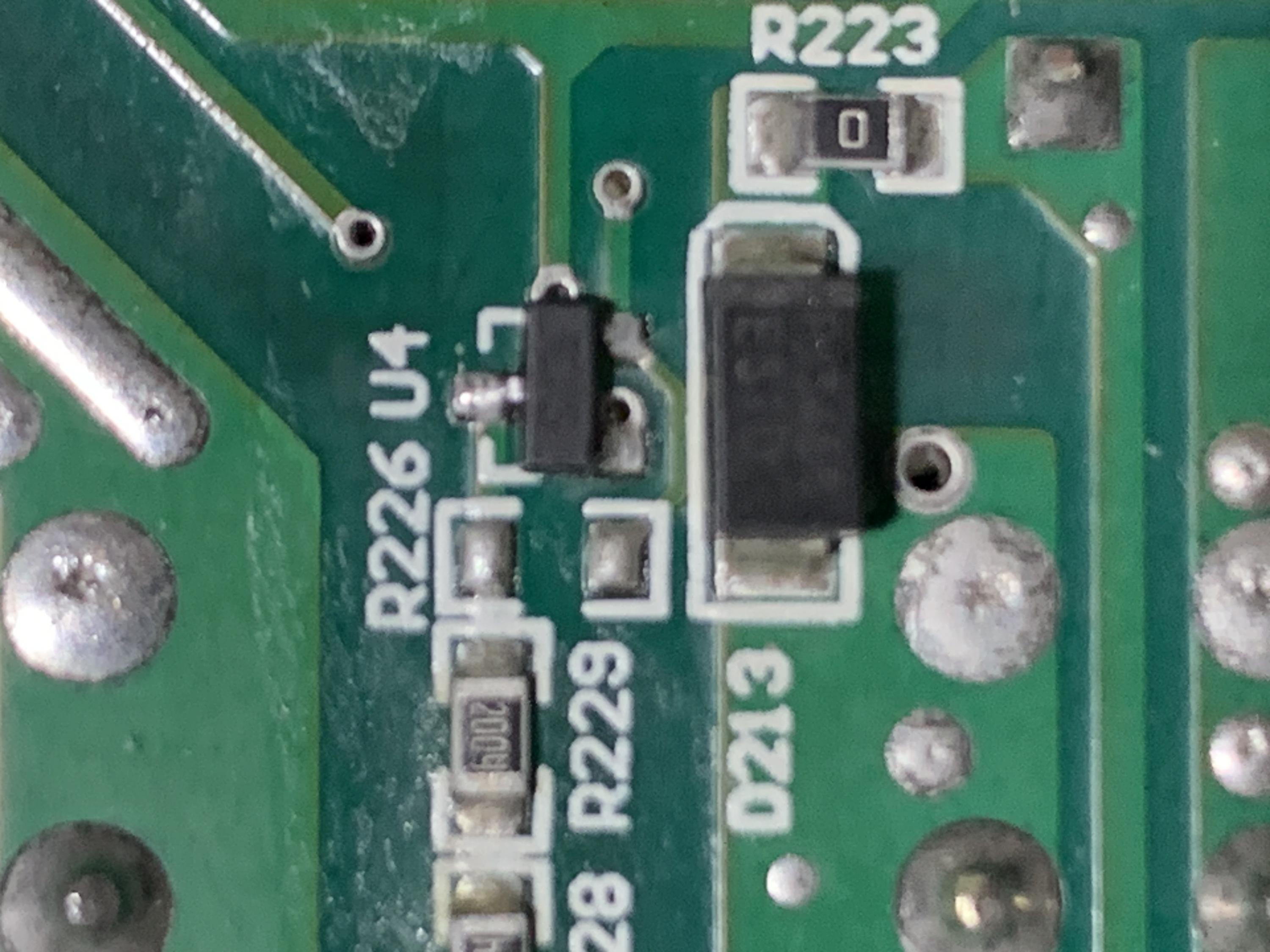

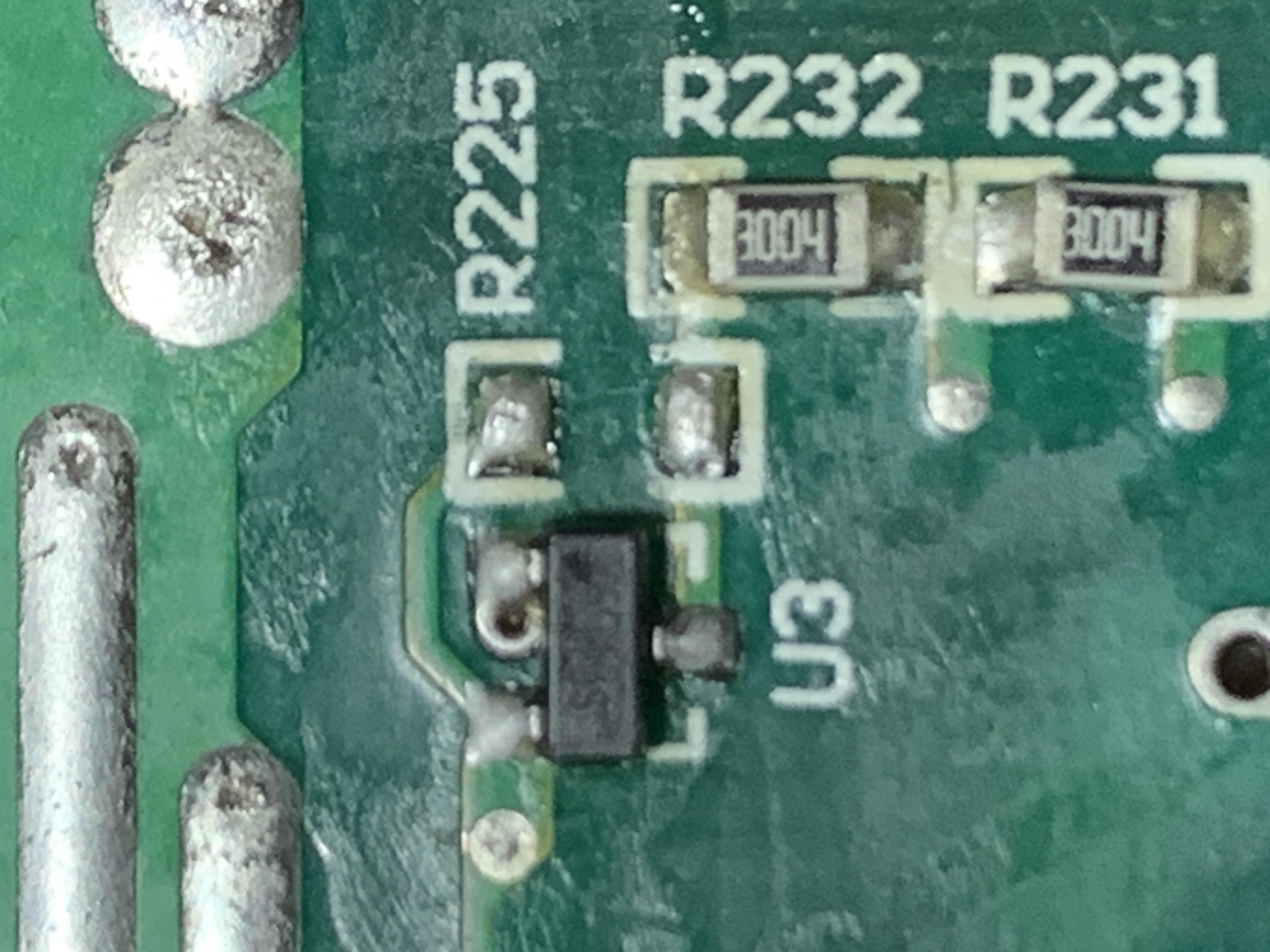

    Hello..
    I have CM V series that wont turn on...
    No voltage on +5VSB and PS_OM pin...
    The board layout exactly like in this thread
    https://www.badcaps.net/forum/showthread.php?p=908291
    after reading the thread above... I measure the voltage on those mosfet ( U3 and U4 )
    U4
    Drain pin : 200v, Gate 2,72V and nothing on S pin (0v).
    U3
    Drain pin : 170v, Gate 2,72V and nothing on S pin (0v).
    I assumes the voltage on Gate pin should turn the mosfet ON... (please correct me if i'm wrong)
    So i believe those two mosfet are bad...
    I have tried to find the compatible replacement, but I cant find with 600v Vdss
    I notice there is un populate resistor next to the mosfet, which i believe its function to "bypass" the mosfet
    on U4=R226
    on U3=R225
    So my question are, is it really bad mosfet ? if it is, can i just bypass it with placing a resisitor ? with what resistor value ?
    Thank you... Appreciate all your help and input....
