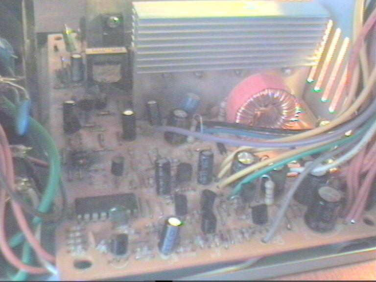

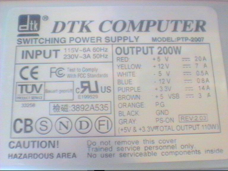

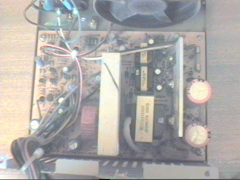

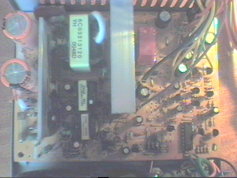

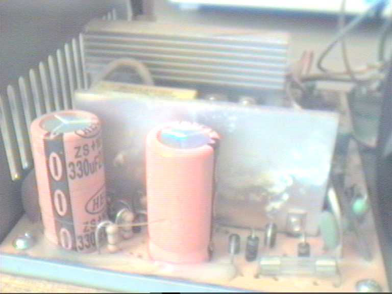

    200W is not the same as 200W
    See this crap marked as 200W - thin wires, small components and overall "empty" look.
  • Rainbow
    • Aug 2005
    • 1375

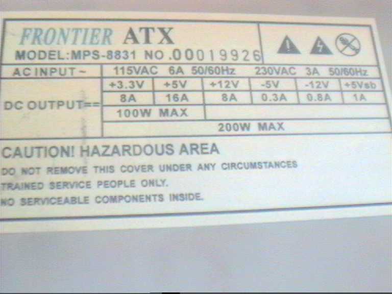

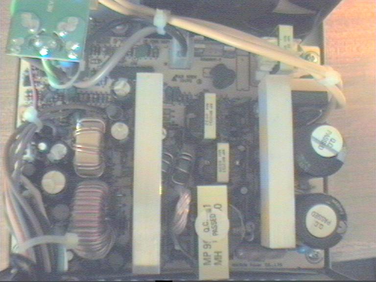

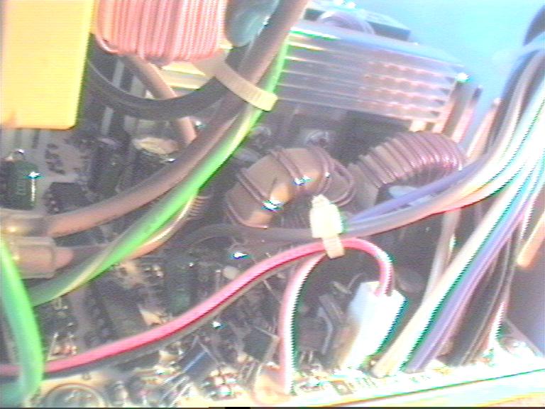

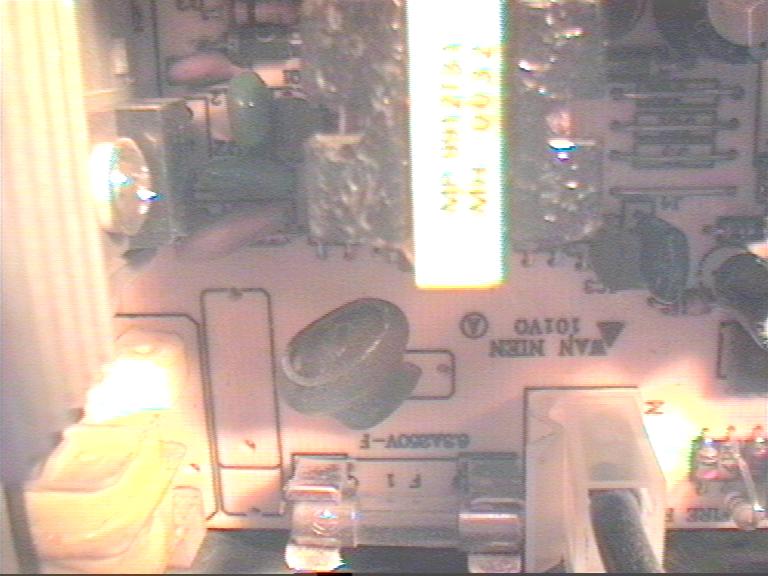

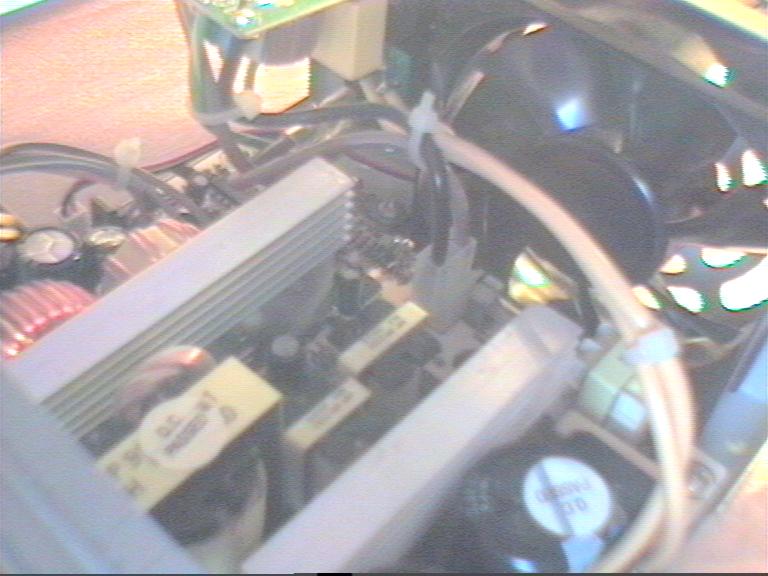

    Re: 200W is not the same as 200W
    And compare with this. Even the fuse is in fuse holder, not soldered to the PCB. The characteristic of these PSUs are non-standard wire colors (e.g. violet instead of orange for 3.3V).
      The first one is about 90W-150W max. (since the primary caps are 330uF, I'll concede that it may be at the high end of the range), while the second is real (possibly even under-rated). The general thumb rule that I use is that if there are two fair-sized toroids on the secondary and a few large caps (>=2200uF), it's probably correctly rated. If there's only one toroid and small capacitors (1000uF or lower), it's a fake rating. This crap started with the 200W AT PSUs.
        The first one reminds me of an old generic 250W ATX power supply I used to have in my secondary system. The board, two cheap heatsinks, and weak 80MM cooling fan were the same. The only thing that was different was that it had CapXon caps. That thing I used to have is now dead.

          My generic ‘300W' that I'm running this sys on is between the two. I'm kicking myself for getting rid of an ancient AT 250W DTK P/S because I could have used it for fan testing.
          The great capacitor showdown!

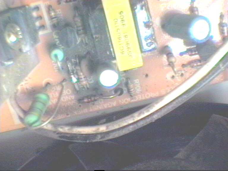

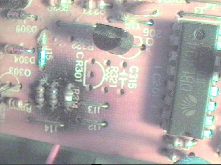

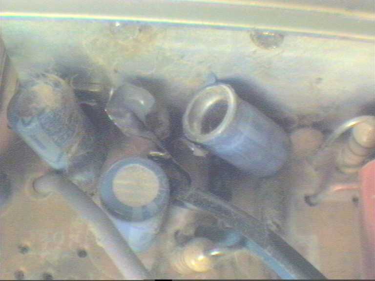

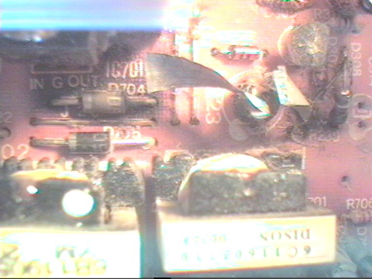

            This is the same crap as the first one except it's marked 230W. The failure is the same too. I don't repair crap like this - it's a good source of "C945" TO92 transistors (at least 8 in each) for other PSU repairs - they're used a lot by various PSU manufacturers.
            I remember that I found real manufacturer of these PSUs some time ago - and this type was marked as 160W or something like that - but I'm unable to find it again now.
                That thing has Jun Fu caps instead of HEC caps. But, both of them are crappy. I have the same crap in my basement too but it uses CapXon caps and is on the sticker says it's rated for 250W. When it was still alive I put it in an old ATX system that used a very old Pentium 133 processor and it made a loud high-pitched sound that I can't describe some more and the system always restarted and froze. I took that thing out and put in an old Delta 145W ATX PSU and then it worked perfectly. That tells me those things are total crap.

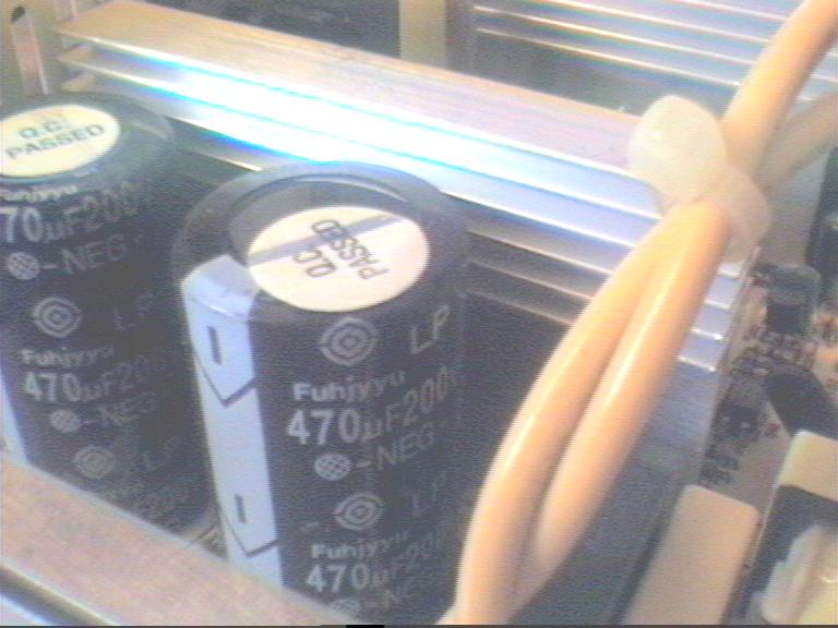

                    Here's a pic of a supposed 450W supply that I doubt would even come close before frying. The 2 large caps on the primary side are 470uf . Largest caps on secondary side are 2 1000uf 16v.
                      I'd estimate that it's about 150W-250W, max. From the description of the secondary caps, I'd guess it's at the low end of that range.

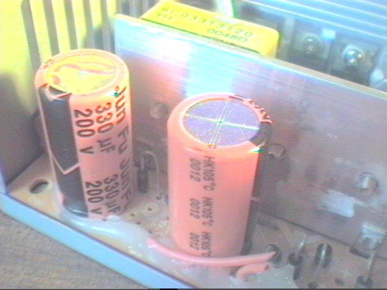

                            Thanks for advice, will toss it in (s)crap pile. What about sizing of caps. Make any difference on output of ps?
                              2x 330uF is used on cheap 200W PSUs - like the one in the first post. The higher power rating, the bigger capacitance should be used. For example, 300W DTK PTP-3007 (the same type as the 200W one in the second post but higher rating) has two 680uF caps on the primary side...
