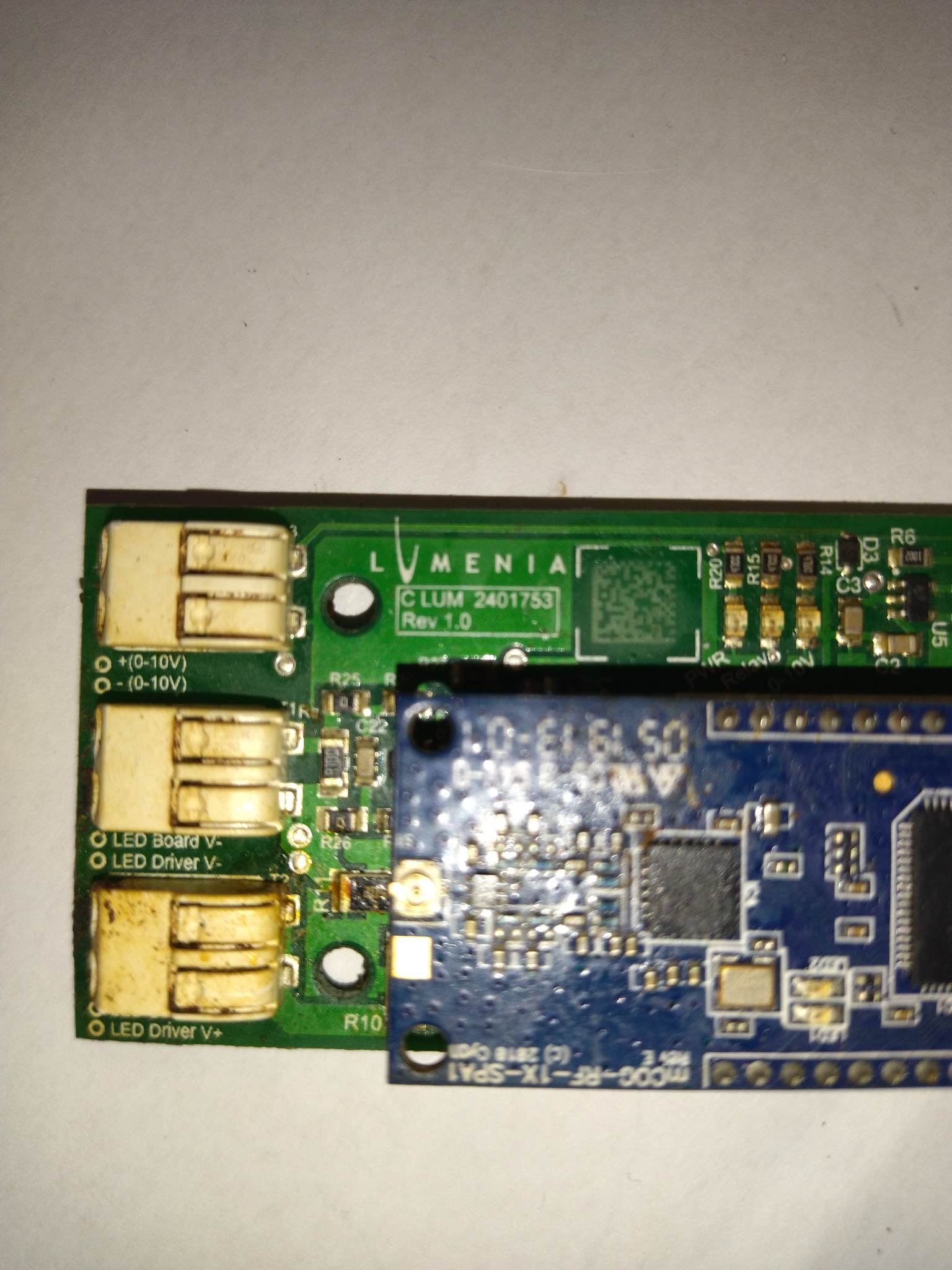

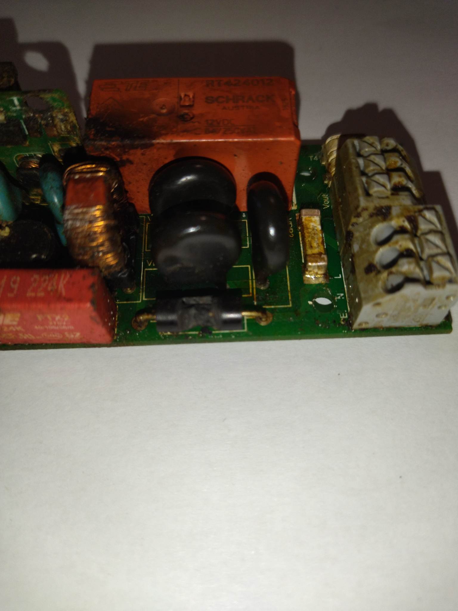

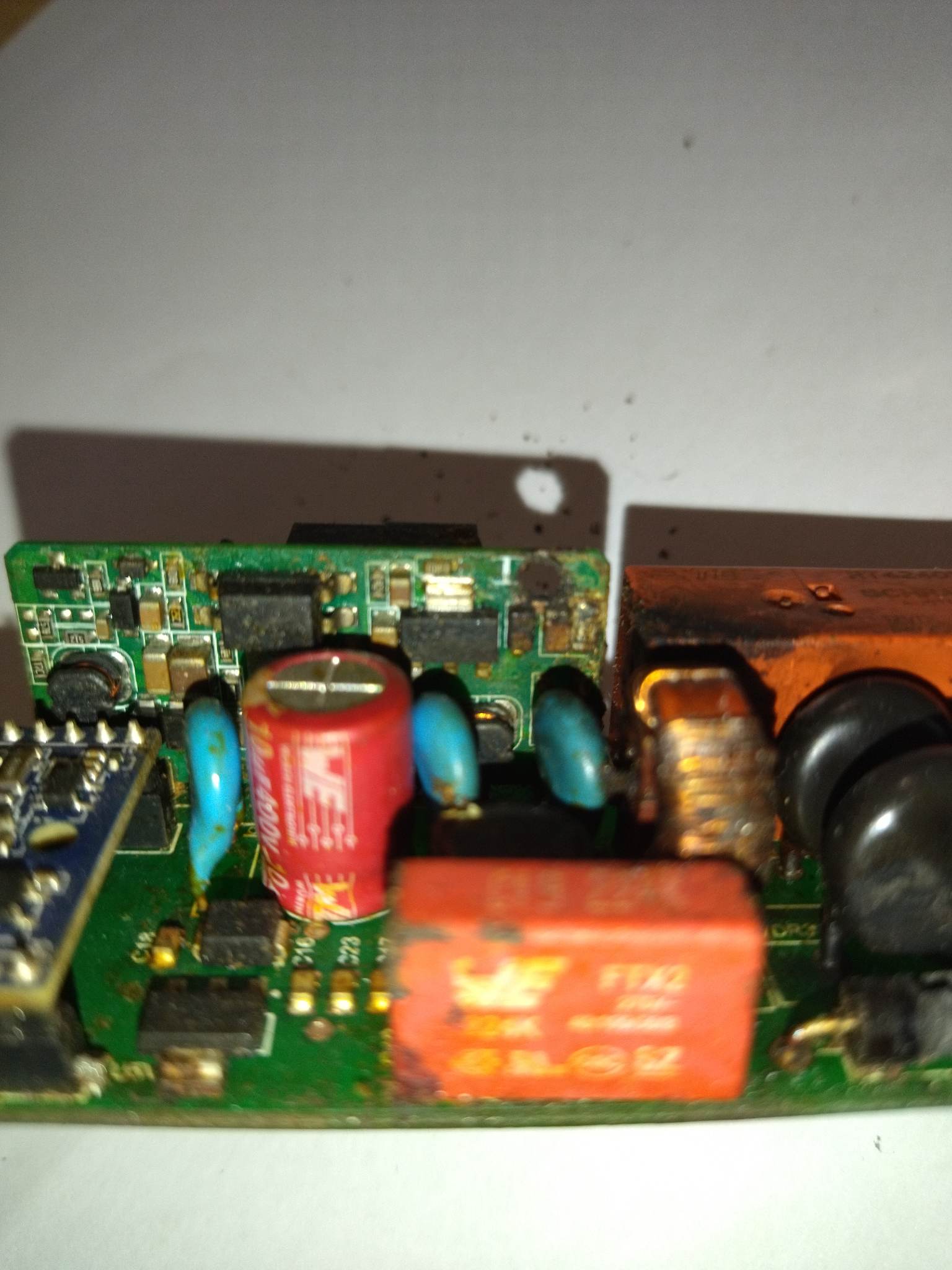

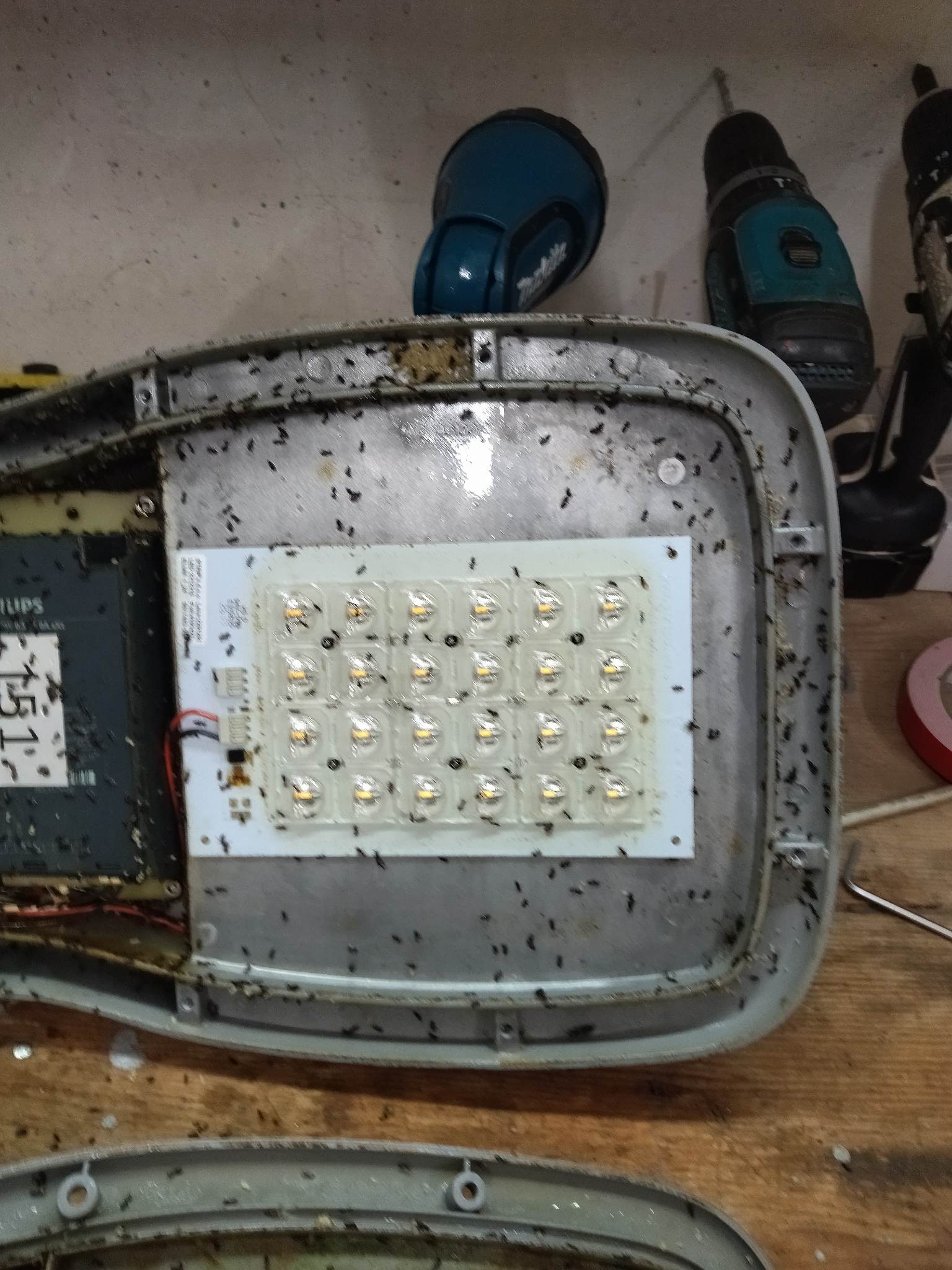

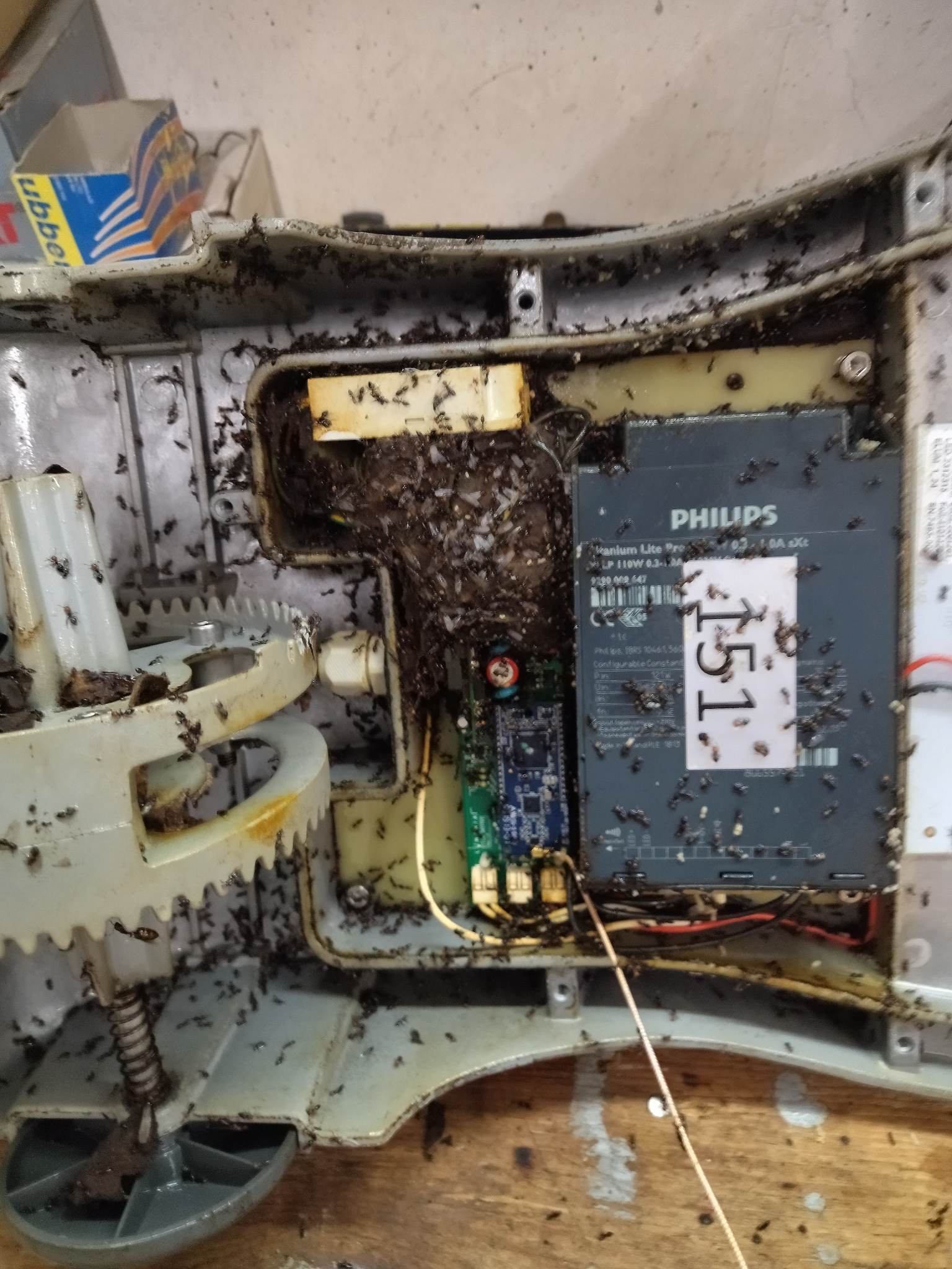

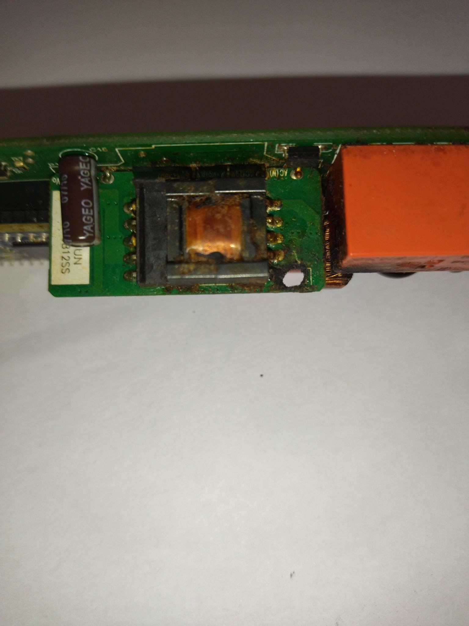

    Hello, I've got driver module of a LED street light lamp that had an ant colony inside and probably due to some ant organic fluid driver module shorted.
    Fuse is blown, one of the znr varistor is shorted and there is a burnt resistor from which I cant read the value.
    Does anyone by any chance has a schematics for this driver?
    Thank you

    whats the gray metal with philips written on it?
    the vertical pcb is a psu, it looks like the output voltage is marked on it maybe.
    why does it have a computer and a radio??????

      Re: Lumenia street light; LED power supply driver
      I think its the actual power supply for led and a pcb supplies voltage for RF controller and drives the actual power supply for led.
        I'd first soak the PCB in IPA (if the relay is sealed) to clean off all the fly shit. Use a toothbrush.
        The exploded part does not look like a resistor.
            It looks way overboard. A 68-pin MCU to control one string 24-LED streetlight? Plus RF transceiver and antenna.
            It must program people by blinking at the DNA frequency... the Mind Control Option now in your Lumenia street light.
            cog-rf-1x-spa1 might use STMicroelectronics SPIRIT1 RF Transceiver.
              The RF controller is obviously to communicate with spy balloons and offer remote control.
              The exploded part is marked R17 on pcb. You're right I'll first give it a good cleanup.
