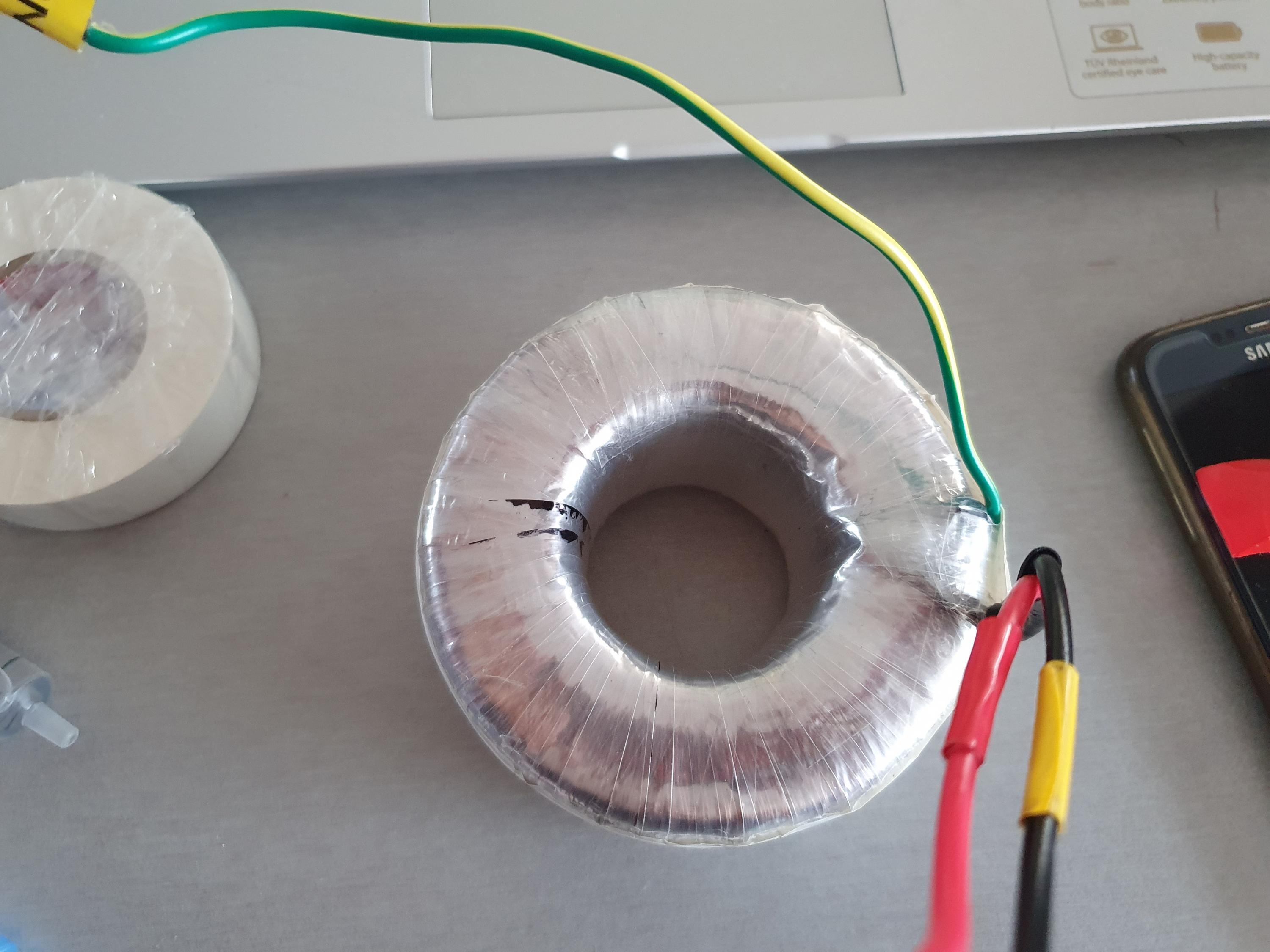

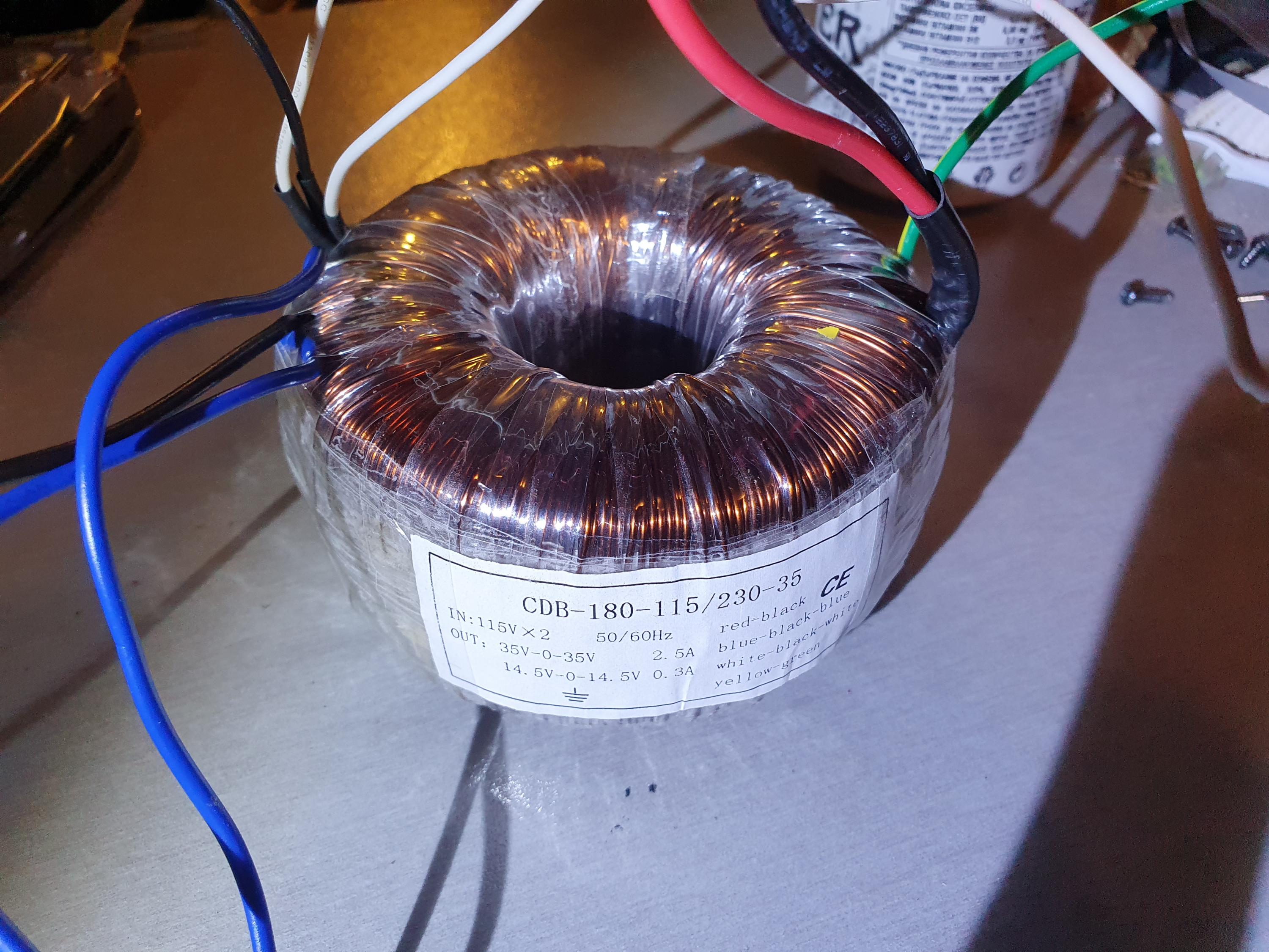

    Here I have an odd case (at least for me) of a toroidal power transformer that blows fuses even without any load on the secondary side.
    When powered through a current limiter, I measure no significant AC on the secondary side ( like 7-9V on the 35 output ).
    I've done the measures with a component tester..
    The switch on the primary side is for 110-220V and both inputs act as short when connected to mains.

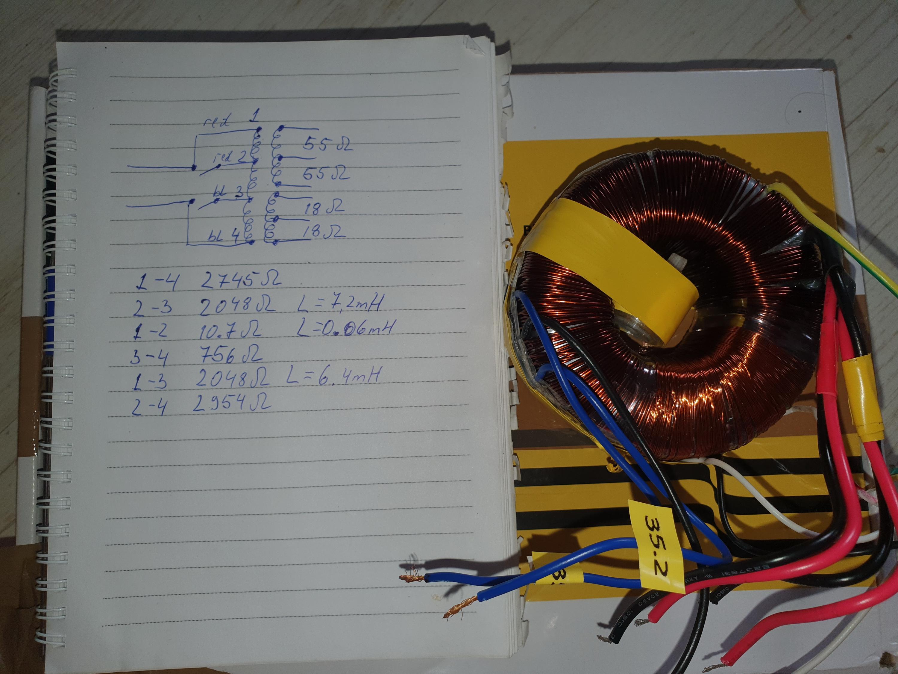

      Did that, the lamp lights up and on the "kill a watt" I see the full lamp wattage. Meanwhile on the secondary side of the transformer the voltages are way too low ( 9v-ish instead of 35 ).
      What is confusing me is that between any red and black input I measure at least 2k Ohms, which seems to be normal(?) transformer input value.
      If it was dead short or open I would have already scrapped or rewinding it (depends on how hard is to find), but now I'm just baffled.
      p.s. The only bad readings are between the red cables ( the extension coil for the 110/220V), but still does not explain why it shorts with the black inputs.
      p.s.2 Alright, just got an idea - it is sparking (and can't be seen on the tungsten lamp because it is not that sensitive to such interruptions)! So now have to figure out how to find the spark (if any) before trying to rewind it.

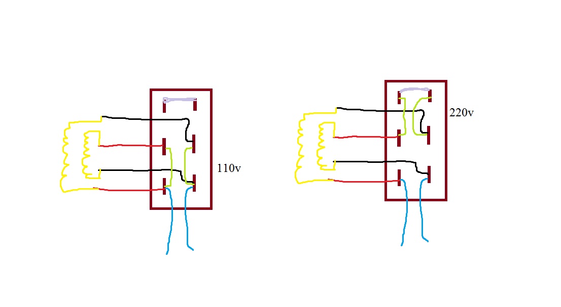

          The diagram with the switches does not look correct, you can't short a winding with a switch. What is the transformer from?
          The transformed is from an audio amplifier (carlsbro orion active speaker) and this is the way it has been designed. I guess when the switch shorts the extended coils it works like bypass (just a guess, never really have been interested in transformer designs and construction).
          I will post a photo of the switch.. just have to find it.

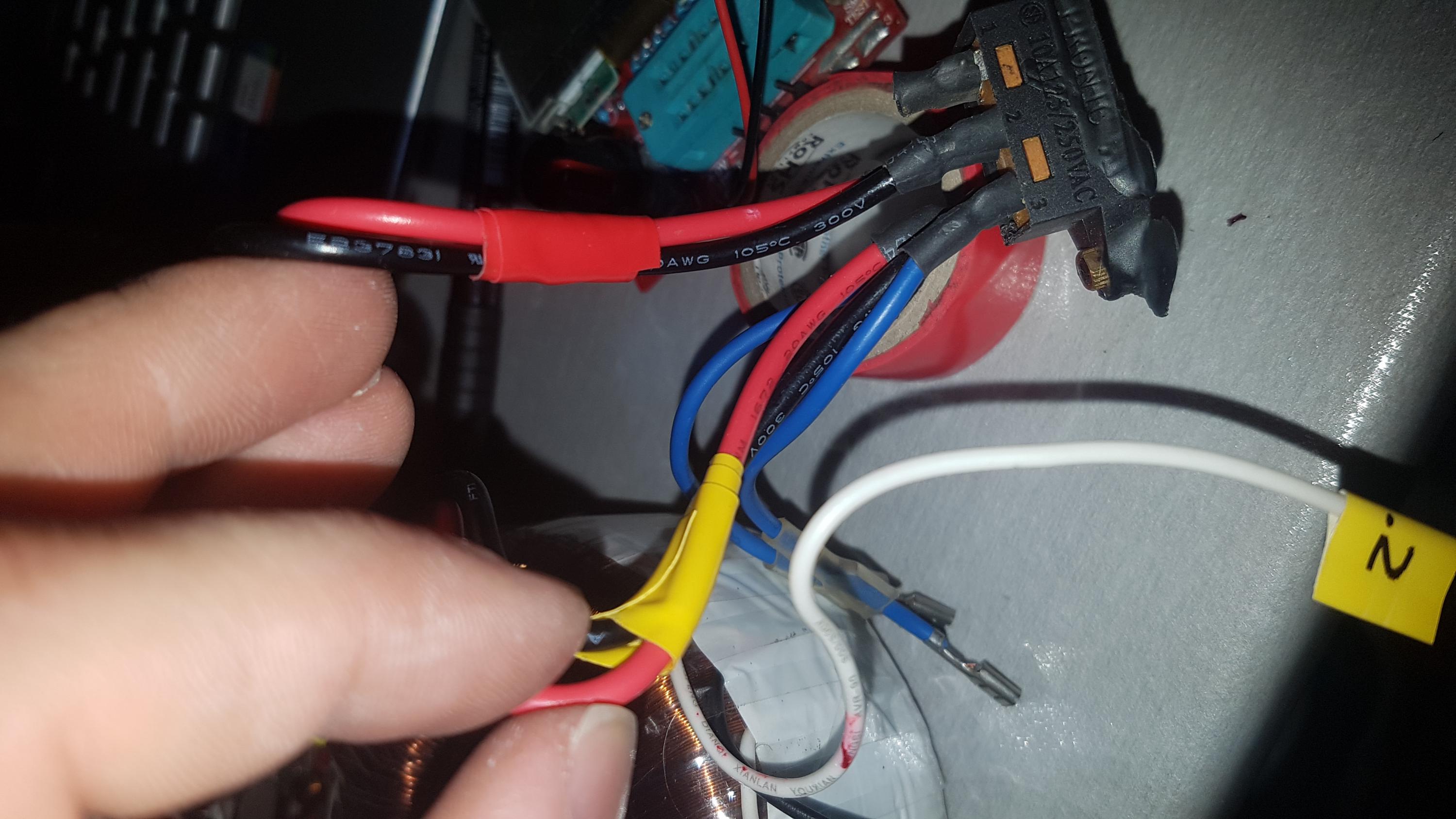

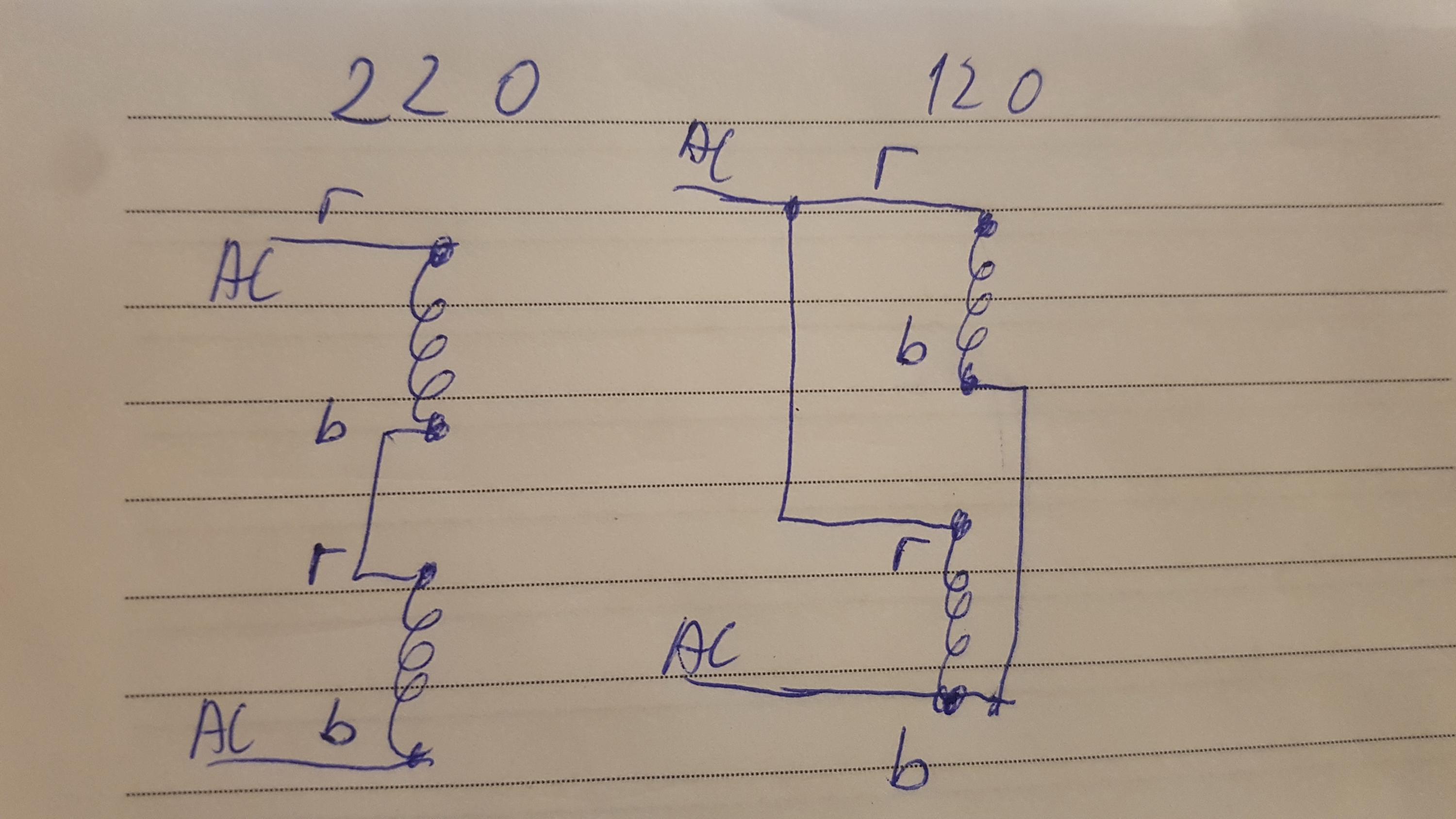

          p.s. Here is a photo. The blue cables come from the mains, the most right switch connectors are not used... but, now I noticed that indeed they are shorted under the heatshrink.
          This means that when 220V is selected, the middle red and blue cables are shorted.
          p.s.2 And just to confirm - when 120V is selected, both red wires and both black wires are shorted to each other and to the mains(blue wires). The switch solderjob and heatshrinks seem original.

            Re: What's wrong with my transformer?
            The transformer only has two primary windings, they should be separate, I suspect you have a short between the windings.
            In the 110v position, black and red of the two windings are in parallel, in 220v position the two windings are in series
              Huh, 2 coils totally makes sense.
              Here is what I get if each red-black is a separate coil.
              p.s.
              Still, the lowest Ohm readings that I get between the possible input wires is over 2k.
              Well, I guess a transformer surgery will have to tell the full story.. and I hope it will not be an autopsy .
                I would guess a primary dc resistance of between 5Ω ~ 30Ω per winding

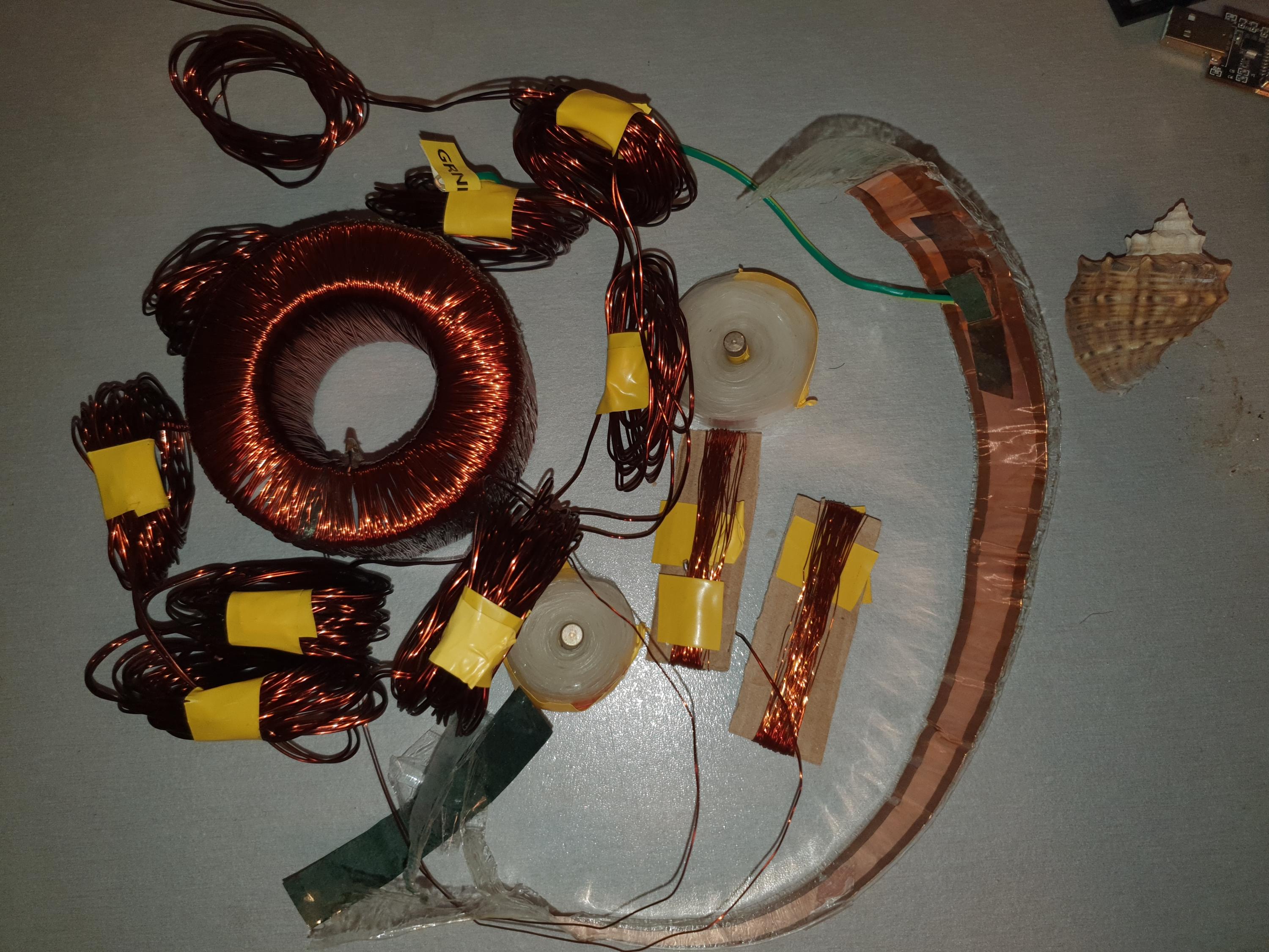

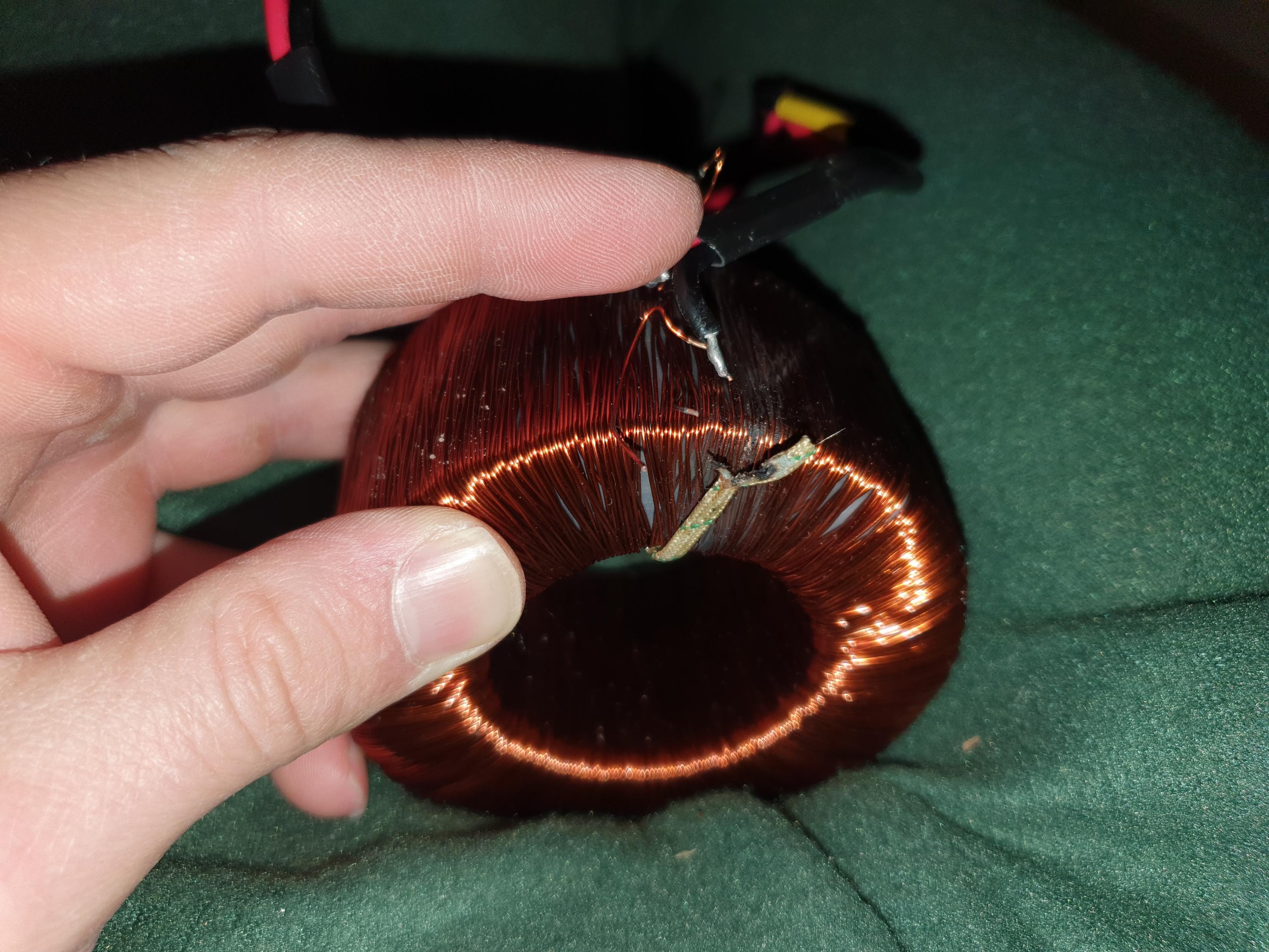

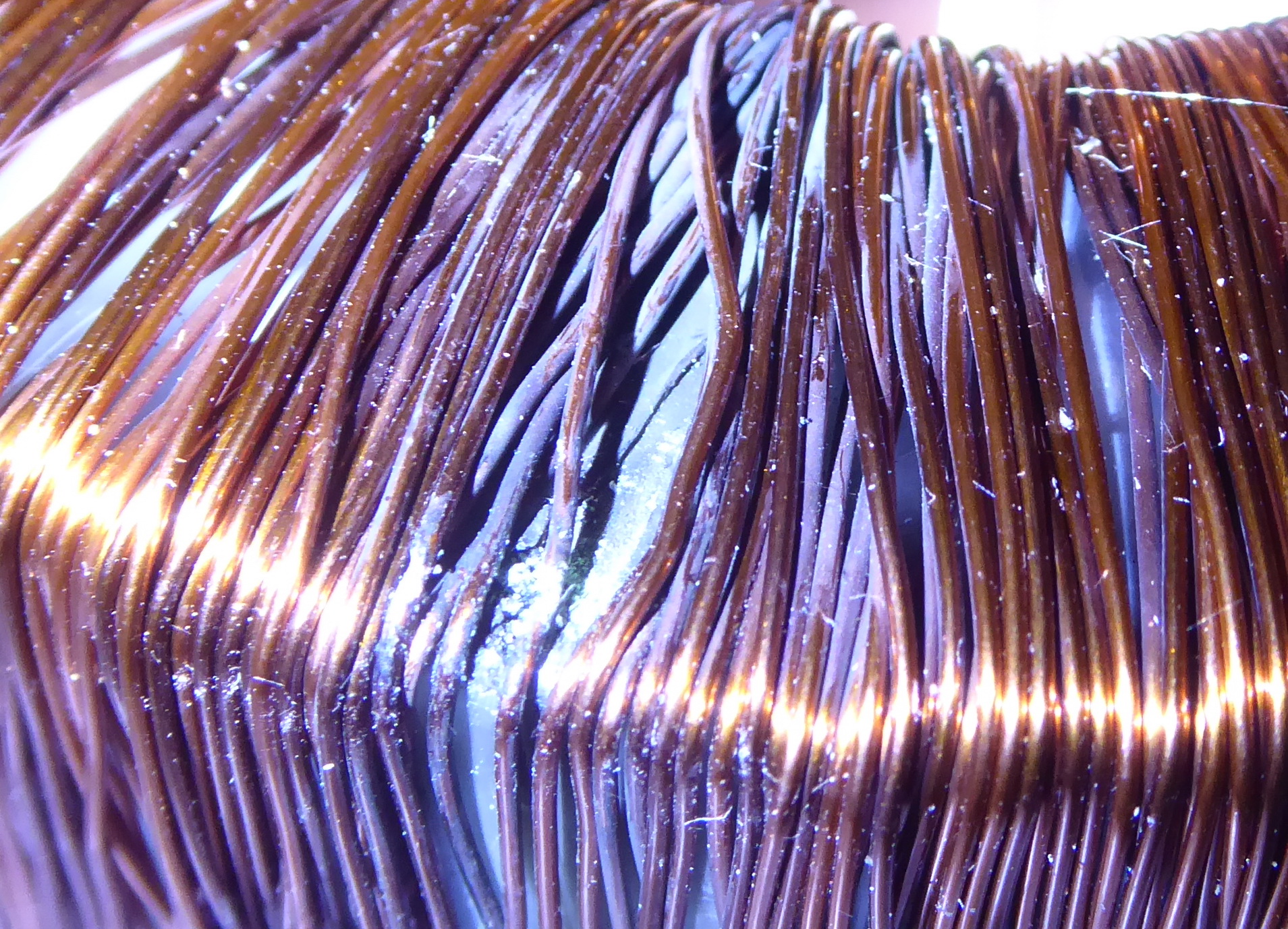

                        So after several hours of unwinding, finally reached the primary side... and voila - a short right on the black wires input. Unfortunately it had affected the windings beneath and of course - the affected spot is right at the other end of the coil and to reach it have to unwind the whole coil. After some cleaning found two significantly affected wires and after insolating them with some heatshrink, the short disappeared. The following days gonna test it with 220V and if it doesn't fail, I might try rewinding it.
                        Originally posted by harp
                        When you connect together two or more windings of transformer, the orientation of windings is crucial to operate properly.
                        Yep, totally makes sense considering the magnetic polarity depends on the current direction.. still, trap for those who do not pay enough attention. By the way, what gonna happen if the orientation is reversed?
                        i guess you need a insulation to check insulation breakdown under HV or ring tester, but i am sure the input of the transformer is shorted. Only because you can't measure a direct short with you low voltage DMM, doesn't mean nothing for higher voltage if the insulation is compromised and able to arc over.
                        Yep, lot's of carbon on the burnt place and no direct copper to copper connection. No way a 9v multimeter could get short there.

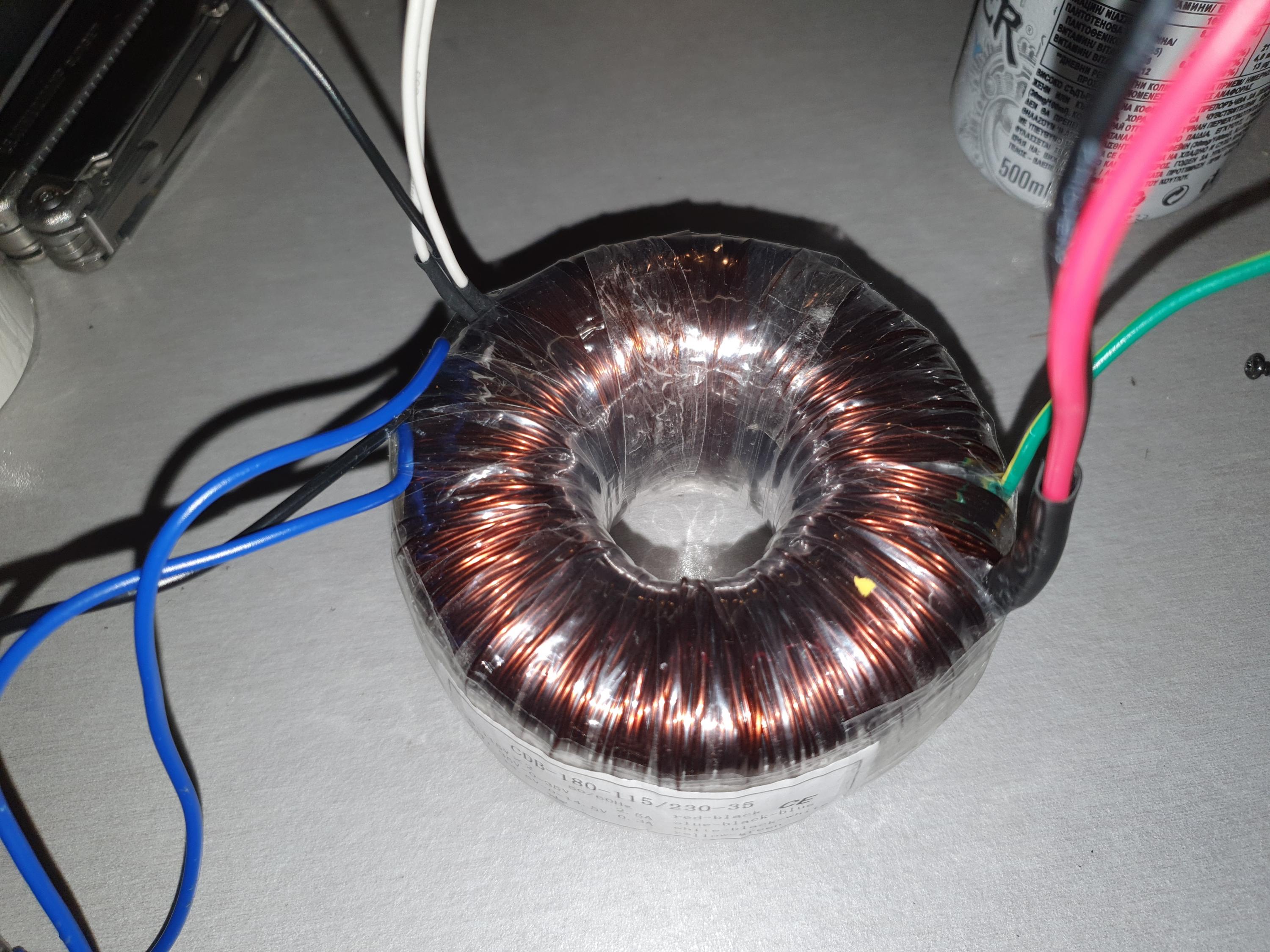

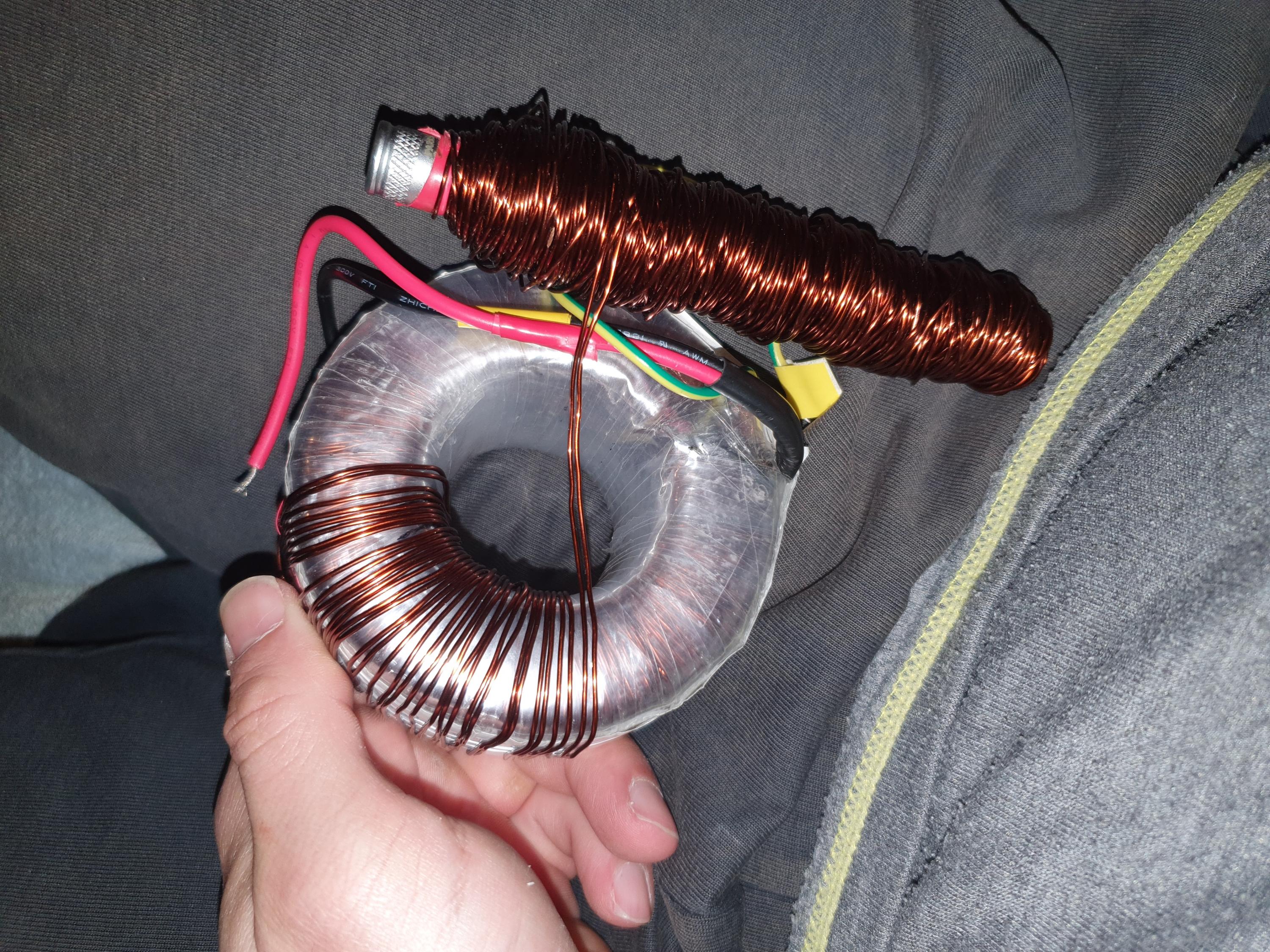

                            Well, a total of 10 hours of unwinding/winding later I have sore fingers and a working transformer.
                            Not the prettiest one, but still - working with well balanced voltages. Indeed I was really surprised how balanced ended the voltages on the secondary side - both 35 and 14.5 have less than 0.05VAC difference even though I had to cut some wire on both.
                            I also found out what happens when the secondary side is shorted.. good thing all tests were done through a lamp.
                            BTW, I use a carton tube of toilet wc paper for holding bunch of wire, it is show handy to me, and very available
                            Not applicable here - the carton tube is too thin and also too large to pass through the toroid hole.
