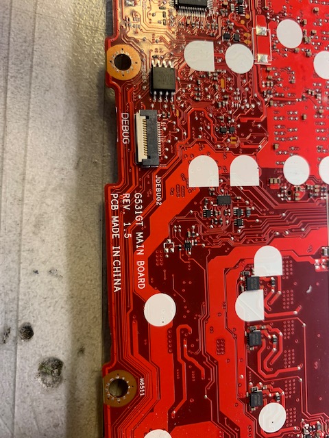

    ASUS motherboard G531 GT rev 1.5

    Re: ASUS motherboard G531 GT rev 1.5
    Perhaps anyone has a more "general" ASUS ROG schematic so I can try to investigate the typical charging and system power bus topology used. Thanks!
          does anyone have a boardview?
          Comment for future searches to find this thread: G731 mainboard is the same as G531 mainboard.

            I am the OP of this thread and the pc has worked perfectly for over one year. Yesterday suddenly during operation it just died and when probing for shorts it seems the core buck is shorted, so my question is if you believe there are more common for caps shortage or just a CPU failure?

              Found a shorted ceramic once again. PC back in business.
