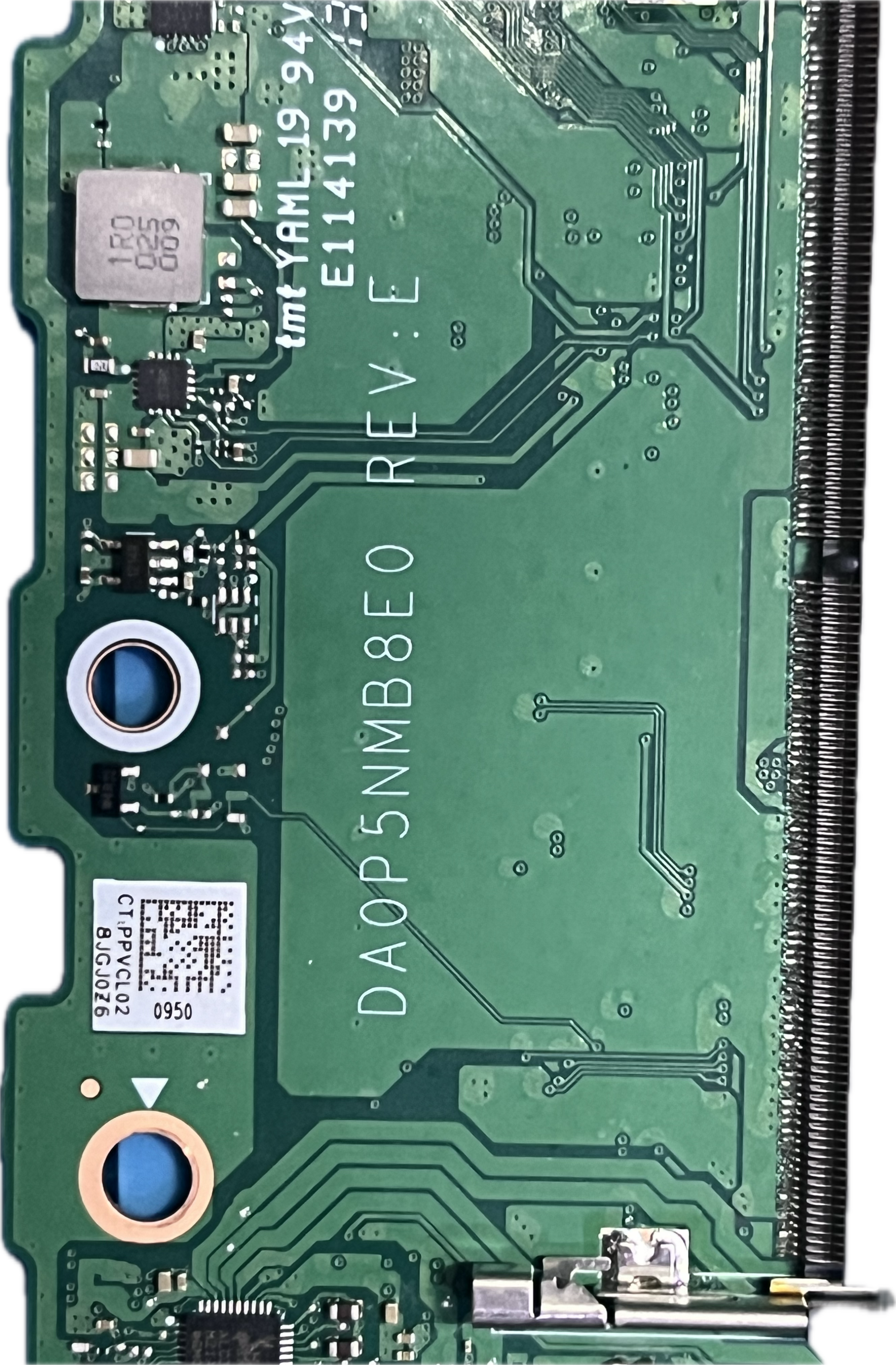

                      #50
                      In laptop (da0p5nmb8e0 rev e) and info on the three MOSFET near cpu marked AT00 3NCR? Two giving 0.8v and one giving mV. And laptop keeps restarting.
                        • 21679
                        #51
                        AT00 AOZ5016QI https://www.badcaps.net/forum/troubl...41#post1538441
