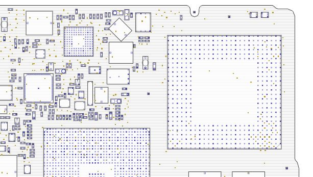

    I'm trying to troubleshoot a 'dead' Macbook Pro 2010.
    The logic board is 820-2879B
    Thanks to everybody who have uploaded schematics and .brd files here - it's a fantastic resource and a great help to me.
    However, the .brd file that I've found here seems to be for a different version of the 820-2879 board as the component layout is different in a few areas.
    Does anybody have a .brd file for the 820-2879B logic board?
    It would be a big help.

    Re: MBP 820-2879B Board view vs actual board

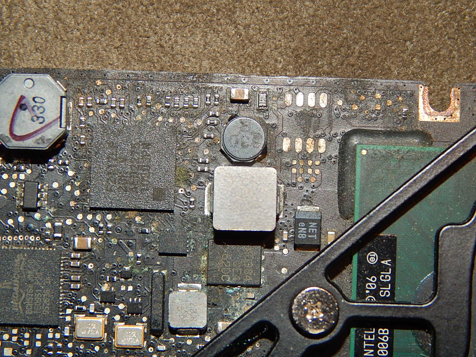

    Is the pictures supposed to show any differences? I don't see any… But I see slight liquid damage.

      harly "slight", that's a mess!

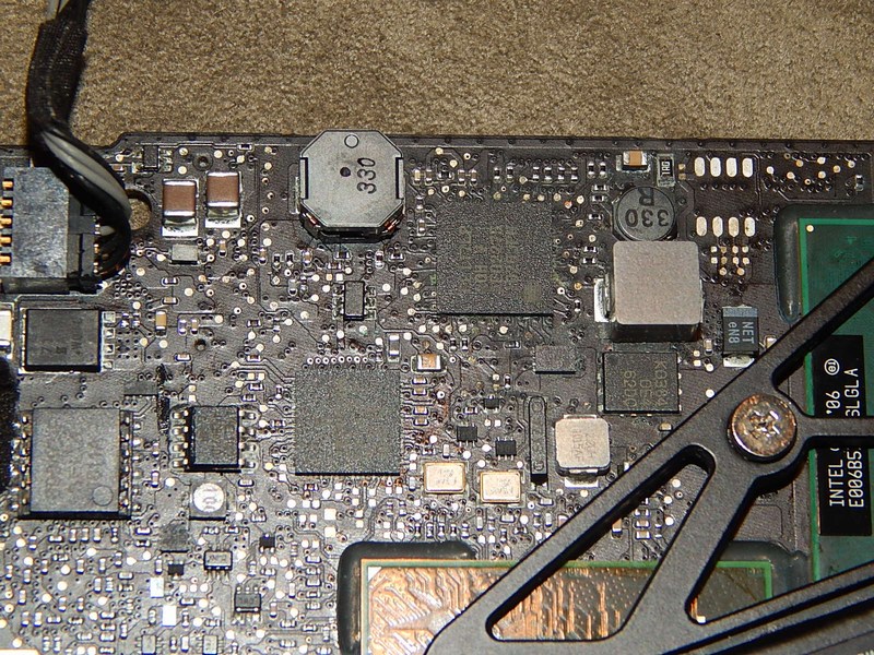

        I know there's a lot of dirt - probably from a liquid spill- but I'm trying to figure out the exact cause of the failure.
        I doubt that just cleaning the board will solve the problem, but it's on my list of things to do. I need to remove the speaker and heatsink first.
        Perhaps these pics will help show some differences:

          Yes, it does look bad when magnified.
          I have seen 'bad looking' electronic boards working, and 'good looking' boards that don't work!
          What's the best way to clean a board like this?
          I don't have an ultrasonic machine.

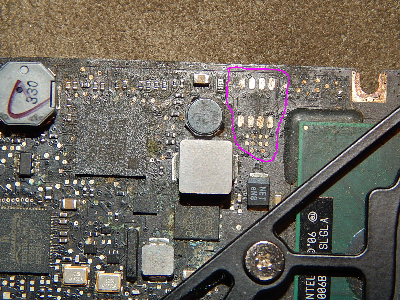

              Cleaned the board well with distilled water and then 99% isopropyl alcohol and dried it.
              It looks a lot better but still doesn't work, so I'm continuing with the troubleshooting.
              I'll grab a pic of the clean board later today and post it here, just to show some improvement in 'looks'. It's also a lot easier to measure voltages and resistances when the components are clean, so I should have cleaned it as a first step.
              The troubleshooting would be easier with an accurate .brd file, though, so if anybody has one, I'd really appreciate it.....
              • Mackayak
                • Sep 2018
                • 9
                A bit cleaner now....

                  The boardview file is accurate, I'm not sure what you're looking for…
                  If you state the problem maybe we can help you.
                  I see a bit of corrosion around R6905 so there may be an issue on PP3V42_G3H creation, several corroded vias on U3900 but as long as it's not shorted, it'll only cause no Ethernet. Before cleaning there was green stuff around Q7620. The SMC being right in that area, it may have crap under it as well.
                  Well, that's only for this area, we don't know what the rest of the board looks like, but those can already cause various different issues.

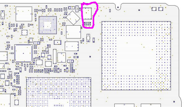

                      This isn't immediately relevant, but I figured I'd clear this up for future reference
                      The fact that the boardview shows that there are "components" there does not necessarily mean that there will be components on the board. If the schematics shows something there, it guarantees that there will be solder pads, but not necessarily components. If you see a spot on the board where the boardview says there is a component but there isn't on your board, look up the part # (in this case U5101) in the schematic PDF. When I pulled it up, that circuit is titled EFI Debug ROM, which is not a circuit that would exist on a retail model. Also, an easier way to tell, if a component says "NO STUFF" (like R5102 & R5104), that means, without a doubt, you will only see bare solder pads on a retail board.
