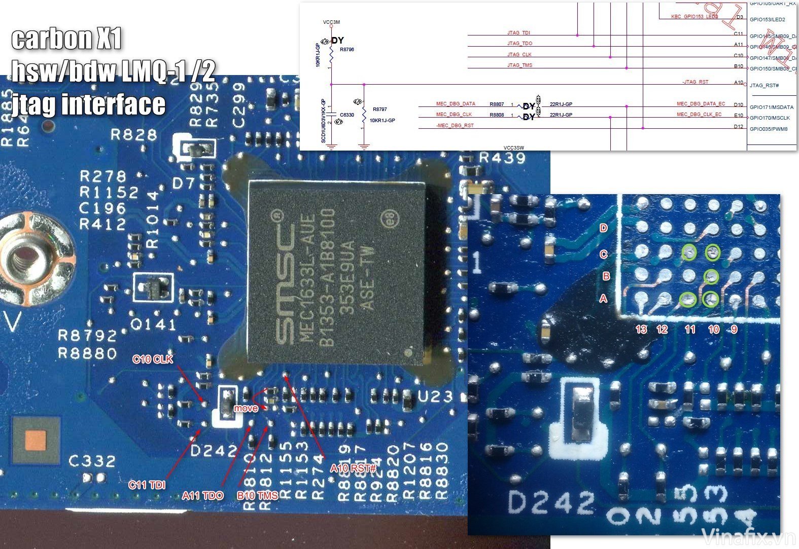

                  Re: Lenovo Carbon X1 12298-2 LMQ-1 48.4LY06 Boardview/Schem?
                  i have managed to solve part of the mistery.
                  in my case as a result of the initial defect(still unknown) the bios chip is bad; you canot detect it you just replace it and you put a known good chip; no not a bought one; use one from a donor board but i repeat; you have to be sure it is good(best way, test it on a functional laptop)
                  You read the contents of the original chip, do a clean ME on the dump and write it on the good chip.
                  Now the laptop should start up, and enter bios, problem is that only now you can see the initial problem that caused the bios chip to go bad: after you exit bios the laptop will go into a restart loop like many of you describe.
                  You cut power; leave it for 2 minutes and the laptop again powers on and the problem repeats; after you exit bios; it will restart over and over

                              Hi to everyone, I'm sorry to revive an old thread but I wanted to thank piernov for the schematic!
                              I'm currently working on a Mystique-2 LMQ-2 13268-1 board which is very similar to Mystique-1 LMQ-1 12298-2 .
                              My board gave freezes after windows loading but also in bios section if RAM area was touched/pressed, then I heated U74 area and system started correctly, then I reballed U74 (very delicate work cause of that dam black glue) and now system doesn't startup anymore
                              Not 100% sure about U74 life but I probed every ball to its Vss before soldering and every pin gave compatible measurings in respect to the pin function, so no shorts and no NC ones...
                              I soldered a POST card to J7 pins but it gives only 00 and the reset signal, so it seems that it's a CPU problem (all CPU voltages are up and correct)...
                              I'd like to shift R58 or R1806 (MEMORYID4) to logic 0 so the board will use 4GB instead of 8GB, but I can't find it on the board because not every smd is written on the board.
                              Please anyone, do you have a boardview for this LMQ-2 13268-1 or even LMQ-1 12298-2 board?
