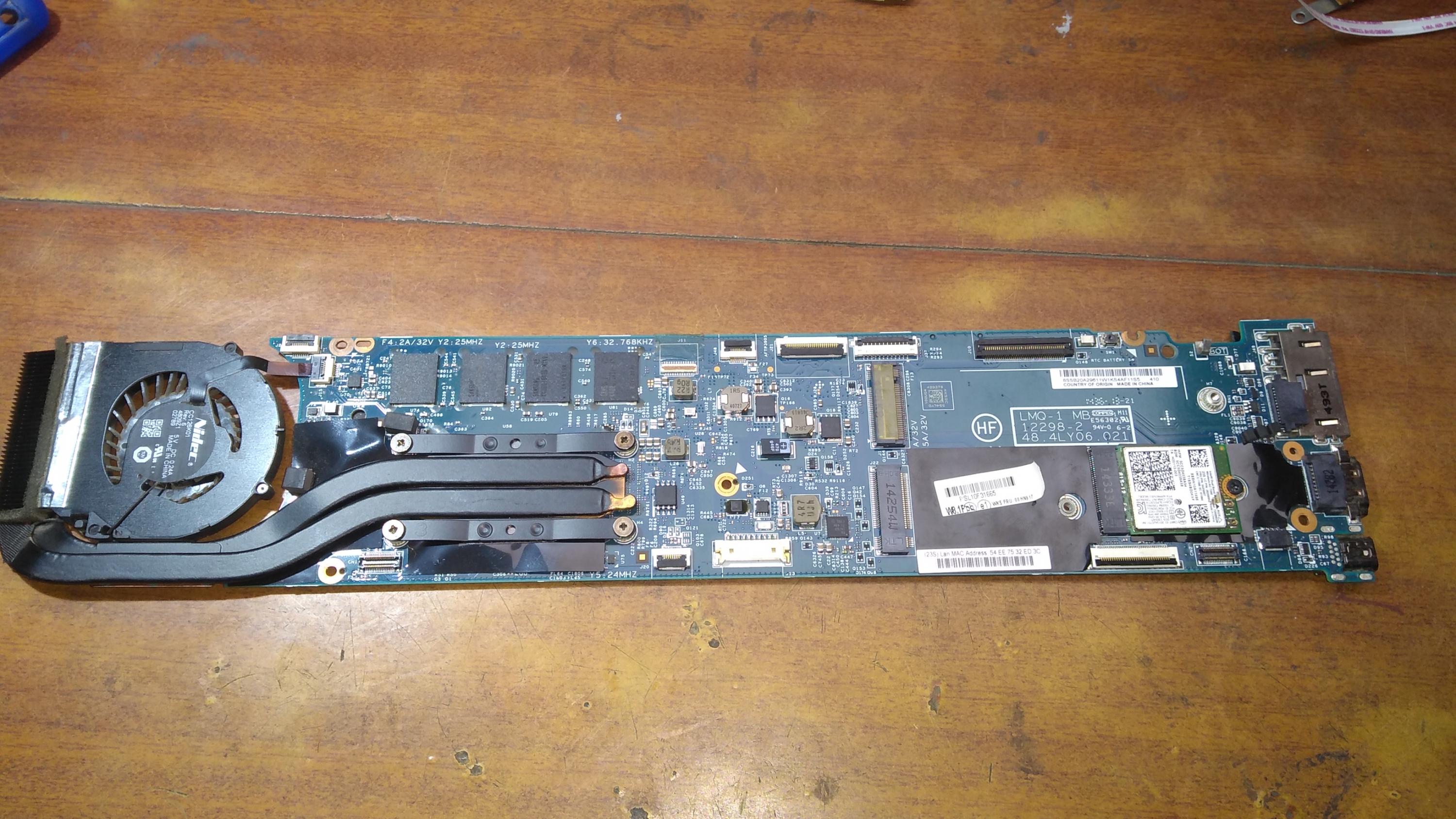

      Lenovo Carbon X1 12298-2 LMQ-1 48.4LY06 Boardview/Schem?
      Looking for boardview/schematic for the X1 12298-2.
      Currently is trying to boot, keyboard lights up for a second or two, touch-bar is active and responding, completely black screen, no energizing.
      Fan will spin up for about 3 seconds, then stop for another 15~20 before spinning up again indefinitely.

        Re: Lenovo Carbon X1 12298-2 LMQ-1 48.4LY06 Boardview/Schem?
        Check if cpu responds to heating. Schematics i have not seen. Try another bios if no response to heating.
          I made a copy of the BIOS (16M) compared it to another one, a reasonable level of similarities, so I have my doubts the BIOS is at fault explicitly; though it might be the data line pullups, clock gen issue, or bad cap not getting voltage up high enough on one of the rails, all could respond to heating.
            BIOS corruption can happen on one bit and be sufficient for the computer not to boot. Also sometimes an external programmer will read the chip properly, but while booting the computer cannot. You should still try to flash it. Some "bad" EEPROM may work under specific thermal condition.
            Also check if you have PLT_RST# on the mini PCIe port. (or M.2, dunno what's in there)
              This bios is from working machine, windows serial nr removed.
              CPU heating i meant that these mainboards might respond to heat like AMD chips. Worth to try before trying to waste time on deep diagnostics.
                I'll give it a try later. If that one does work, what's the offset to set the Windows serial?
                  Just noticed, your chip is the MX25L12805, mine is the 12873E, I imagine that's not going to matter, but thought I'd make note of it.
                    EEF175h
                      Tried the new bios, no change.
                        If you find similar schematic with the same EC then maybe attach a post card to LPC and check if it gives some information. Memory and cpu are next in line for suscpects. Neither are good if i remember correctly this mainboard has nasty underfill under both. How much amperage is drawn?

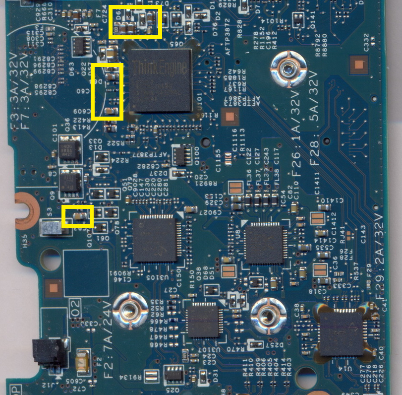

                            Same problem Turning on Fan spin for a few seconds and shutting off and repeating the same steps.
                            Anyone find the Schematics?
                            Also can a capacitor have 2 different voltages?
                            Or is this part even a capacitor? Looks like a ceramic cap to me.
                            When tested with multi-meter
                            It may not have a side going to ground and some of these get 2 different voltages on each side. Especially bottom left.
                            Voltage: Tested with power plugged into board. One side lead on ground other on each each side of suspected caps.
                            The Ceramic caps in question are coming from the ThinkEngine Chip
                            I think 3 of them did not have a side going to ground. The labeled boxes are not the exact caps. The photos is not of the exact board in question and photo found online.
