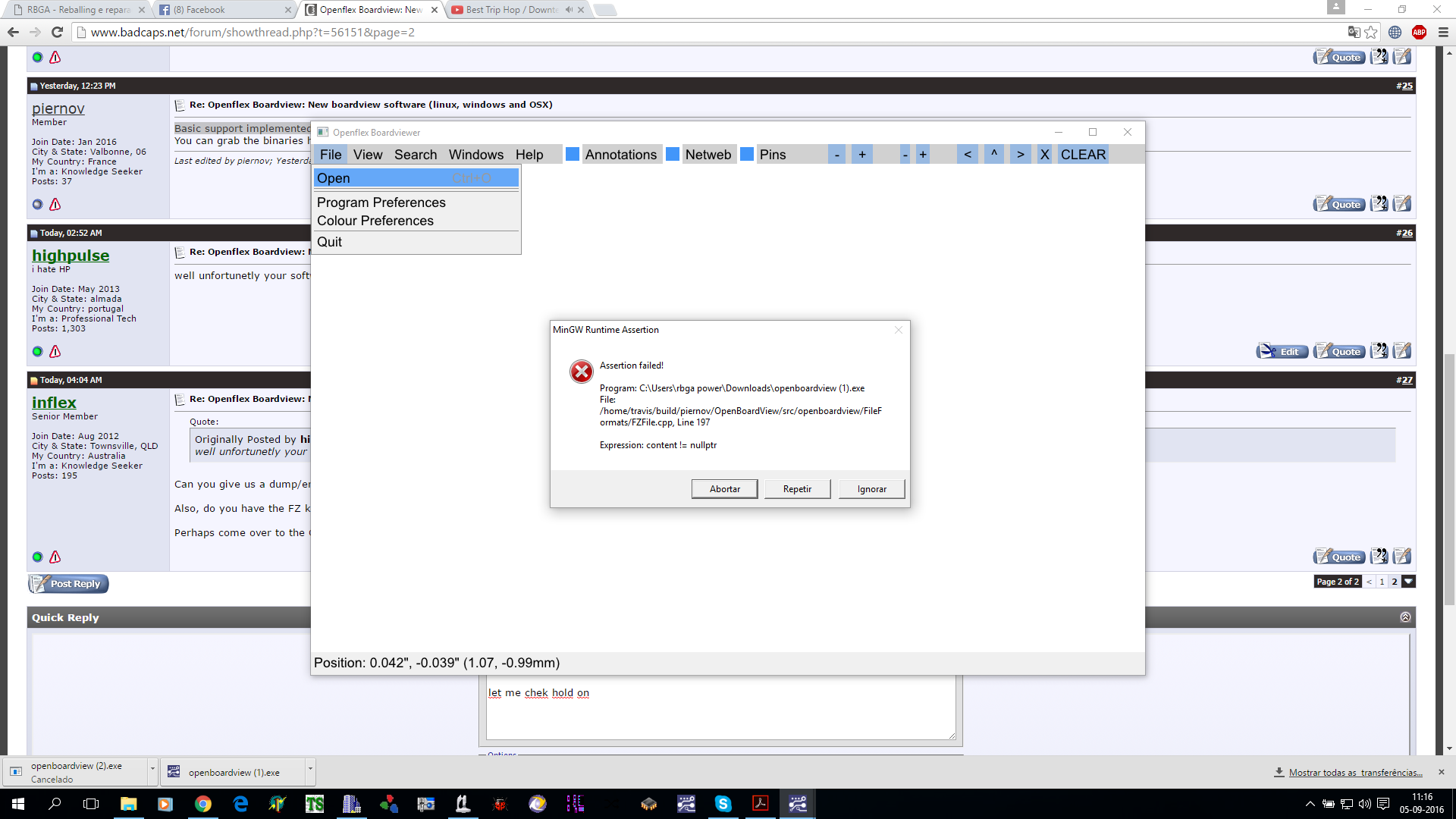

              Re: Openflex Boardview: New boardview software (linux, windows and OSX)
              well unfortunetly your software gives a lot of runtime error , specially it didn't open yet any .FZ file !!!
                Can you give us a dump/error? What Windows OS?
                Also, do you have the FZ key installed so you can decode the fz files?
                Perhaps come over to the Github repo and make an issue-ticket?
                  hey back .
                  let me chek hold on
                  so OS is windos 10
                  what do you mean about FZ key installed ( i usually open them on "PCB Repair Tool" and no issues and nothing needed .
                  sorry im not software expert here , my thing is the electronics :P so feel free to tell me what do i need
                  cheers
                  here are some fotos of the runtime errors

                    #29
                    Yep, they're all relating to the lack of the FZ Key sadly.
                    Because it's Open source software, we cannot legally supply it with the required FZ decoding key (it's available, many people have it, but we cannot provide it).
                    One of those annoying issues
                    I might talk with piernov and see what we can do about making those "Assert" errors a little more human readable, thanks.

                      #30
                      thk , so were do i can find does fz keys , and were i need to put them ?
                      cheers

                        #31
                        well managed to get does fz. files , it works like a charm now
                        thk for the help
