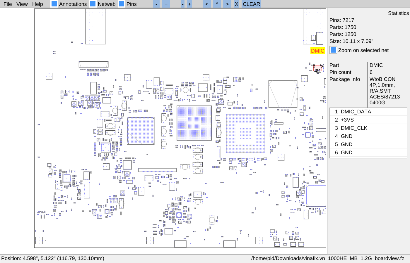

                hey guys , im unable to open does 1000h asus boardview files ,
                version 1.0 1.1 and 1.2 all impossible to open ,
                tryed on openboardview , boardviewer , pcbrepair tool , all same issue

                    Thank piernov and his sharp eye... we have decode the new board

                          #52
                          Re: Openflex Boardview: New boardview software (linux, windows and OSX)
                          highpulse's one was not encrypted in fact so that's why the decryption process produced garbage. We've implemented an auto-detection to support both encrypted and unencrypted files.
                          remax' one is corrupted. The file is truncated and so we're especially missing the last 4 bytes which allow us to detect the second part size to split the file (the file is divided in 2 parts). We could try to implement an auto detection of this field but the best would be to get a working file or "fix it" (ie. add those last 4 bytes which here would be 7014 encoded as a 32 bit little endian int if I'm not mistaken).

                                    hey guys , so wich key is to be added to the setup ? for i can open the asus 1000h boardview ?
                                    • piernov
                                      • Jan 2016
                                      • 4439
                                      • France
                                      #58
                                      Published a release for highpulse: https://github.com/piernov/OpenBoard...leases/tag/N11
                                        Your file was not encoded, I fix it with standart key.
                                        Is it a lot of not encoded FZ files on vinafix? Should I do support of them in my program?
