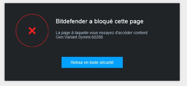

      Re: Openflex Boardview: New boardview software (linux, windows and OSX)
      Thanks for your hard work.
      I get a virus warning when i try to download
        Thanks for that, I'll have to see what's going on there and double check.
          I just scanned here with ESET NOD32 and it's come up clean.
          I've attached a new zip build here (off my linux build machine), see if that still gives you a warning ( I noticed the old one had two copies of each file in it, my fault there, as the Linux zip builder appended rather than built from clean).
            Feels like a false-positive on that; I'll try rebuilding with different parameters in VS2015 to see if it changes
              I just rebuilt it with different optimisations in VS2015, now shows up clean, so 99.99% likely the previous one was a false positive but thankyou for notifying me, I greatly appreciate that.

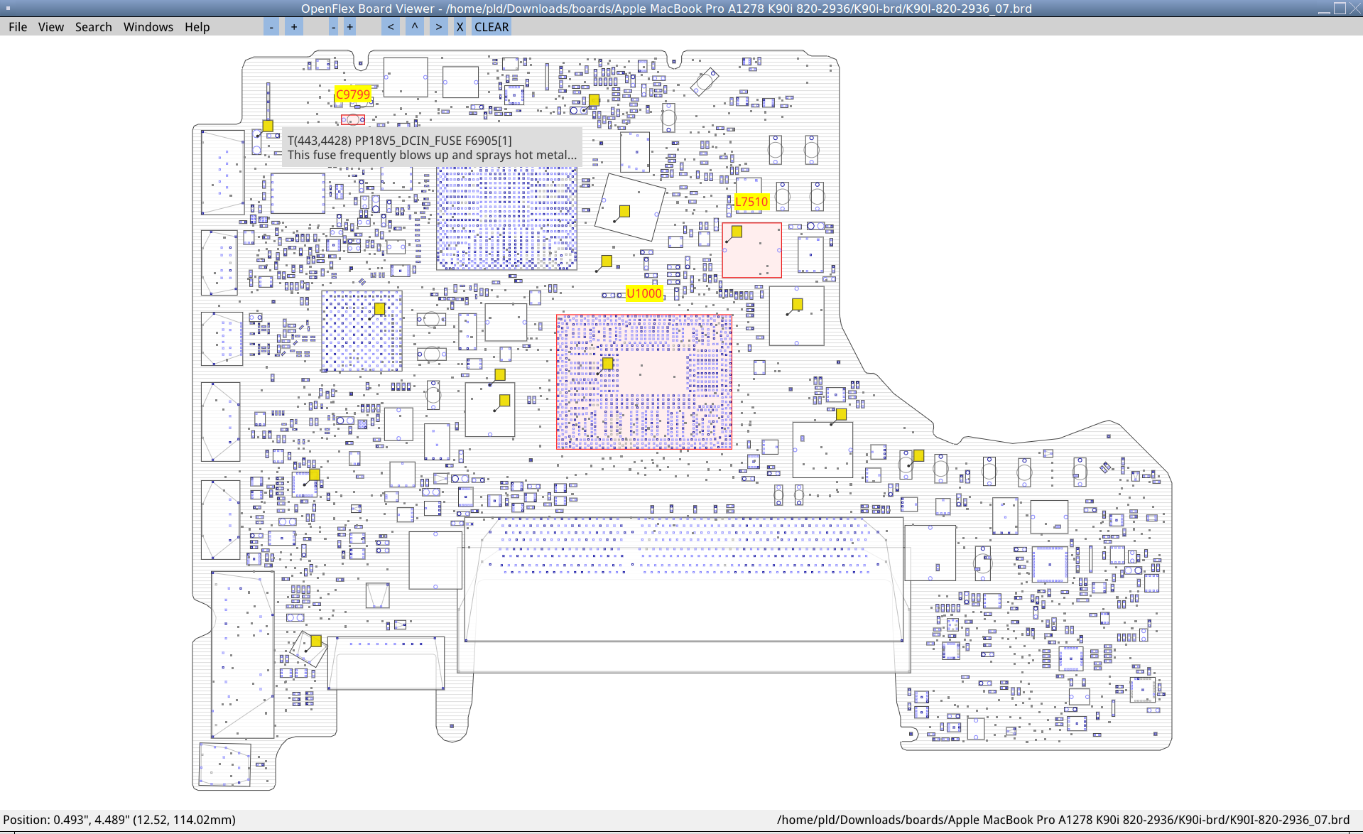

                          New update built. More items configurable.
                          * Selectable primary flip mode (viewport or mouse pointer, the latter so you can see what's under the board at the same point). Pressing shift+space/middle-mouse will flip the alternative method.
                          * Same-net web, connects each other pin on the same net with a line from the current pin (will probably add a nicer branching algorithm in the future to reduce the level of fan-out). Current NC, Unknown and GND nets are not drawn with this (meaningless or too prolific).
                          Picture showing the same-net web draw example. Fine blue lines are indicating that there's pins on the other side of the board at those locations.
