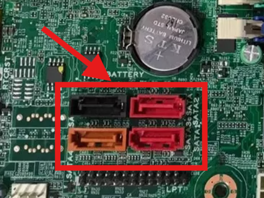

Thanks guys ; You mention that i should use a second HDD and that would be my first option ,but how i connect a second drive ,Do you see in my motherboard output to connect another motherboard Lenovo M-92P 3.20Ghz I5 2400 ,8GB Ram sandy bridge ; https://www.ebay.com/itm/26634731395...faultOrganicWe Maybe this video will help me despite not be same model.;https://www.youtube.com/watch?v=cJDTn7nJmHc

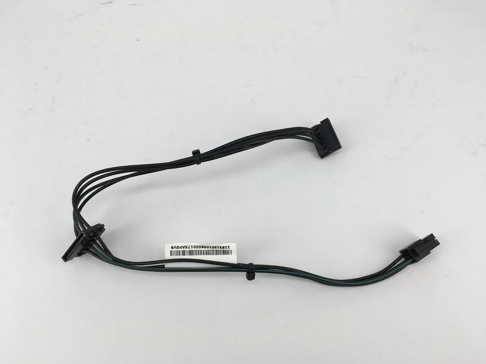

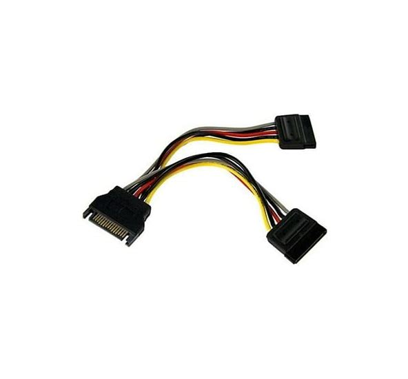

Thanks mate .Yes i see ,what about the power supply maybe i share cable from the DVD?
Yeah, should be OK to split the power rail. But I would suggest first checking the power supply label to make sure it can handle it. Mini PCs are not exactly known to have "beefy" power supplies.
You can do it either with an original cable, or just use a SATA power splitter.
Hi folks ;I did finely made a decision on how to go about the OPS on my Lenovo M91 Small case. I kept Win 10 on one HDD and installed Linux Ubuntu on another small laptop HDD used DVD power and Sata connection and attached it to the another HDD and it fits perfectly ,then installed Grub boot manager and now i can boot either one . I find 24.04.2 LTS to be very good and i do almost everything i do
