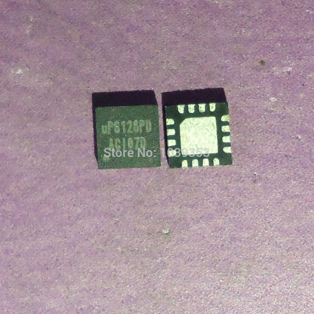

    Good day. Does anybody have datasheet for this one? Its a pwm controller with code UP6128PD. I need to check if I have substitute for this one. I attached image for reference only. Hope someone has Thanks!

    had a look boardview K55vd (pu8901-pu8301)and compare it with asus n73sv (page82-83), seem up6128pd compatible with rt8202a/b. but not sure 100%. if you want to try it. its your own risk

      Thanks meritosari. Actually its the exact motherboard I'm fixing, Asus K55vd. When I press power button, all lights turn on but processor fan does not spin. There's no display and cpu does not heatup. I checked motherboard and found short on PL8905 which led me to this IC UP6128PD (pu8901). A closer look revealed corroded pins on 1,2,3,14,15 and 16. If I can confirm RT8202AB is compatible, it will be much easier to find. thanks again

        if i in your position, then i'll try it
