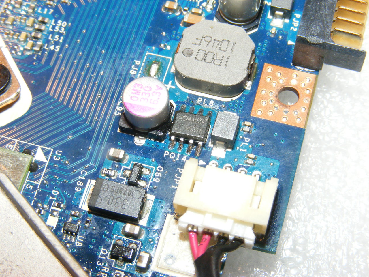

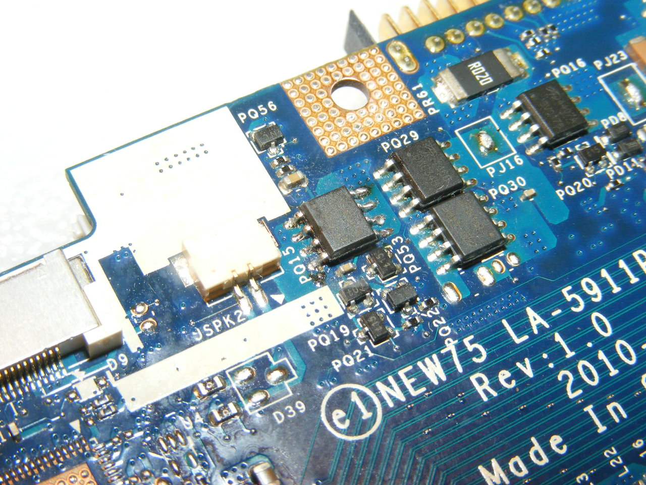

                        Here's a couple of images. Excuse the slightly wonky PQ14 and messy PQ15. I replaced them as "matter of standard habit" and instead of using paste+hotair reflow I got lazy and hand-soldered.

                          measure voltage in both side of each resistor pr69 pr94 as marked in picture. we cant say with one is pr69 and pr94. u have to desolder and measure with capacimeter, but firse see if they are ok (think one is dead....)
                          edit: the one upper near pq56 should be pr69 and the one down near caps 0603 should be pr94.
                          edit: see now your edit. report pu5 voltage.

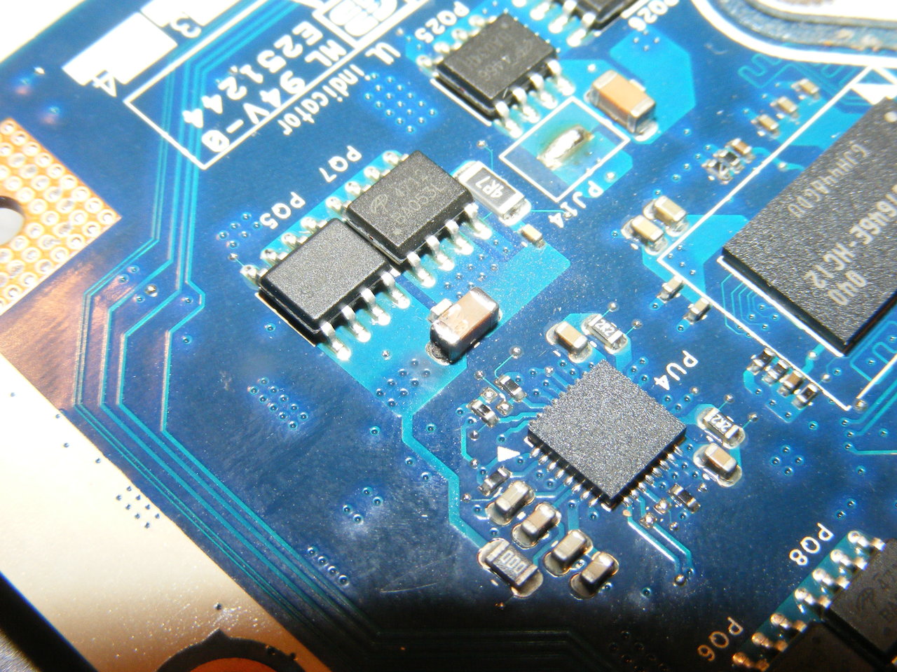

                          edit3: report also voltage on pu4 pin 6

                              PU4[6] is 15.0V
                              PU4[5] is 3.27V

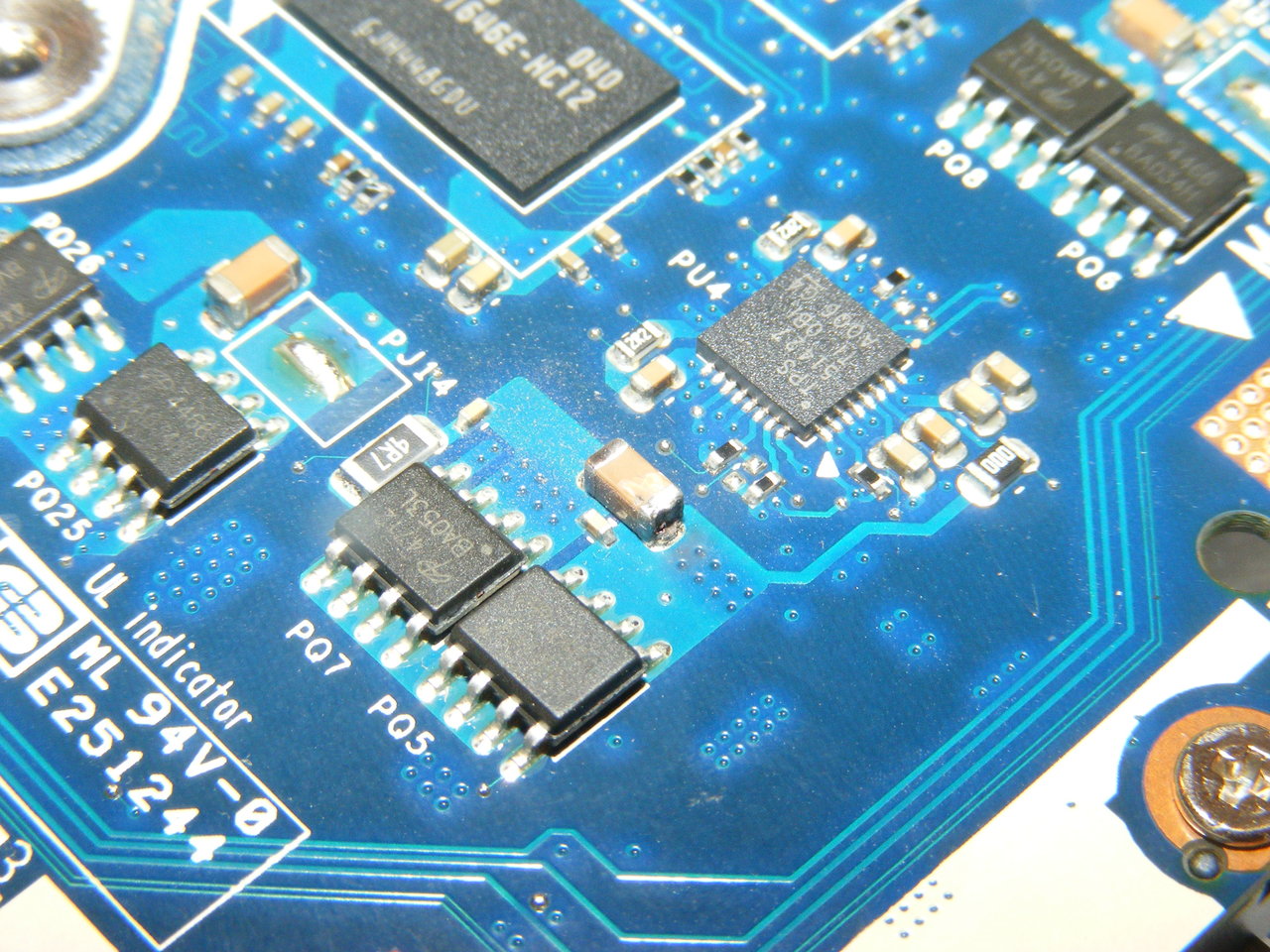

                                  I think I may have found something, purely by accident... look at the 1206 ceramic between PQ5 and PQ7, looks like it's had a bad day.

                                      Re: Acer 5552G, no lights, nothing. Need schematic, and some luck
                                      it should be pc31 in schematic. try resolder it.
                                      report pl3 and pl4 voltage. if 5v and 3.3 volt pc shoult start fine.
                                        !!!BINGO!!! We have a winner.
                                        I don't have any 10uF 1206 25V units on hand (highest I have is 16V), but a quick test with a 2u2 item was able to make the unit start.
                                        I'll order some 25V units tomorrow.
