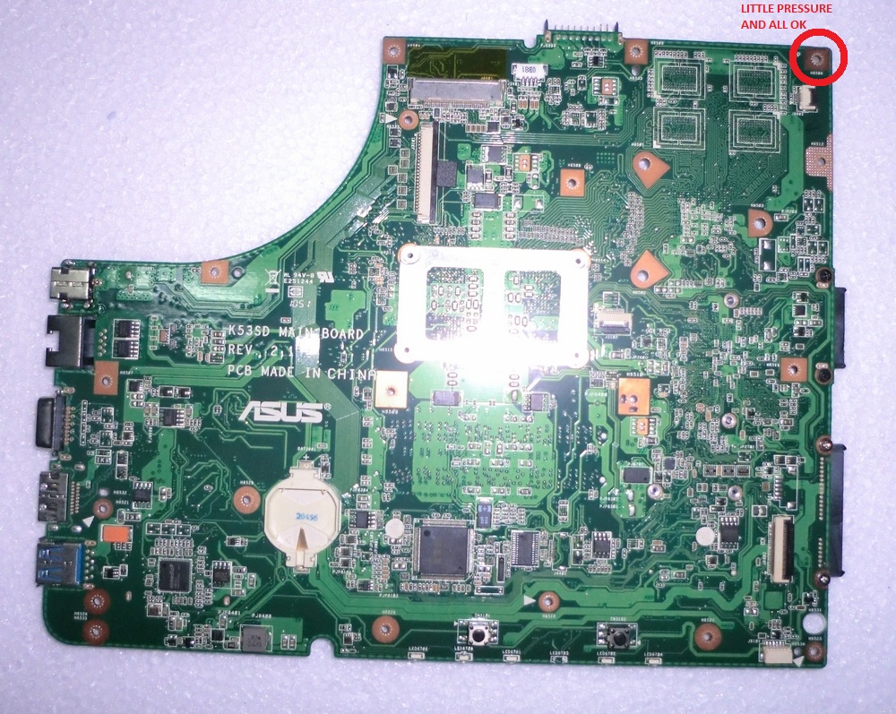

    have this one asus X53E/board K53SD rev. 2.1/ and it self start and not fully reage to power switch. i ffind taha it have some short on main power on LVDS connector because i see some self-solder in connector.
    cannot find schematic to fully diagnose it. any help with it?
    board code is hannstar J MV-4 94V-01122 E89382
    i found that it can have same board as acer 8942/8943

      i found that without battery it start normally on external, but sometime nothing

          Re: asus X53E/board K53SD rev. 2.1/ self start need schematic
          maybe its simmilar but this asus have other ics and no board marks a and some ic are not the same
          But i think i have some broken contact. when i twist the board in some direction it works normally. do somebody know what ic or part can have that loose contact? i dont wanna bake whole board when it works
          sometimes it start without display with all leds come and restart, sometime it wont start but have all basic voltages, sometime it start ok. what do u think what ic can be doing this?
            In the other thread, I have the Asus K53sv mobo, also no marks and no schematics.
            I was hoping you were right about the Acer board.
            The onliest loose contact item I would suspect is the power plug or direct related components.

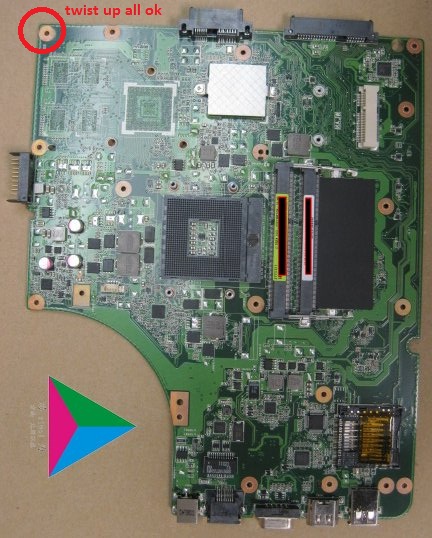

              now i 100% know its broken contact when i put little pressure on one corner of board it work, but whe i put out that pressure it restart. what ic it can be?/see picture/
                When you put the pressure, where is the board supported or held?
                At the place it is supported there may be more components than around the pressure point.
                  the board laying on the table i think on the heatpipe on processor. but i think the NB can be that ic, because board do some funny thing like no video or no start when no twisting it.
                  when i dont find anything i try to reflow it.
