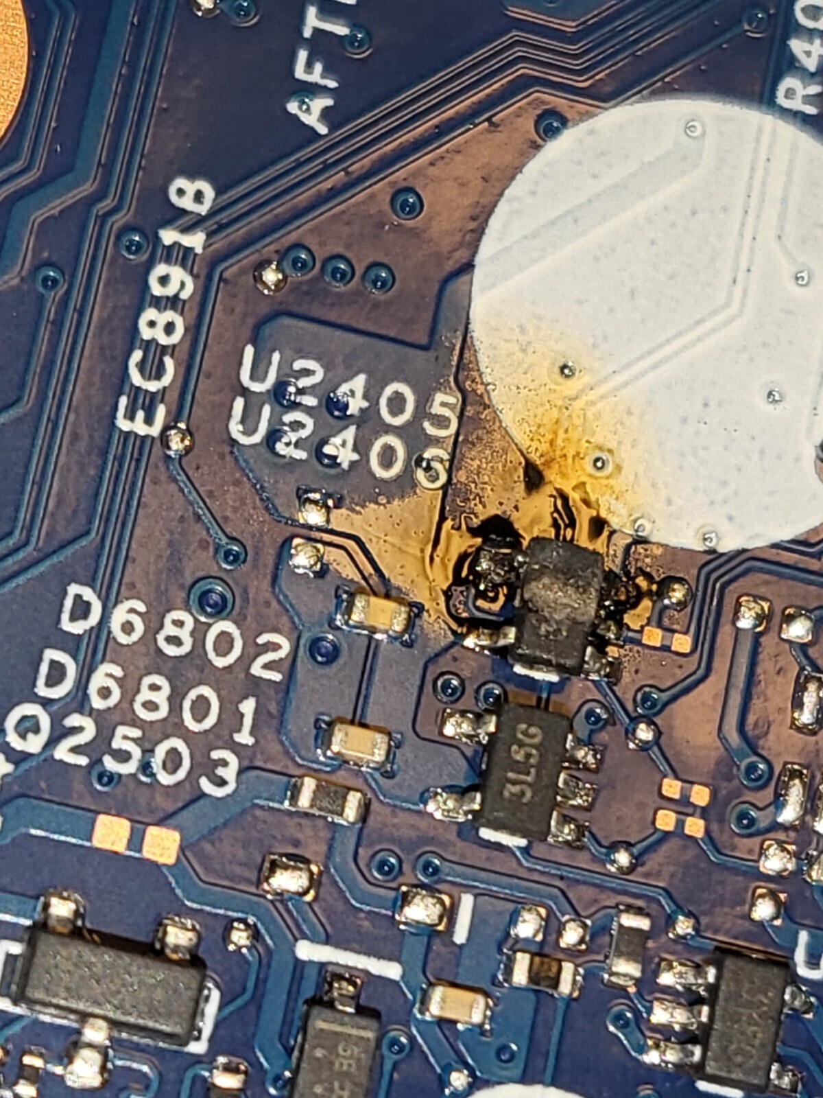

            Can someone help me get the schematic for the i7 board? 12800H is totally dead, no lights, nothing.
            I noticed the back part it has some burned components.
            I found this one that has burnt: U2405 and seems like also U2406. But by the pictures it looks fine
            Or if I could pull the same components from other part of the board to test, I don't have a donor board.
