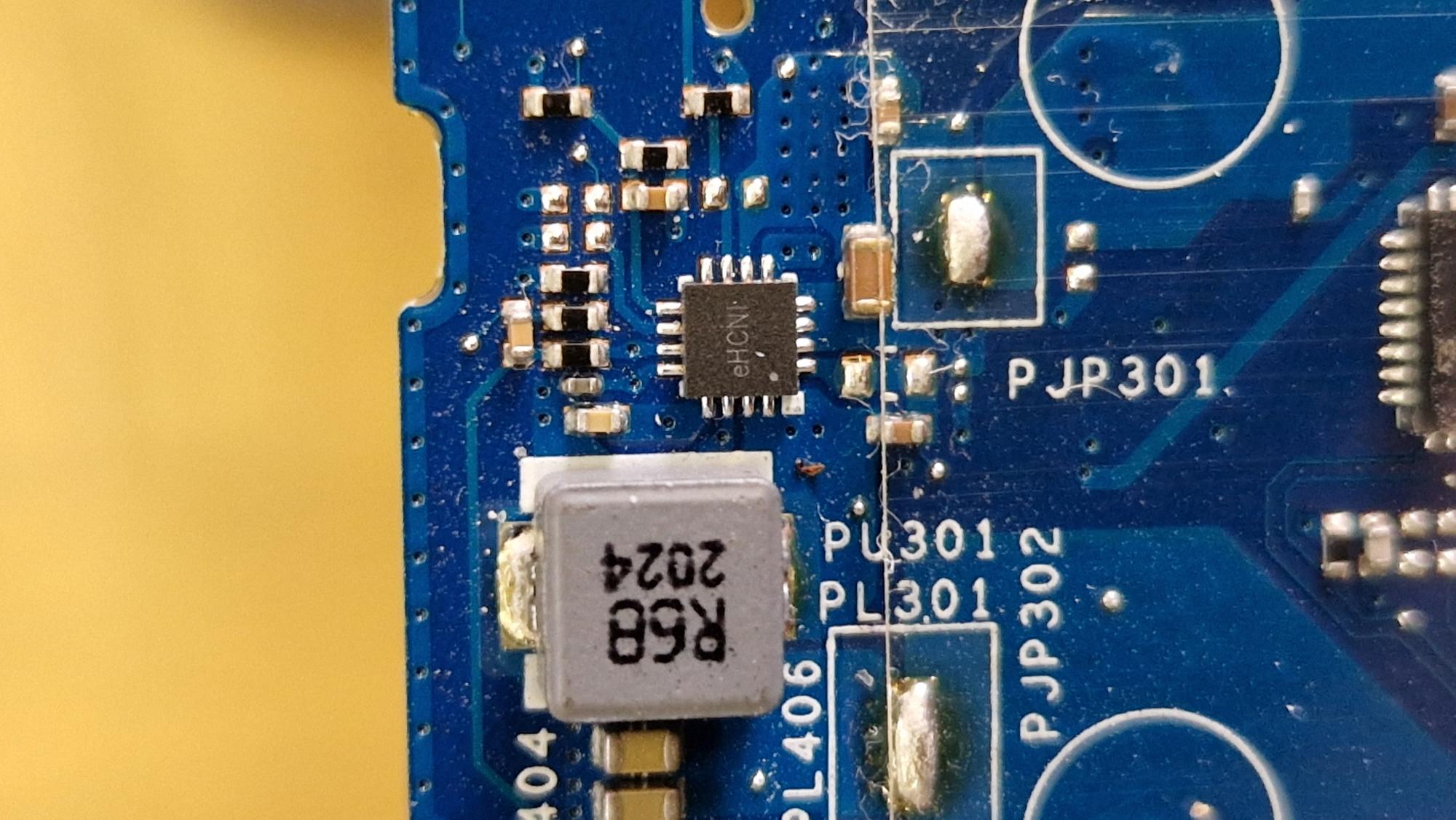

                Dell latitude 5410 la-j371p.
                Anyone know what ic marking eHCQE (Q could be a 0). Its a LA-J371p dell latitude 5410?

                  Re: Dell latitude 5410 la-j371p.
                  Hello Bro, you must be more explicit which component are you referring to pu401? what do you want to know?
                    It might or might not be a silergy SY8386RHC .Some sellers list it with different marking codes, eH*** and Kd*** , don`t know for certain without a datasheet and at the moment its only available to customers with a mysilergy account.
                    One of our members contacted me via PM and said on his LA-H101P motherboard the marking was Kd . So eH or Kd ?
                      Apologies pu301. I cant find any bv or schematic for this model.
                        Many thanks..

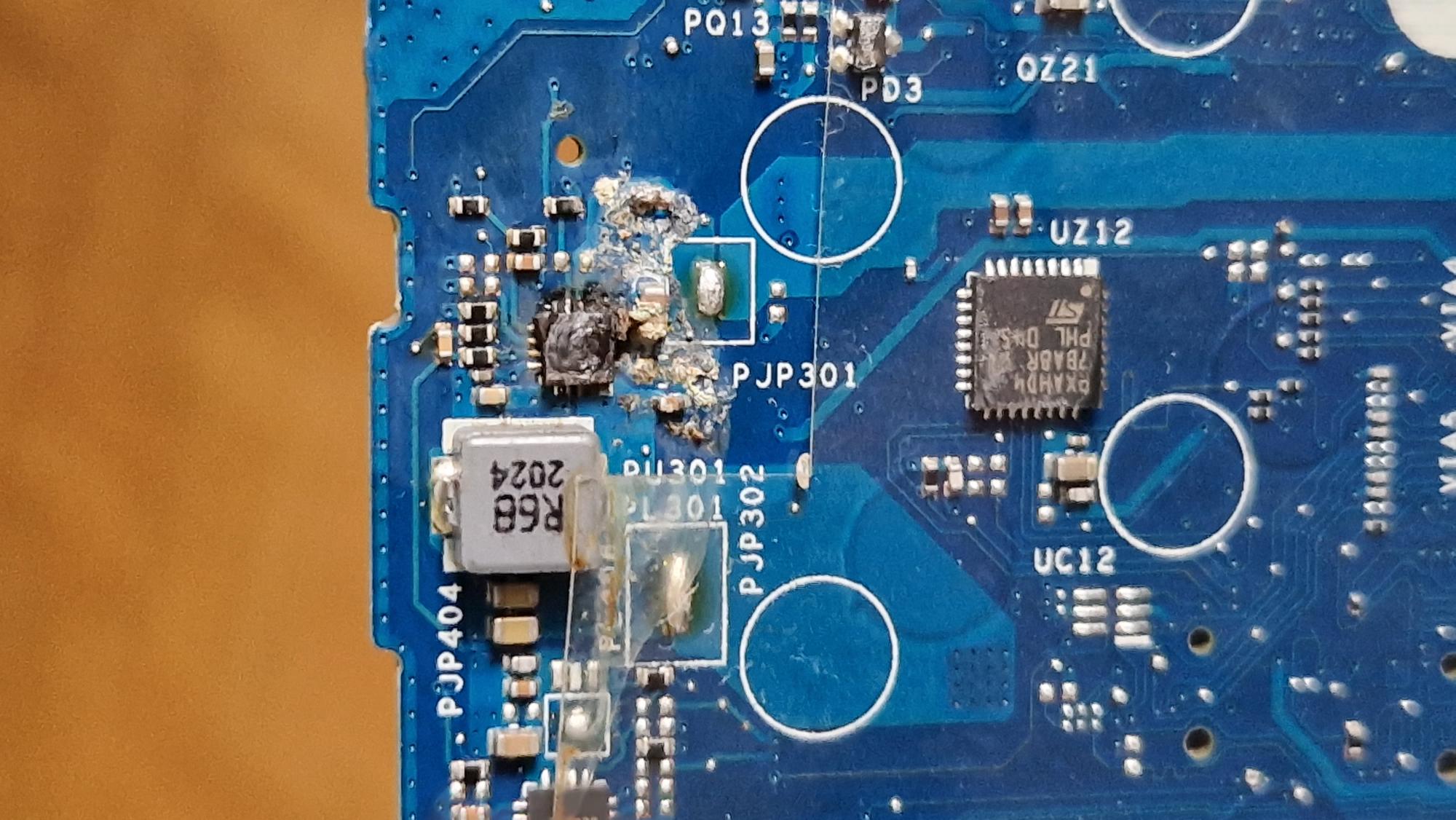

                          Hey. I am also looking for this component what it is. Someone spilled coffee on the IC. Here is the picture from a good one and also broken one.
                          Does anyone know what this ic could be? eHCNI is the ic
                          Thank you.

                          • SERGEY1962
                            • Jun 2016
                            • 14
                            • Holland
                            Re: Dell Latitude 5410/5510 LA-J371P Broadview / Schematics
                            Kd*** is confirmed as SY8388RHC, please check this thread https://www.elvikom.pl/prosba-o-dobr...hc-t70180.html and this one http://www.tecnologos.net/viewtopic.php?t=5635
                            eH*** then seems to be SY8386RHC.
