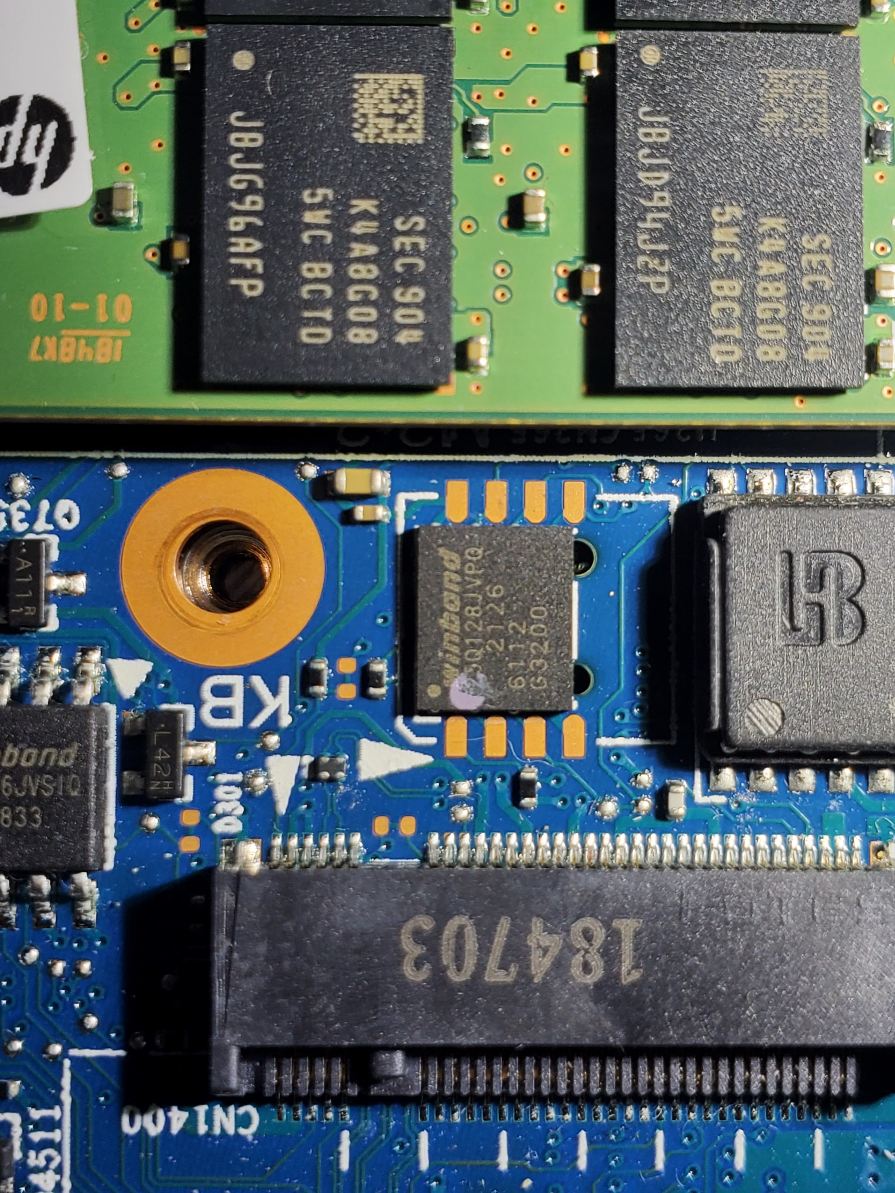

                        I'm completely new to this and have a few questions. Is 25Q128JVPQ just where the Power On Password is stored? After reading other posts and information, I was under the impression that there were 2 chips that needed to be flashed. If so, I was trying to verify which 2 they would be, as they both appear to be BIOS related chips.
                        • Oliver144
                          • May 2024
                          • Deutschland
                          HP Elitebook 735 G5
                          I read the BIOS chip on the back and removed the menu administrator password. In my case it was an ISSI "IC25LP128" , on the front there are also two chips but I don't need to change them. I used an CH341A Programmer.

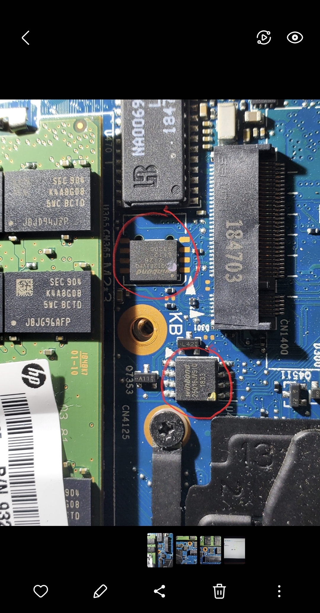

                            HP EliteBook 735 G5 No Display
                            SN: 5CG9351LD8
                            Prod ID 2HB39AV
                            The Computer seems to have a Bios Corruption Can i have help in trying to solve the issue....
                            it is Flickering the Caps Lock when switch is pressed, Also the Charger Light is flickering orange/White light interchangeably, and there will be no display.
                            i tried 3 Good known Rams there was no change
                            • hoaca388
                              Badcaps
                              • Jan 2022
                              • 11883
                              SN: 5CG9351LD8
                              Prod ID 2HB39AV
                              You selected the wrong chip. Chọn chip có số 128, Ex : W25Q128...
                              • MtapeK
                                • Sep 2020
                                • 36
                                • Zimbabwe
                                there you go I TOOK FROM THE ONE AT BACK NOW
                                • hoaca388
                                  Badcaps
                                  • Jan 2022
                                  • 11883
                                  Not this chip, this is the EC chip, there is another chip.

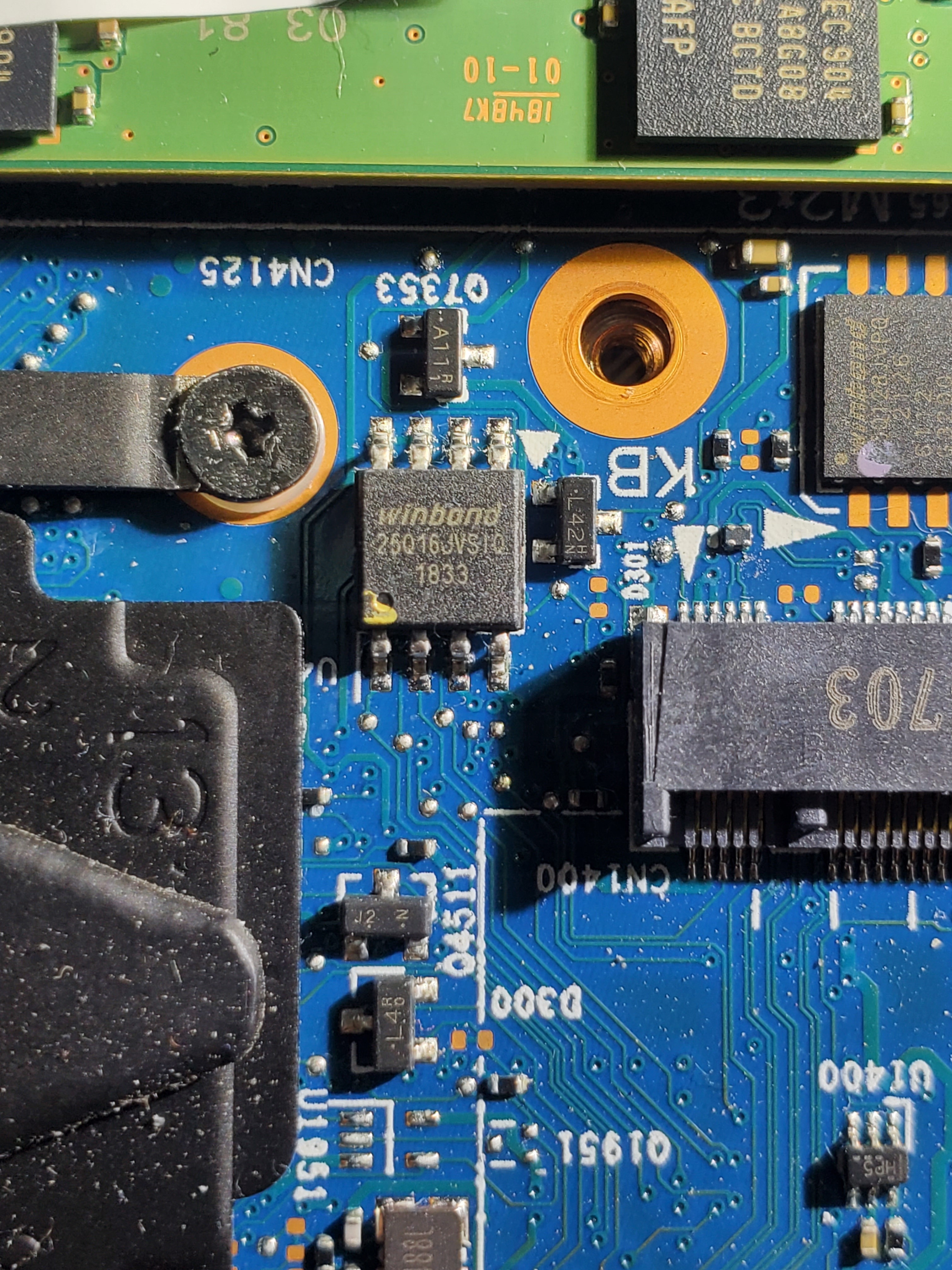

                                  • MtapeK
                                    • Sep 2020
                                    • 36
                                    • Zimbabwe
                                    THIS IC NOW THE THIRD DUMP
