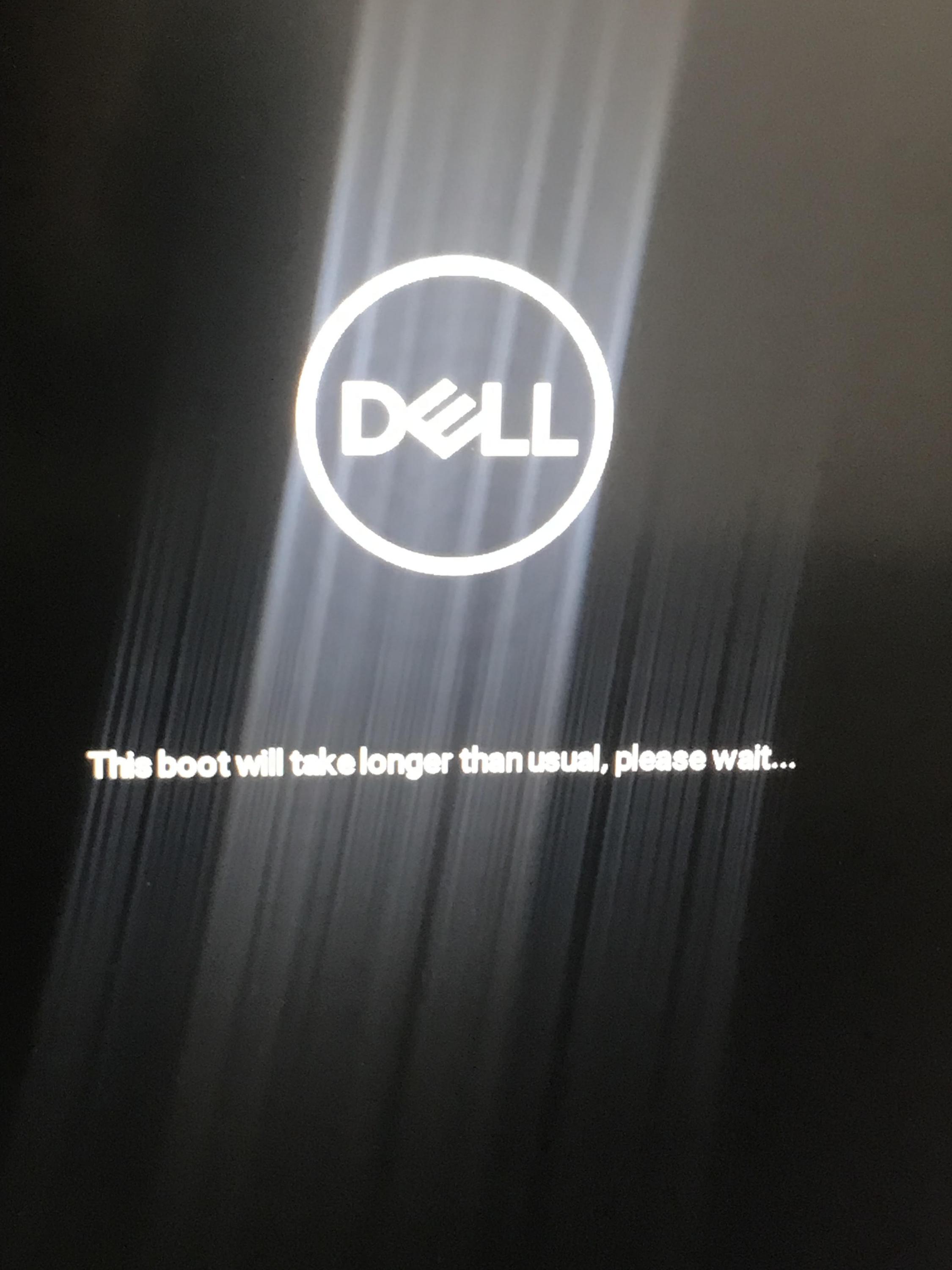

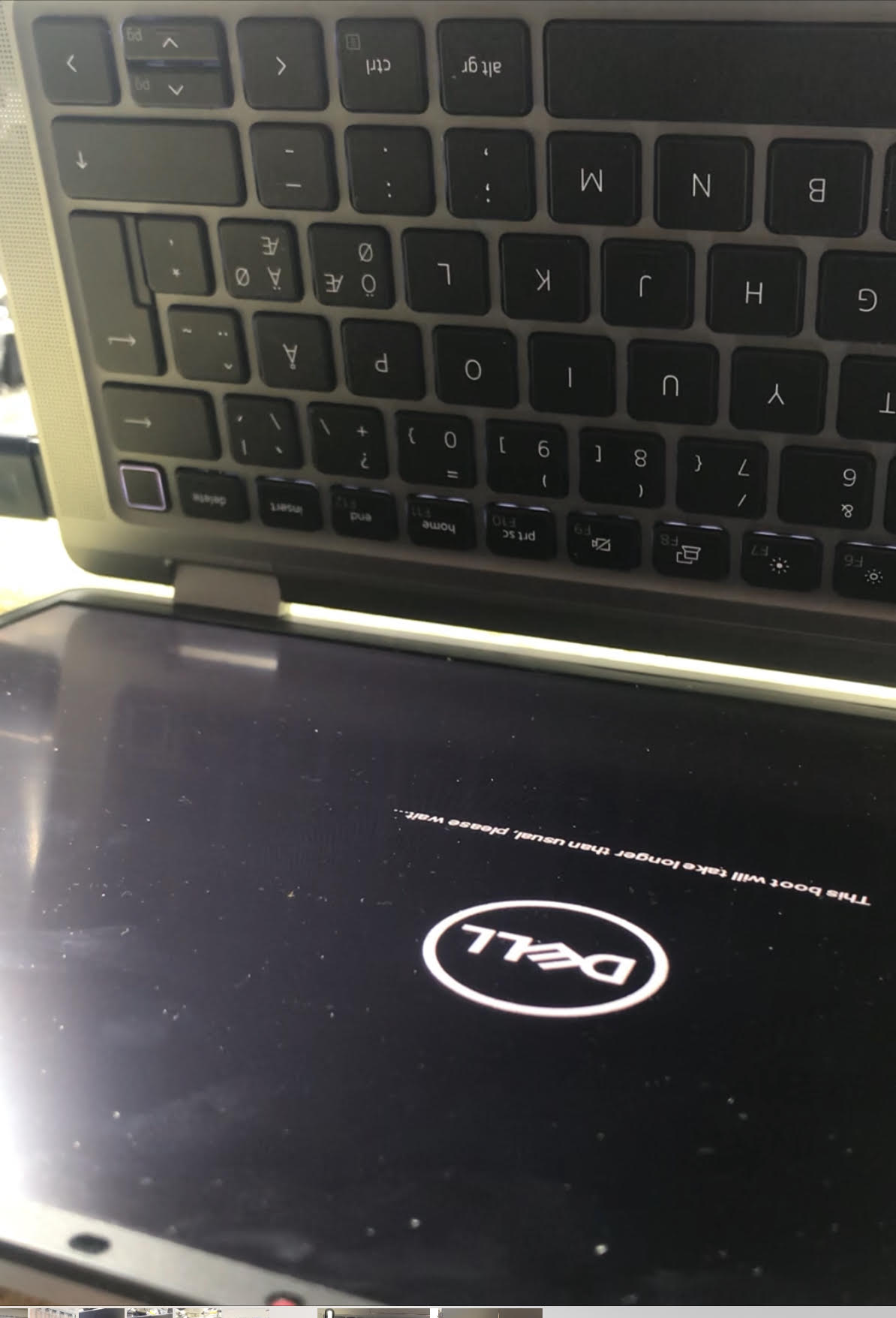

              same think no power
              itry another dump ffrom laptop 9420 i7 11th ..
              laptop is power on . show logo but stil logo loop restar and somtime screen RVB bleu red green balck and restar

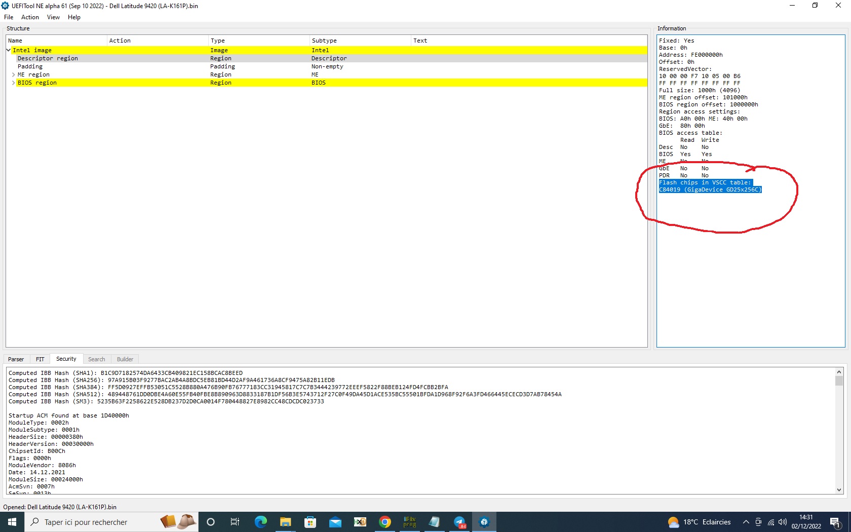

                    • lapfix
                      • Mar 2020
                      • 2719
                      • my workshop
                      Re: need bios Dell Latitude 9420 LA-K161P
                      My friend , there's a difference between not working and work but stuck at logo dell , you must precise the information given .
                      One question : did you change the bios chip ! it must be GigaDevice GD25x256C
                      • cgtec
                        • Feb 2014
                        • 54
                        • algeria
                        stuck at logo dell
                        i change chip to winbond 25q256
                        • lapfix
                          • Mar 2020
                          • 2719
                          • my workshop
                          At your VSCC table there's only GigaDevice GD25x256C , no winbond ; so i suggest to back up the old chip
