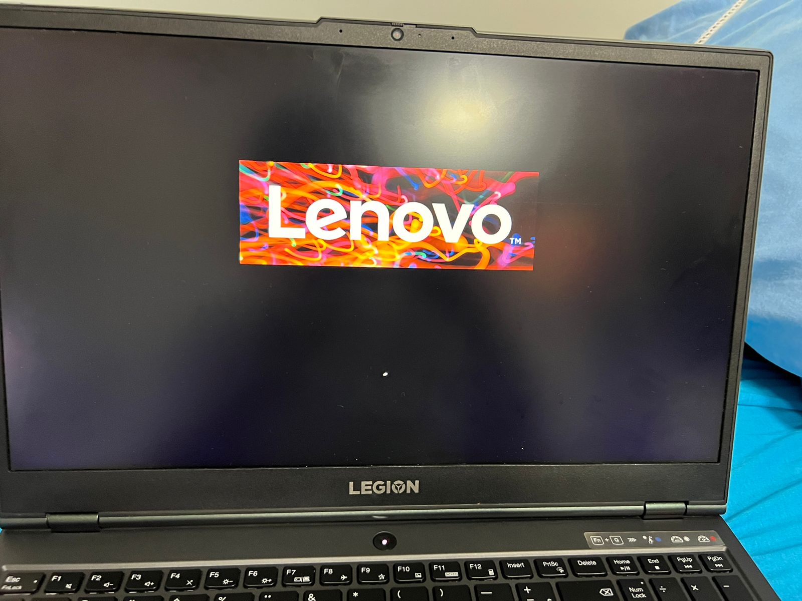

          Re: Need LenovoLegion 5-15IMH05H NM-c911 bios Clean dump

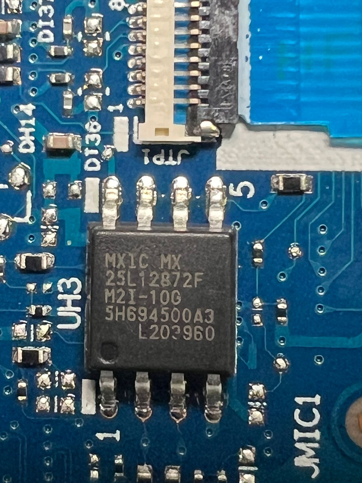

          friend I just put new BIOS but even so it keeps turning on and getting the black screen.
          Do you have any idea what it could be? because this happened when I updated his BIOS. when he restarted he turned on the leds and never again gave an image of anything.
          I'm using a CH341 Programmer V1.43 my chip is a MX25L12872FM2I-10G Macronix
          when I put it in the program it recognizes the normal chip, erases it, makes the recording successfully
          I have no idea what it could be... And I don't understand anything about BIOS, so it would be just taking this BIN image and having it programmed right?
          Is there any chance the BIOS is still corrupted with something?
          before the 58ww version that did this. it was working properly in 52WW version

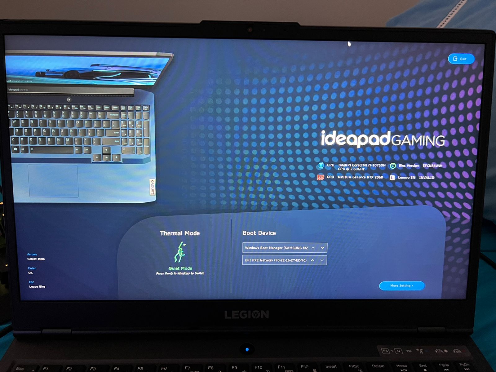

                              I can't understand what's going on...
                              the notebook is not working with these BIOS that would be his original BIOS.
                              but I tried it with another Ideapad gaming BIOS and it worked. The keyboard doesn't work. but it gives image

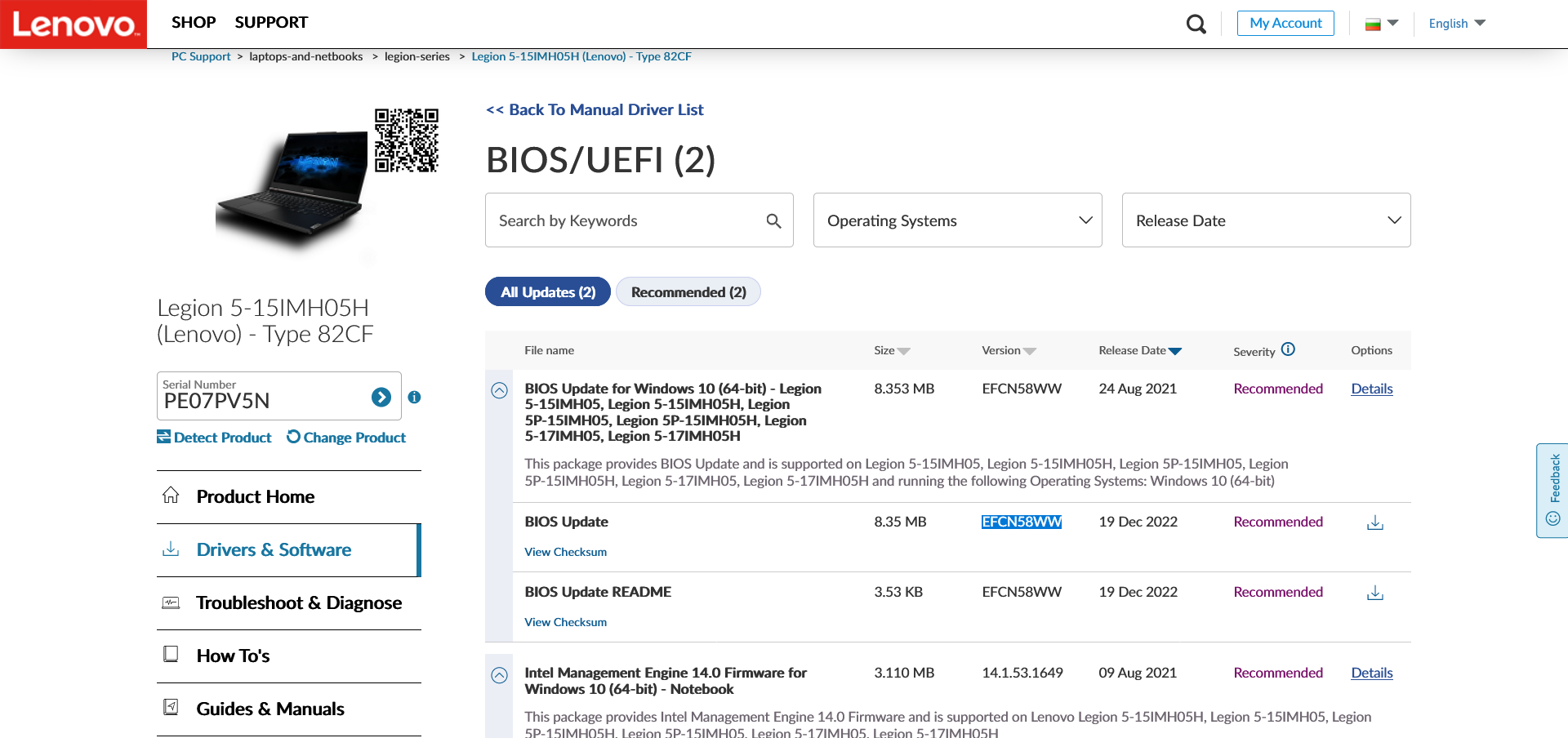

                                  the only thing that makes him give an image is this one
                                  • Vesko356
                                    VIP Moderator
                                    • Aug 2018
                                    • 4386
                                    • Bulgaria 🇧🇬
                                    This is exactly the same type but the latest available (58) version EFCN58WW.
                                    And the file by hardware1 at post #10 is also latest EFCN58WW, it's a virgin one with your DMI info, so should be working. Try again, maybe you didn't programmed the file to the chip as it should, or something else. Do it again, the file is 100% OK, I just checked it out.
                                    Become a Badcaps supporter
                                    Thanks to all supporters.

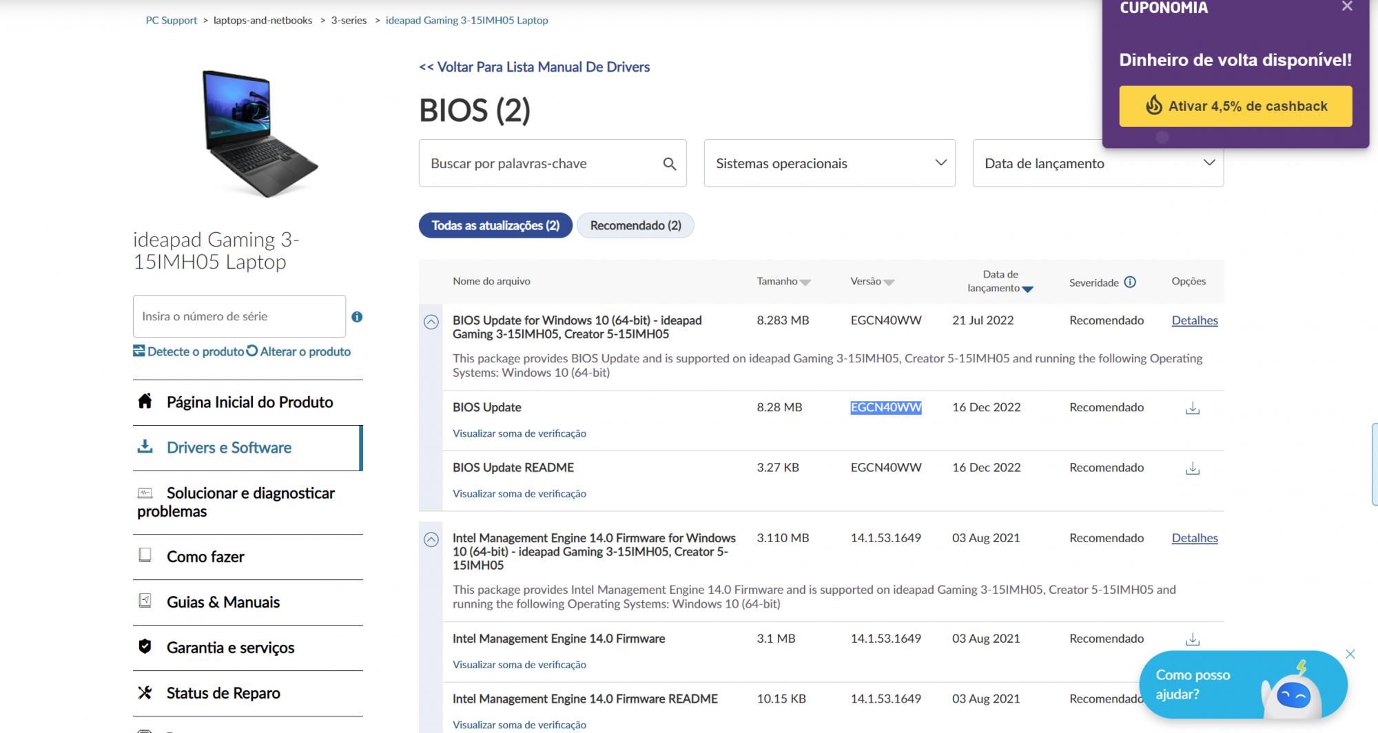

                                      yes friend... but this notebook is so crazy that it is not recognizing neither BIOS that you made nor Hardware1. The screen goes black with the light blinking
                                      and when I put that other BIOS that I honestly don't know why it's called 58WW because it's definitely not 58WW.
                                      It's actually an Ideapad Bios and when you turn on the notebook in the image and it recognizes itself as an ideapad
                                      but the keyboard does not work. it turns on the leds and works the keys from f1 to f10. but not the rest
                                      • Sergio06
                                        • Mar 2023
                                        • 16
                                        • Brasil
                                        in the bios it is saying that it is the 58WW but in reality the bios that is in it is the one in the print
