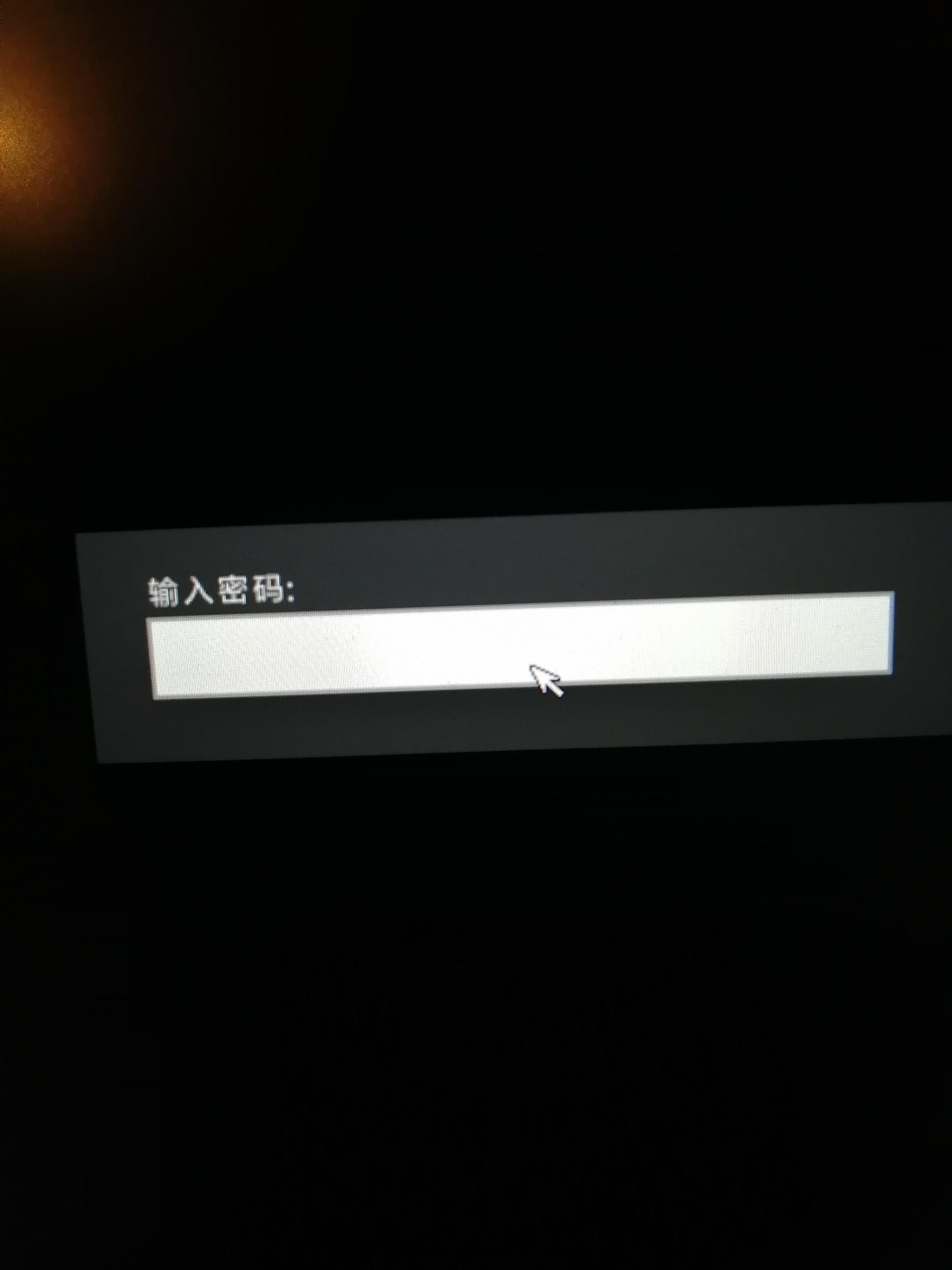

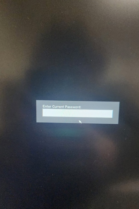

    Hello. I bought a laptop from aliexpress. When I enter the bios, it asks for the password. The seller says that he did not put it.
    How do I know or reset it?

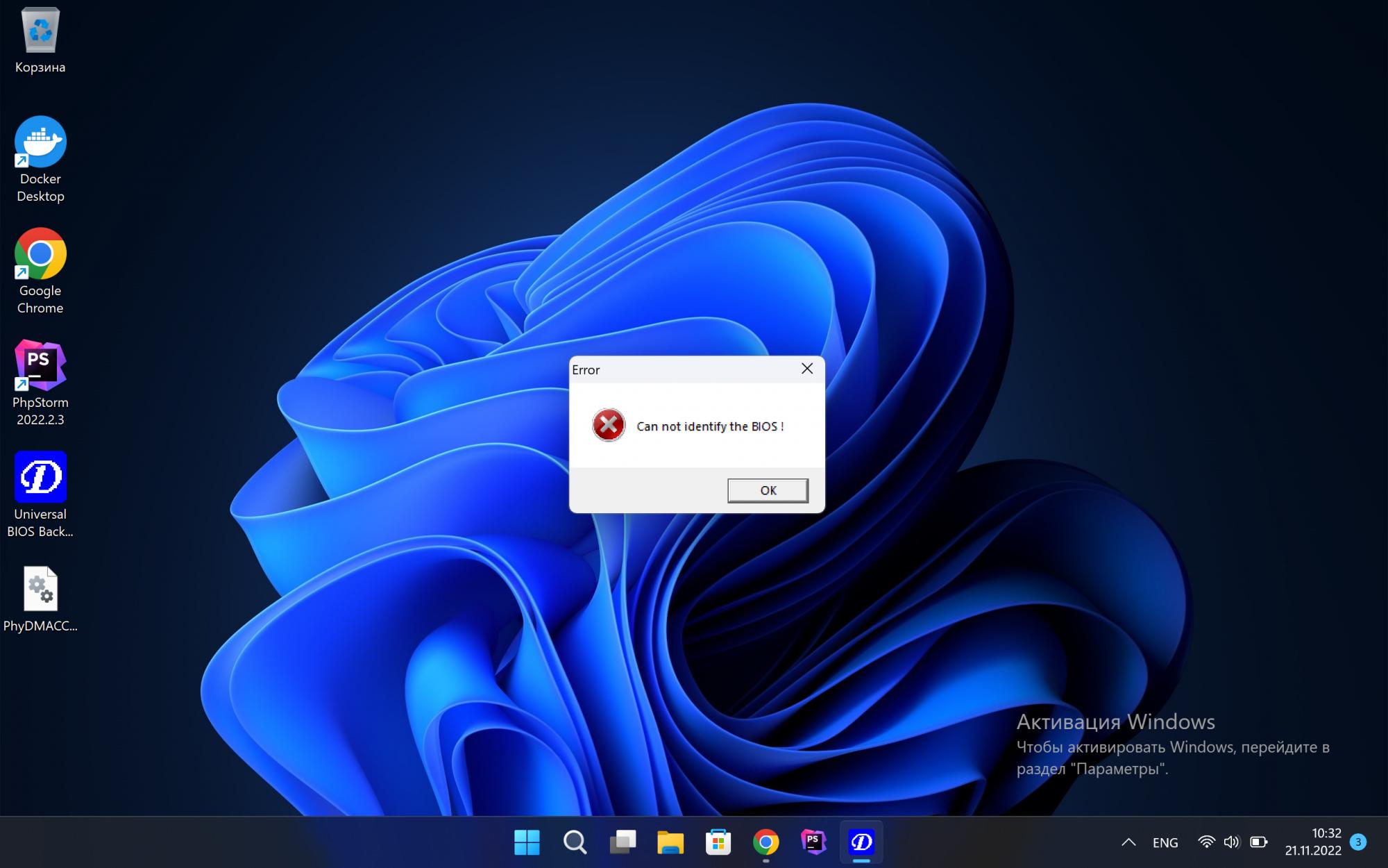

      Universal BIOS Backup ToolKit 2.0
      error
      • AAAC
        • Jan 2020
        • 459
        • Mexico
        Re: Xiaomi Redmibook Pro 14 2022 (AMD) BIOS password
        Ignore the error and continue with the instructions included in the file.

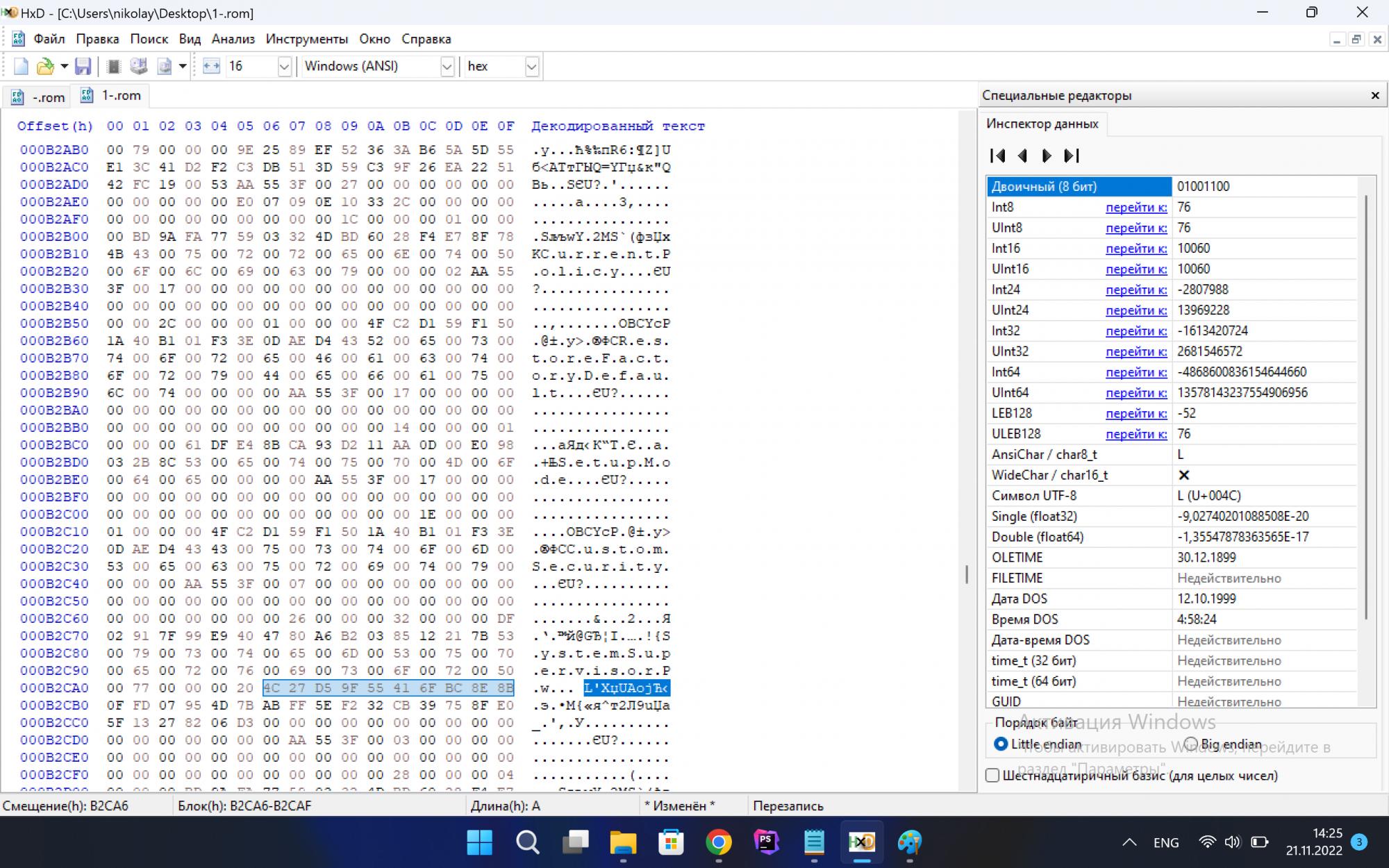

            I think I found the password in 1024k, but not in 16384K
            But how do I enter it? I don't have Chinese characters on my keyboard.

              What you are looking at is the UEFI variable that stores the Supervisor Password, but most likely is just a hash, it starts with 20h and ends at the D3h.
              204C27D59F55416FBC8E8B0FFD07954D7BABFF5EF232CB39758FE05F13278206D3
              There are 2-3 DXE drivers with interesting names, so this is about checking those modules and see what they do, but there may be another option like:
              What happens after 3 incorrect passwords, does it show any other information on the screen like a number, a date, etc.?
              Forgot to mention that if you have a BIOS chip programmer you can read the BIOS chip and just delete that SystemSupervisorPw variable, then program the BIOS chip with the new clean file.

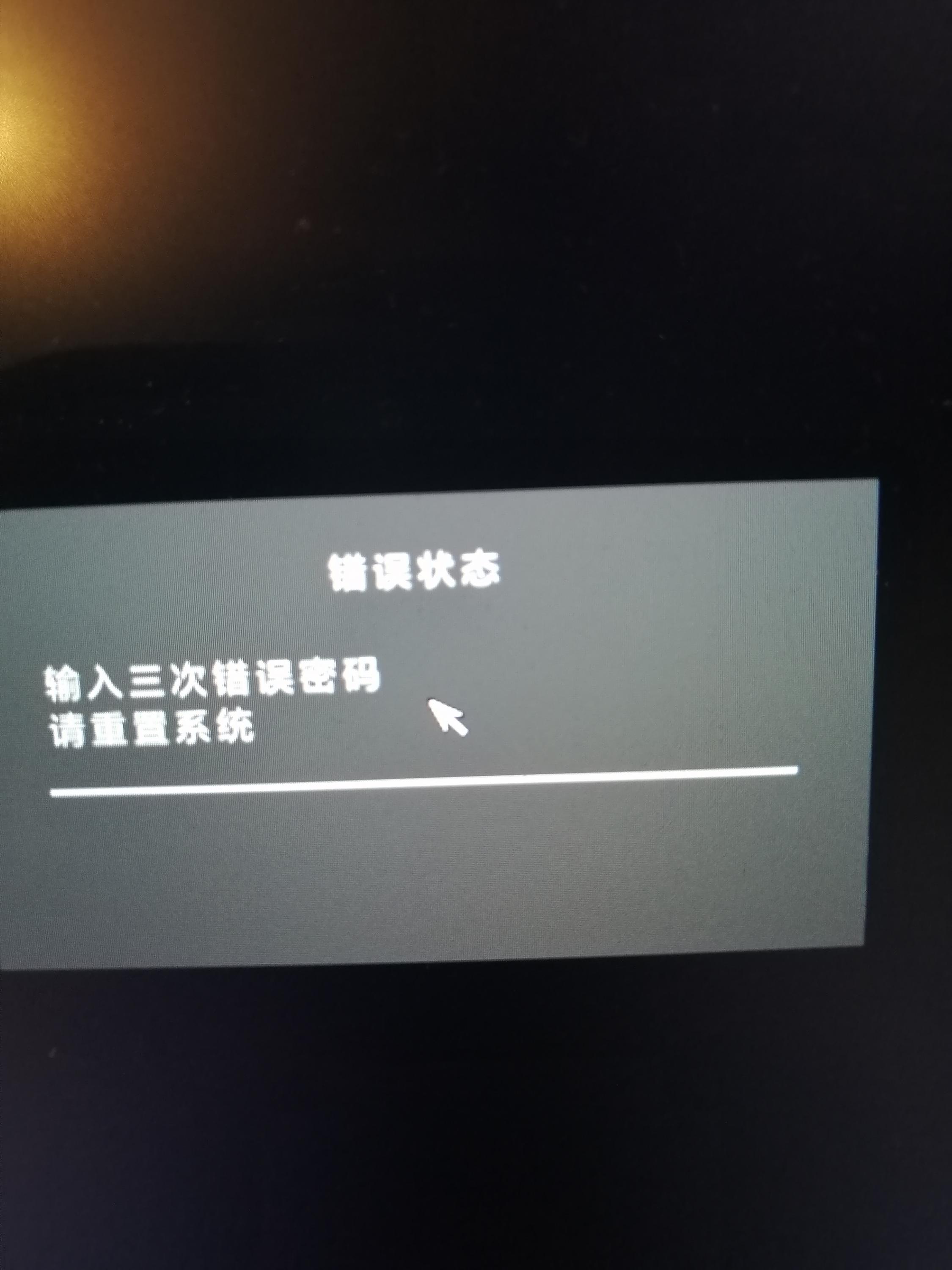

                  The password stored in the UEFI variable seems to be SHA256 hashed, so you will end up using a programmer in order to quickly read, patch and program a clean BIOS.
                  Have checked the messages shown after 3 incorrect passwords, they are just informative:
                  输入密码:
                  enter password:
                  错误状态
                  输入三次错误密码
                  请重置系統
                  error state
                  Enter wrong password three times
                  Please reset the system

                                Friends, help, I saw that a person had already encountered a problem, but I still didn't see a solution to the problem (except for the possible opening of the laptop and resetting via a tablet)
                                I bought this laptop, and the first time I turn it on, it asks me to log into the BIOS with a password (although, in theory, Windows is preinstalled there)
                                I don't have a password, I tried all the standard ones (like 0000, etc.)

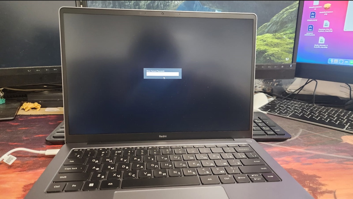

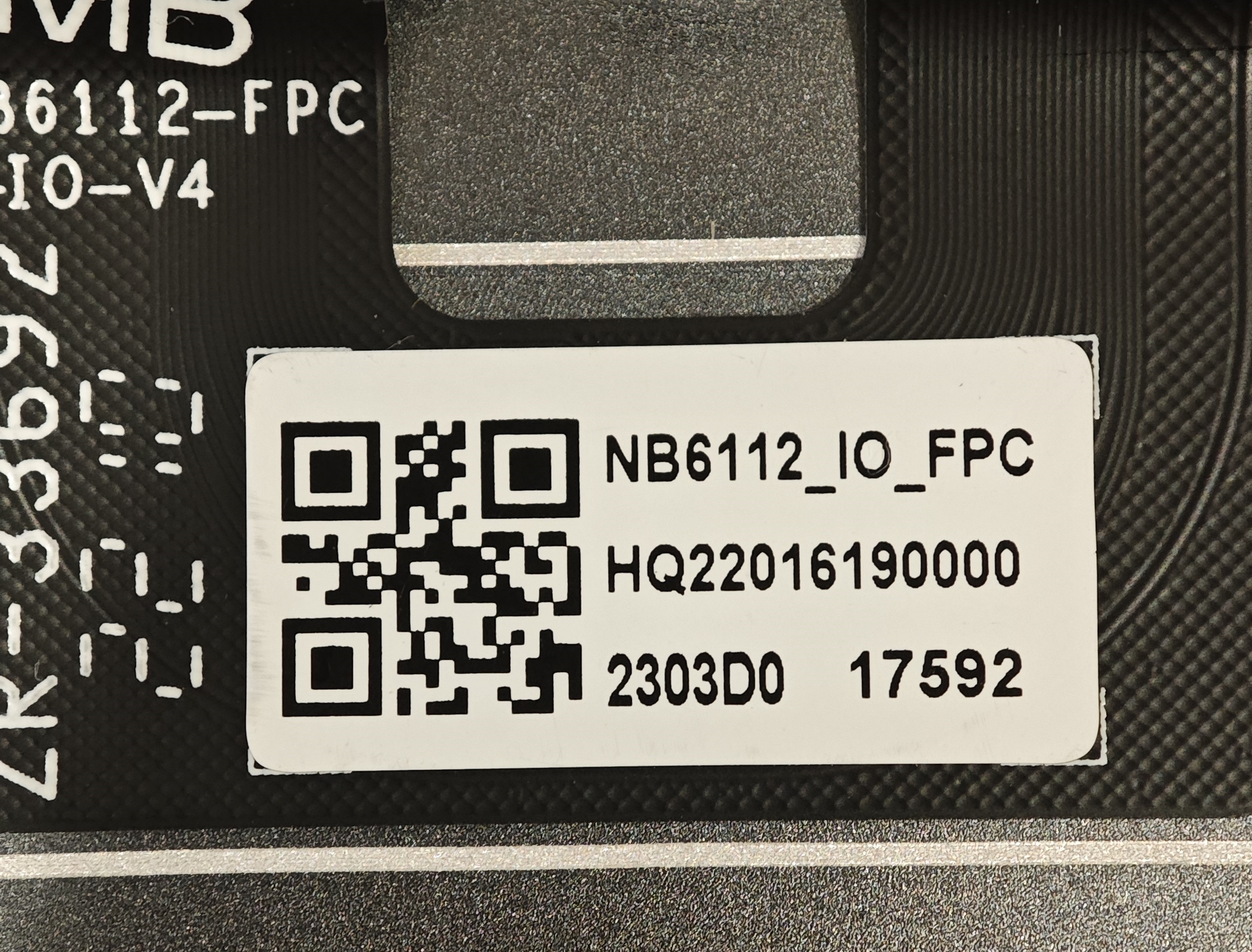

                                Hi. There is a xiaomi book pro 14 2022 laptop. We reset the BIOS password to zero and now it asks for a password when starting the laptop and will not boot into Windows, will not enter the bios. Are there any options to solve this? Or is it possible to force Windows to load?
                                • peste
                                  peste commented
                                  Editing a comment
                                  merged post..
                              • peste
                                • Dec 2016
                                • 13661
                                • ROMANIA
                                post the S/N, the original bios of the laptop, the motherboard model, etc.
                                • bacs
                                  • Oct 2024
                                  • 4
                                  • Russia
                                  Hello.
                                  S/N 40431/22TK00291
                                  I added a photo of what I saw. Is that it?
