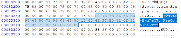

    I've bought laptop yesterday and found out that BIOS is locked with password.
    While I'm in process of contacting shop maybe there is a way to reset it?
    I've made BIOS dump with FPTW64, found the S.u.p.e.r.etc but can't decode text
    Please help with decoding Or may be there is another way of resetting it?
    HEX code: D2 76 FB 56 FA BD 95 45 5C 71 93 65 43 80 15 60 4E FC E0 51 0E 12 25 B2 75 B3 5C E6 5E 83
    BIOS dump is attached

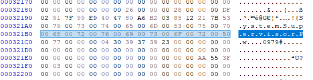

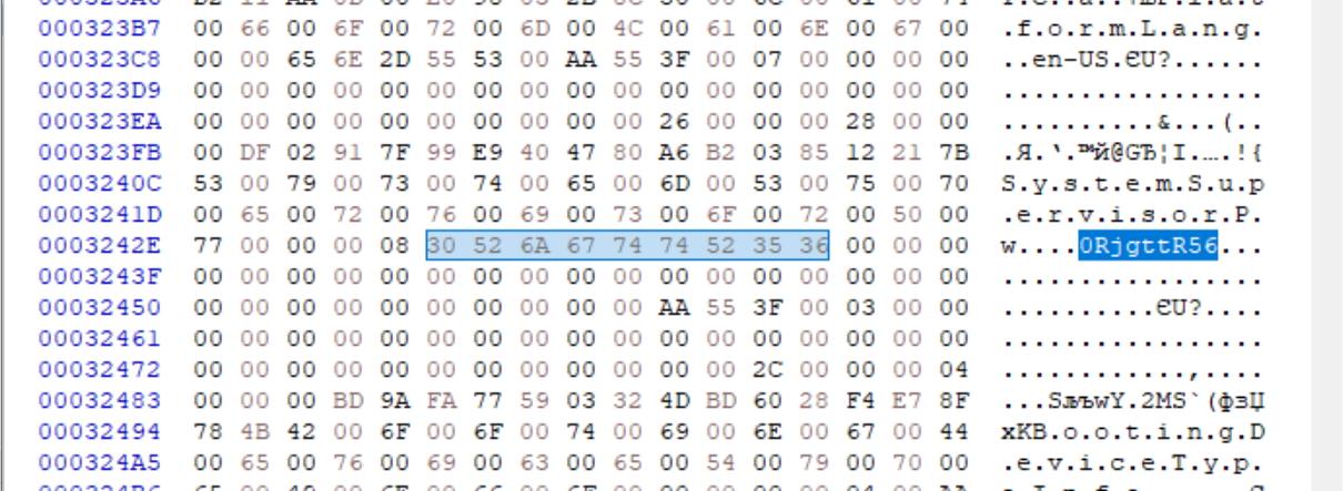

          I've been extracted bios dump by FPTW64 v15 (attached), open image by HxD editor and find password after 00 65 00 72 00 76 00 69 00 73 00 6F 00 72 00 50.
          As i see it must be "0RjgttR56" (pass in attached), but it wrong. This pass is not valid.
          The second way to extract bios backup is native utility from xiaomi to flash bios - "H2OFFT-SX64 backup.bin -g". I find this in C:\Users\{myusername}\AppData\Local\Temp\7zSB75C.tmp after extraction RMATG4B1P0F0F - latest available to loading bios version.
          But in those extracted backup password is also "0RjgttR56"
          Now i'm stuck.
          I don't know what to do next
          can someone help me?

                    do you use upper and lower case letters, how is the password ??
                    "0RjgttR56" and the first is zero, not "o" of course
                      Re: Xiaomi Redmibook Pro 14 2022 (Intel) BIOS password
                      Yes, of course
                      I have tried both methods through "Caps lock" and through "Shift" (left or right side also changed, suddenly one does not work)"
                      And that there is zero "0" I also understood, I watched the translation from Hex to ASCII
                      that's why I'm confused
