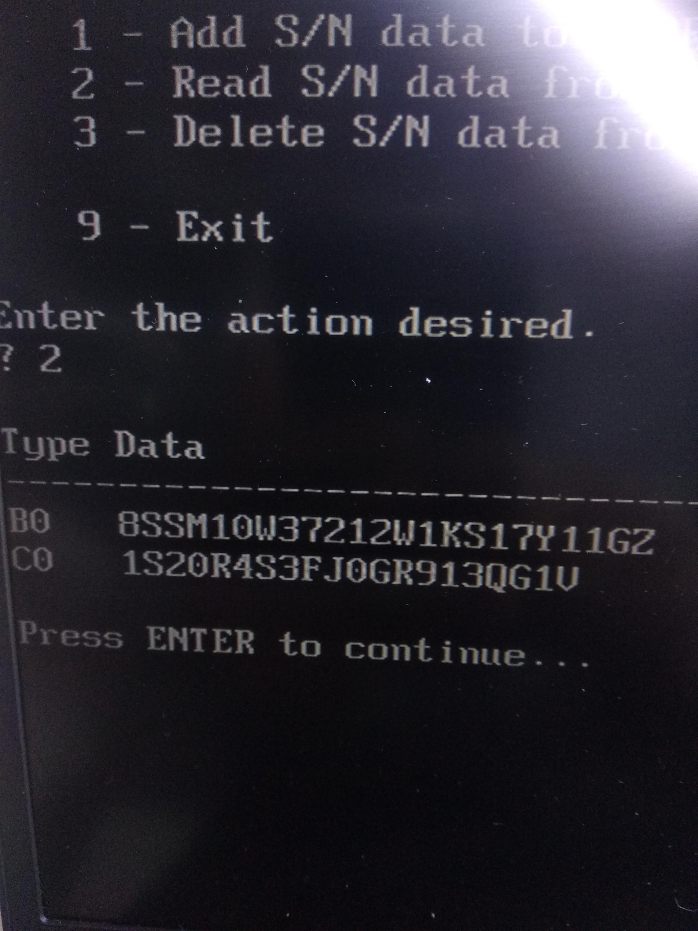

    i patched bios all work but i have Error 2204 :System configuration data is invaid.

                    try clear EC Dump
                    save serial info and others number
                    (picture of bios menu and read and save with photo block1 to 6 this utility)
                    clear ec dump with utility and restore number
                    the error is not linked to the serial number or the model. It is an error of a block where there is uuid I believe.

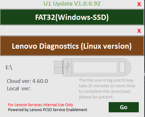

                          the U1 Key Updater software cannot format my Pendrive. when i click on format tool, a warning notice, telling me all Data on the selected usb will be lost, when i press continue my usb is still not formatted. all files are on it. what should i do

                            Try use format tools and copy content of U1 in usb key after
                                IT worked
