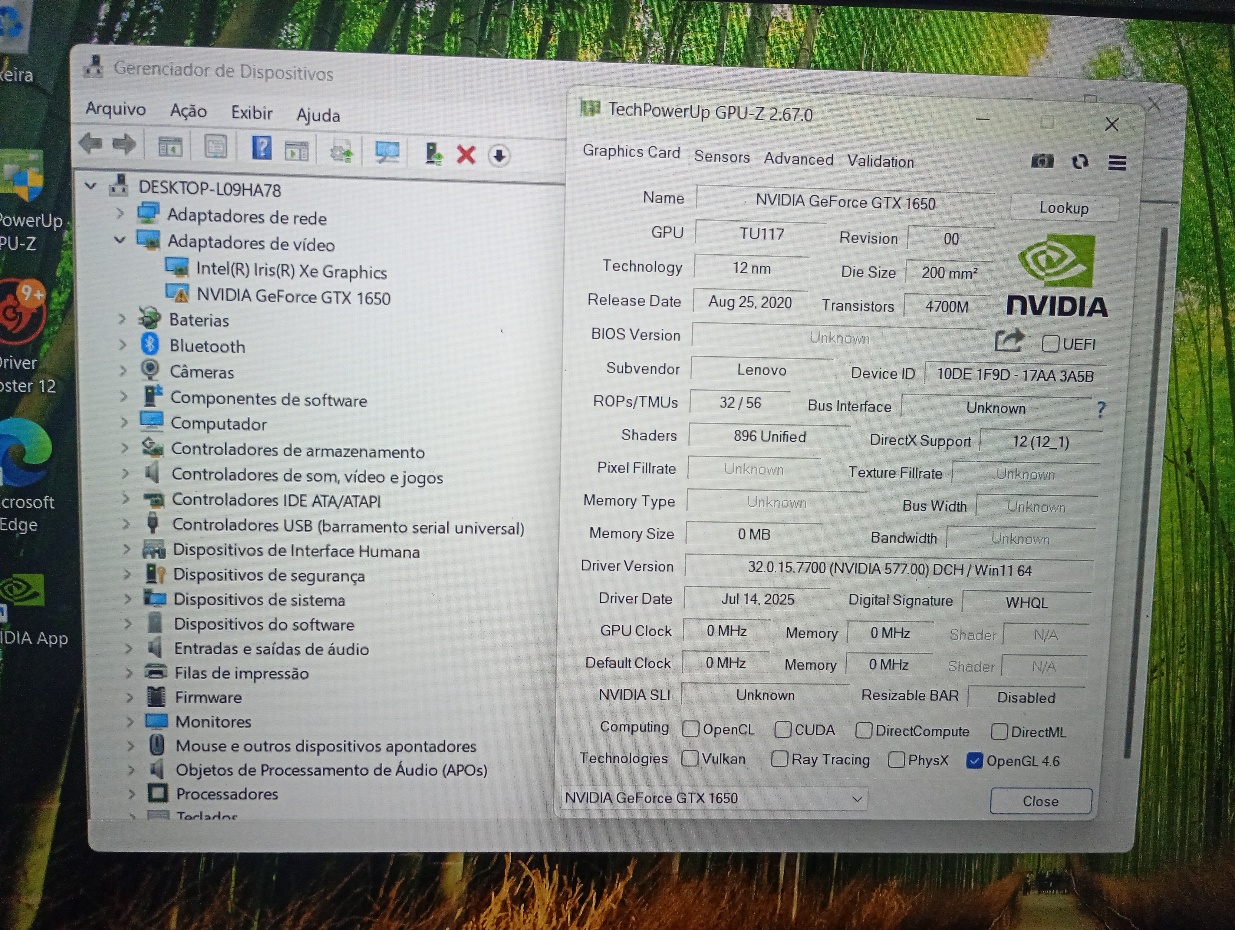

          Write Thais filé, but, card dont recognized any specificatiins....

                      Originally posted by m1ch43lzm
                      mateusassuncao you're lucky, the post by AJ_1 has the 1MB VBIOS you need for GTX 1650
                      AJ_1 flash the 8MB file from posts above, it contains the ME region
                      EDIT: Both GOG10 "A" and GOG10 "B" extracted BIOS are binary identical
                      Hi, tanks for reply!
                      The new chip I replaced has a different ending. The one on the board was a 25q80ewsig.
                      The one I installed is a 25q80BVSIG.
                      Could this be the cause of the GPU memory and BIOS version not being recognized? look for my print...
                      PS. In the file pack you sent me in A or B, there's a 160kb file. Would that be the one that would work with VBIOS?
                      This file is Vbios? 160kb?
                      I'll ask for another BIOS. As soon as it arrives, I'll save the .bin file... But, would it be the 1MB file a friend posted? Or yours that came in the 160KB pack? I saw that the GPU ID in gpu-z contains the file I attached. In this case, I'm not sure which one to use: your 160KB one or the 1MB one!
                        Use the original chip W25Q80EWSIG it's 1.8V flash chip, make sure your programmer supports 1.8V chips
                        Your replacement W25Q80BV is 3.3V, won't work, that's why it is not detected
                        According to schematics you can also use MX25U8035FM2I
                        Or take a similar BIOS chip from a dead GTX 1650/1660 or RTX 20xx series desktop GPU, check datasheet first
                        https://www.badcaps.net/forum/troubl...41#post3693541
                        Post 86, he has the same GPU GTX1650 as you, use AJ_1's "old 1mb.bin" file, that's why I said you're lucky someone with the same laptop made a copy of it
                        The one I attached In post 85 I downloaded from TPU, it may work but it's an older version
                        The 160KB file from hoaca388 post is for the EC, not needed

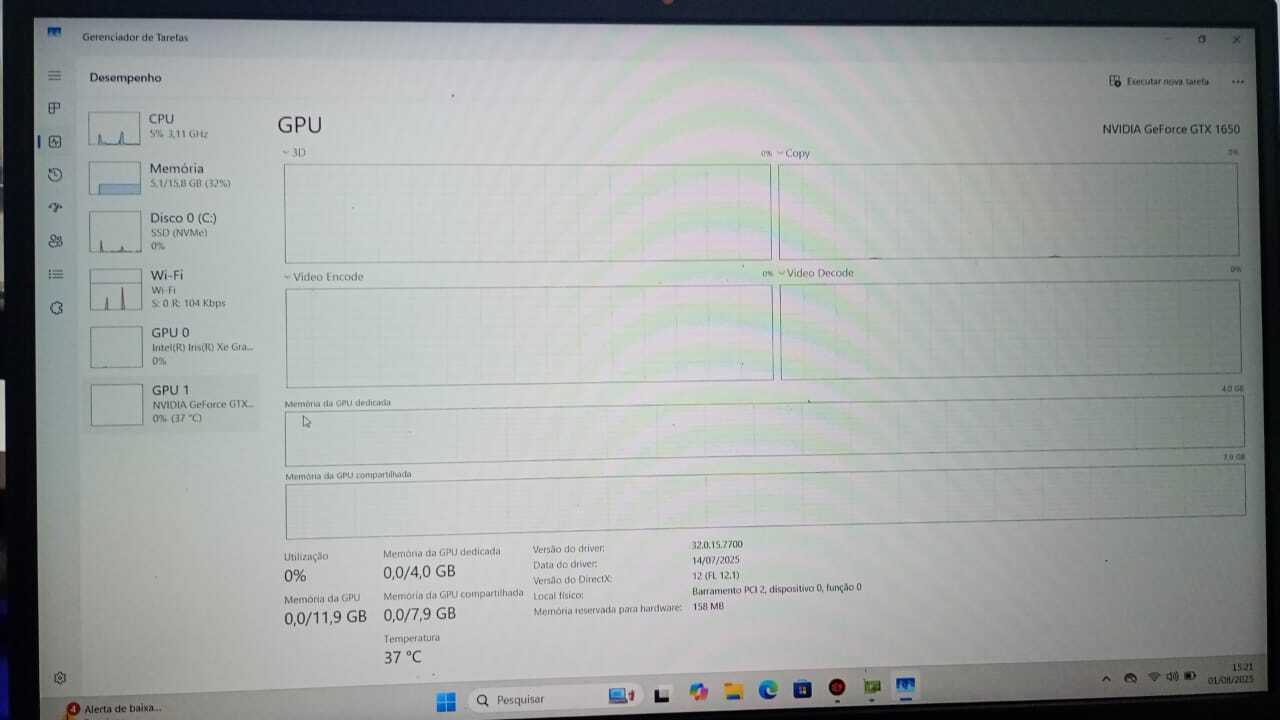

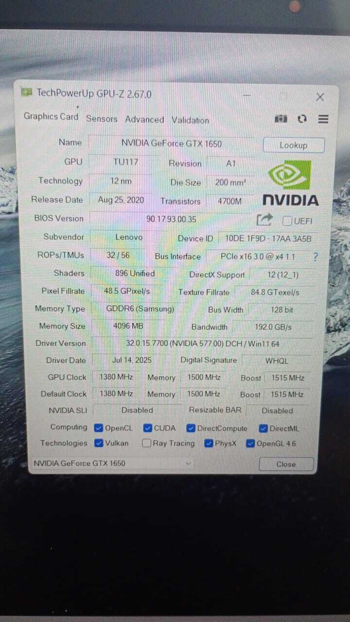

                                    As promised.
                                    Here are the screenshots!
                                    Many thanks to the colleagues who helped so much with the repair! Great community!
