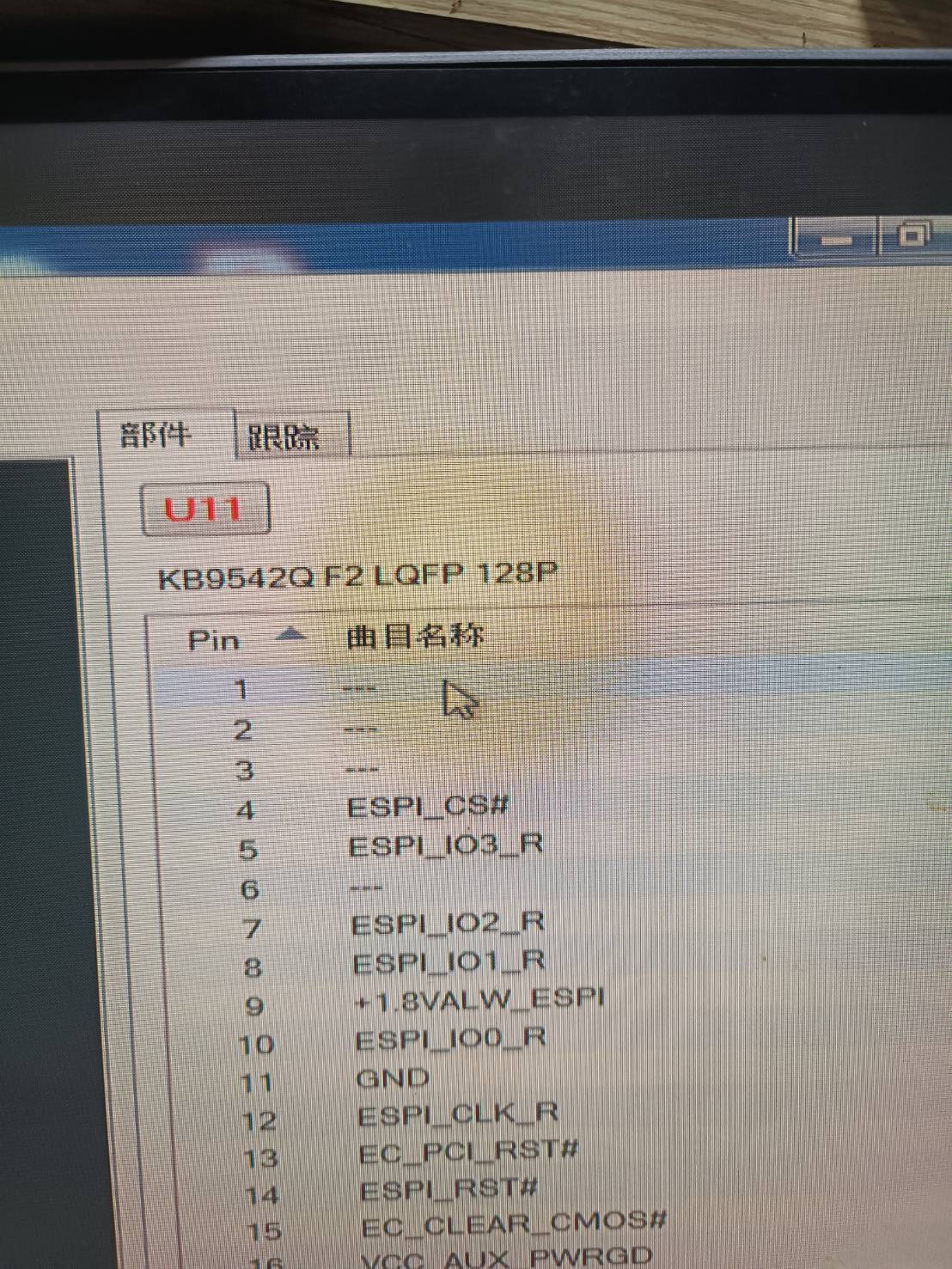

            NEED EC BIOS BIN FOR LA-L161P REV:1A.
            my ene kbc was faulty
            s/n : SMP26GBH5
            mtm : 82K10172TW
            Because it can no longer be turned on, so this is the only information

                #107
                Originally posted by hoaca388
                Ene kbc
                s/n : SMP26GBH5
                mtm : 82K10172TW
                KB9542Q F2 LQFP 128P for BIN 24mb
                thank you

                  #108
                  Ene kbc
                  Hello, my masters, Thank you very much. The problem has been solved successfully.
