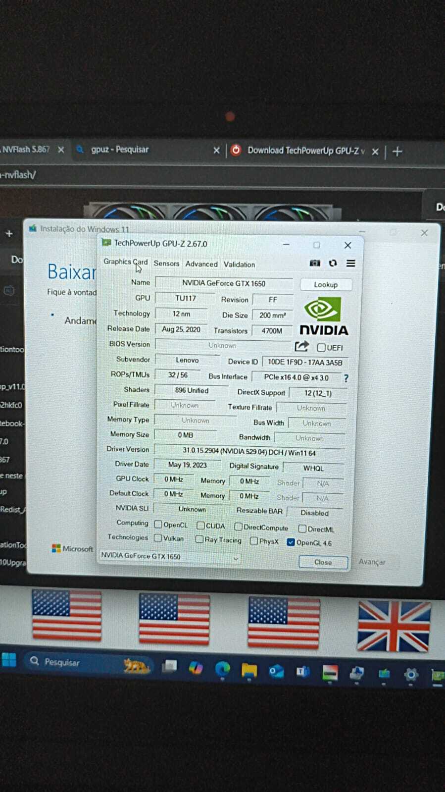

                                    #78
                                    I sang victory too soon...
                                    The GPU was recognized, but with glitches. Look.
                                    Does anyone have any tips?
                                    Could it be the BIOS?
                                    The blessed 160kb 25q80?
