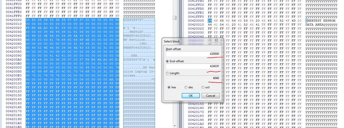

    looking for working Bios file
    attached backup original file charging light blinking white,
    press power switch, nothing happening
    please help

      Try this one, it's from hp website.

        Adding the DMI only takes a minute.All HP insyde bios have DMI / Wkey thats easy to copy/paste to a virgin bios,no need to use HP`s shitty DMI tools.

          Here is the new one.

            Nice,you got everything, serial - featurebyte -win key etc

              I have extracted the whole content of the first padding using UEFITool
