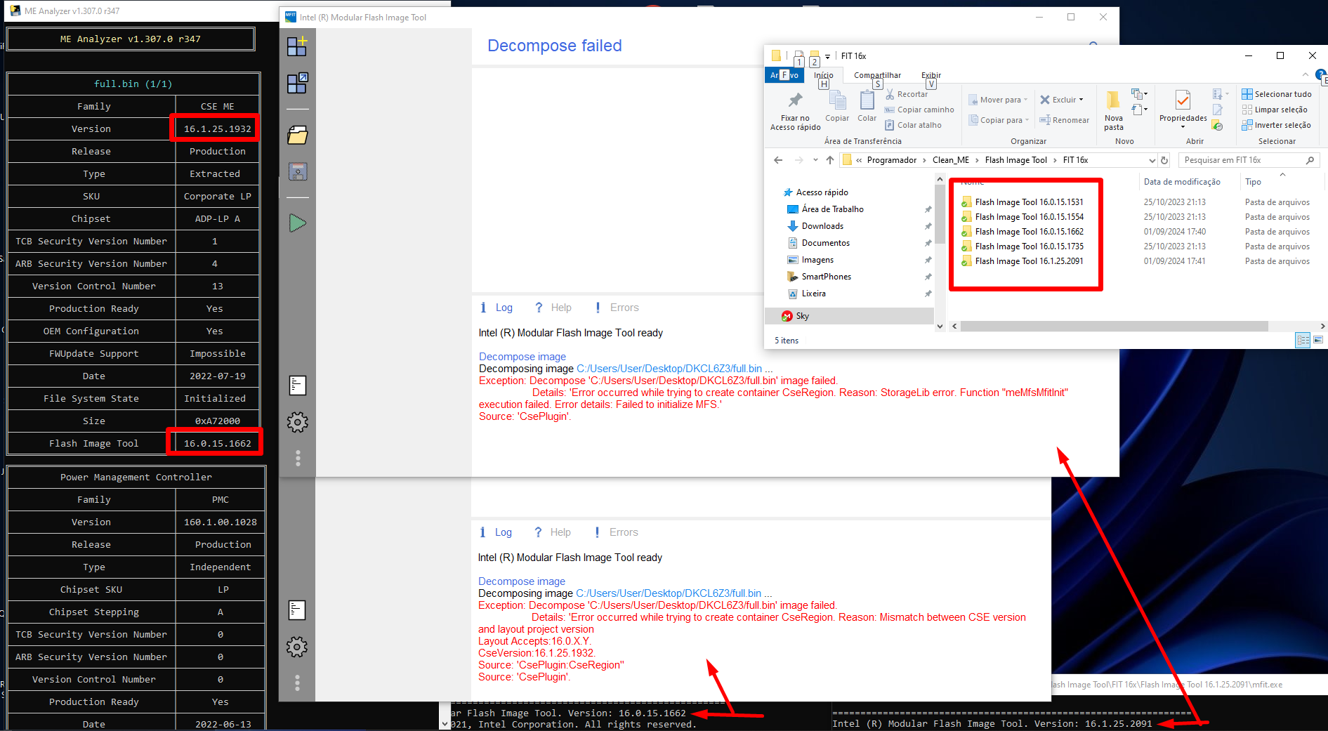

        Please help me rebuild bios for Latitude 5430
        The equipment is no longer turning on after an attempt to remove the bios password, I believe the file was corrupt because it doesn't turn on even with the original dump! It just turns on the power key led and turns off after a few seconds.
        MB: LA-L591P
        ST: DKCL6Z3
        Attached : bios (16Mb+32Mb)
        Attached : Bios Region and ME FW extracted from bios.
        Thank you!​

          is the board labeled as HDB42 LA-L591P REV 1.0(A00) 2022-01-13 ???
          • santoslao
            • Apr 2017
            • 101
            • BZ
            #345
            Exactly!

                  #348
                  MB: LA-L591P
                  ST: DKCL6Z3
                  Thank you!​
                  I still need this if anyone can help I would really appreciate it.

                    #349
                    try this one
                    • santoslao
                      • Apr 2017
                      • 101
                      • BZ
                      #350
                      try this one
                      It doesn't work, I had already tried to insert another file into the machine, this file the machine only lights up red when the power button is pressed. This file contains a version 1.7.0 of the bios the bios file that I posted is in a version 1.13.1 and is corrupted as I mentioned, I
                      • santoslao
                        • Apr 2017
                        • 101
                        • BZ
                        #351
                        If someone could at least explain to me how I can rebuild it myself, I would be very grateful too. The machine has an ME with a version above the FIT that was used to build it. And when trying to open the file in mFIT it gives errors in both versions.
                        • santoslao
                          • Apr 2017
                          • 101
                          • BZ
                          #352
                          I would like to inform you that with a lot of persistence I managed to rebuild the machine's bios and now it is working again.

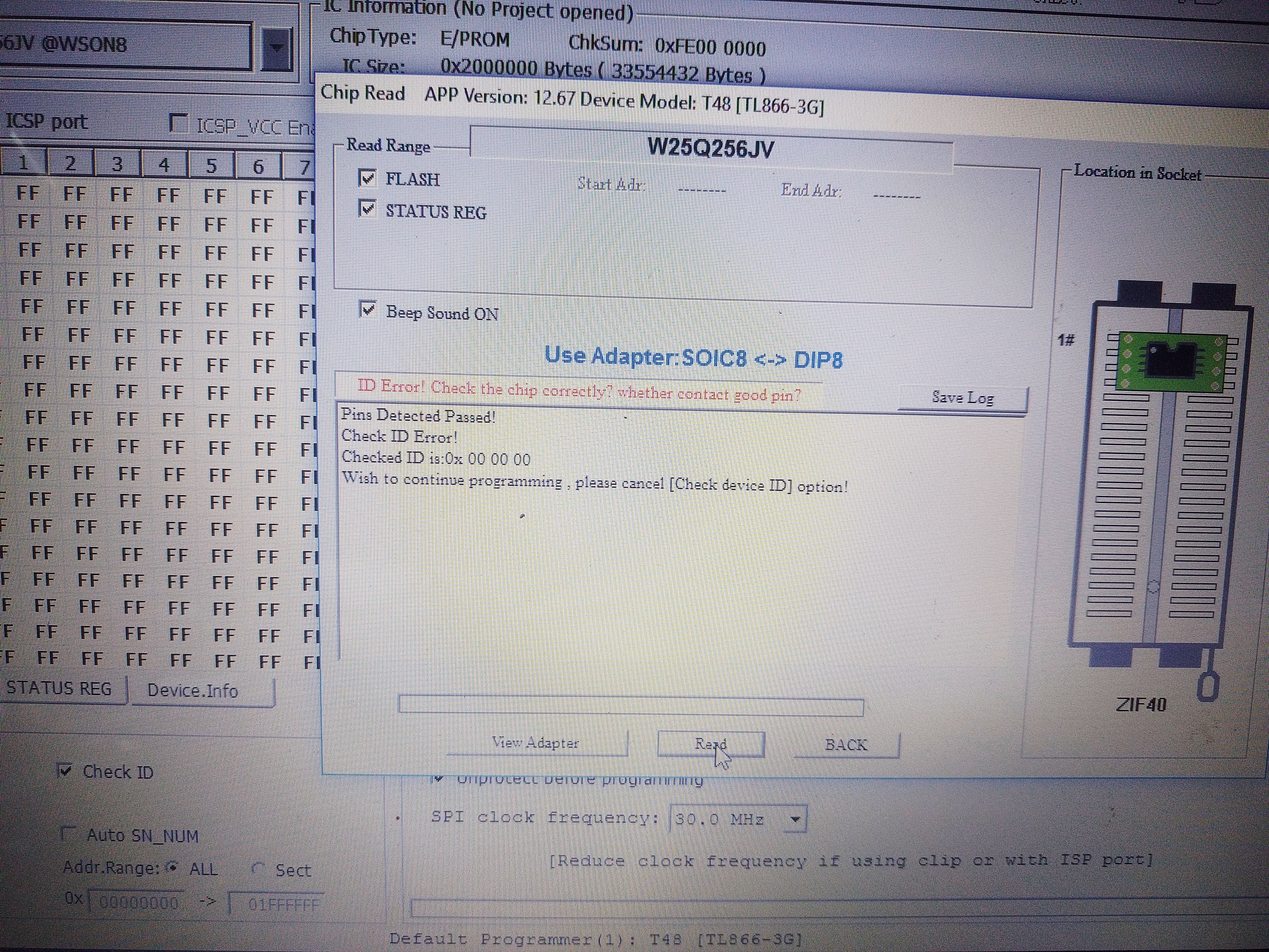

                            #353
                            Hello
                            Please need help to unlock bios Dell latitude 5430
                            Motherboard: HDB42 LA-L591P Rev:1.0(A00)
                            i7 1265U 12th gen
                            UC2 Winbond W25Q256JVEN
                            UC6 Winbond 25R128JVSN.
                            Service Tag 5Z1SDK3-0001
                            Thanks​

                              • F6 Solutions
                                • Jul 2024
                                • 9
                                • Cameroon
                                #355
                                Ok
                                When I try to read chip on board having error
                                • santoslao
                                  • Apr 2017
                                  • 101
                                  • BZ
                                  #356
                                  Originally posted by F6 Solutions
                                  Ok
                                  You need to remove the chip from the board, this equipment does not support reading with a soldered chip.
