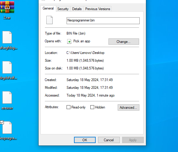

                  Thanks for the reply, i even solder the chip to CH341A and i can read. When i save the capacity is 1 MB.
                    • 21444
                    #290
                    Don`t use the programmer Auto-detect ,choose the chip manually. Are you using the recommended NeoProgrammer software ? .What is the part number on top of the chip

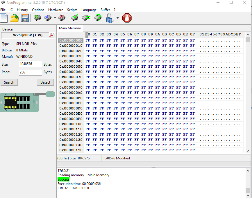

                      #291
                      I used Asprogrammer and Ch341a V2.2.0.0 both gives the same result. The part number is W25Q80BV

                        #292
                        I just did with the Neopragrammer and still 1MB
                          • 21444
                          #293
                          W25Q80BV is not the bios chip,it is somewhere else on the motherboard

                            #294
                            Ups, Thank you. I will try to locate it
