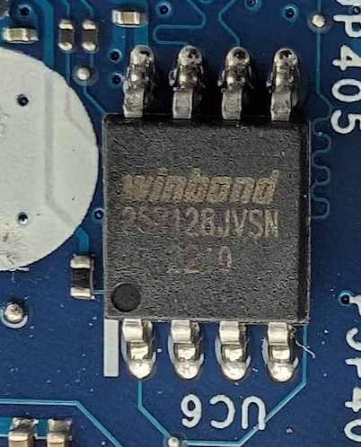

                          Hello all,
                          Managed to take out the bios chips and extracted the bins.
                          laptop / DELL LATITUDE 5430 /
                          motherboard / DHDB42 LA-L591P /
                          cpu / INTEL i7 12TH GEN /
                          service tag / #5TN3RV3-8FC8
                          spi chip / WINBOND 32MB@WSON8
                          winbond 25R128JVSN
                          and
                          winbond 25Q256JVEN
                          I need to remove the BIOS password and the computrace.
                          Can anyone help me pls?
                          Thank you.

                            #313
                            Originally posted by Valentin Florin Benciu
                            Hello all,
                            winbond 25R128JVSN
                            and
                            winbond 25Q256JVEN
                            Thank you.
                            try
                            • Valentin Florin Benciu
                              • Apr 2024
                              • 8
                              • Romania
                              #314
                              Originally posted by danito
                              try
                              this covers both problems?
                              the UC6 bios chip doesn't need anything to update it?
                              • danito
                                • Jun 2016
                                • 898
                                • Romania
                                #315
                                Just UC2. Don't touch the other.

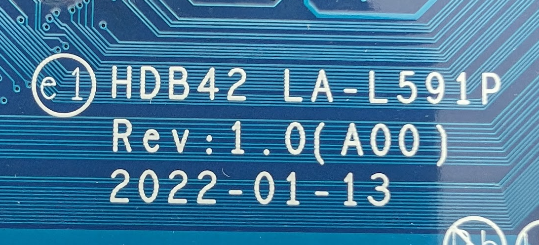

                                • jadao
                                  • Sep 2015
                                  • 10
                                  #316
                                  Hello, can someone help unlock this bios please?
                                  Service tag: 3Y6GWT3
                                  HDB42 LA-L591P Rev: 1.0 (A00) 2022-01-13
                                  Attached UC6 and UC2 dumps
                                  Thanks in advance!
                                  • hoaca388
                                    Badcaps
                                    • Jan 2022
                                    • 11669
                                    #317
                                    Thanks in advance!
                                    KKK
                                    • jadao
                                      • Sep 2015
                                      • 10
                                      #318
                                      Originally posted by hoaca388
                                      KKK
                                      Works great thank you!
                                      I have a bunch of them with same password, is there a way to retreive the password or I need to do them one by one?
                                      Thanks agin
