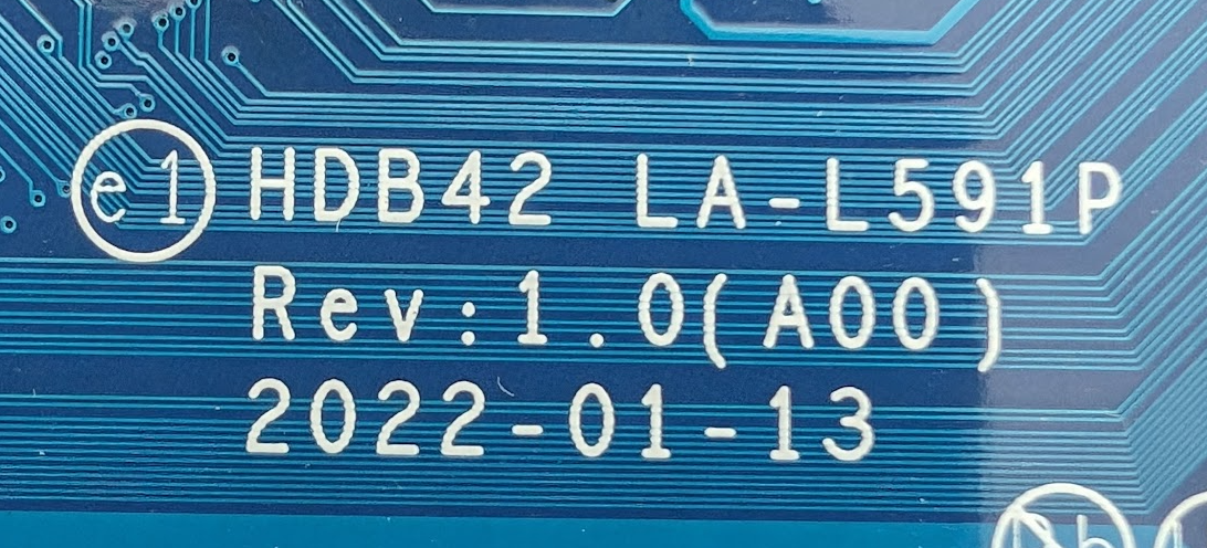

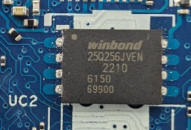

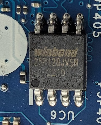

                                          Hi. I'm having problems unlocking the BIOS/Computrace for this particular model. I've successfully been able to unlock earlier models (e.g.: 5420, 5310, etc.). I've tried with more than 1 laptop of this model, and I'm having the same problem with all of them.
                                          Information:
                                          • Model: Dell 5430
                                          • Board version: HDB42 LA-L591P Rev 1.0 (A00)
                                          • Service Tag: FVWGSQ3
                                          • UC2 and UC6 dumps attached
                                          I'm using:
                                          • T48 TL866-3G Programmer with Xgpro v12.66. I tried with 2 programmers (same model), but got the same result.
                                          • WSON 8 POGO Probe for the UC2 Winbond 25Q256JVEN chip. Using W25Q256JW@WSON8 on Xgpro.
                                          • SOIC8 Clip for the UC6 Winbond 25R128JVSN chip. Using W25Q128JV@SOIC8 on Xgpro.
                                          I'm not desoldering the chips, but reading/writing them on the board.
                                          If I try to read the chip contents with the Lithium Ion battery/charger disconnected, but the CMOS battery connected, every reading of the chips has different hash/crc values. After I disconnected the CMOS battery, the readings always matched. This doesn't happen with other models.

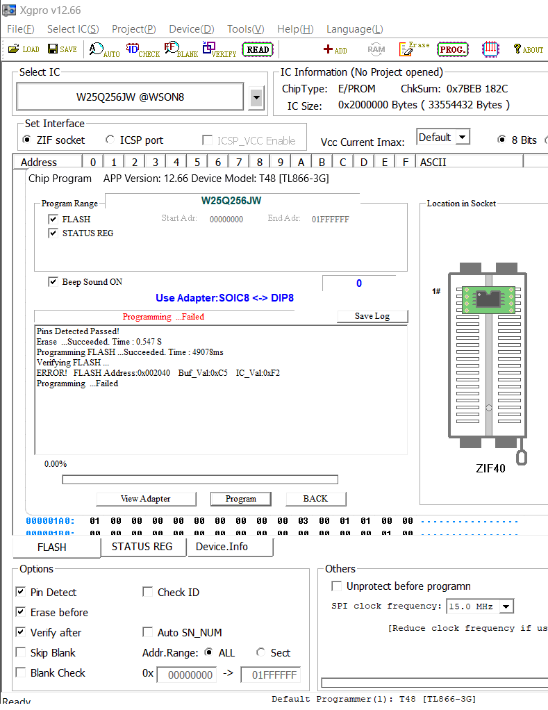

                                          On Xgpro If I try to read the UC2 chip contents with W25Q256FV@WSON8 or W25Q256JW@WSON8 the values returned are all 00 . With W25Q256JW@WSON8 it seems to be able to read the contents correctly.
                                          The problem is that when I try to write a bin file to the UC2 or UC6 chips, it:
                                          • "Erases" the chip in half a second. This is too fast compared to other chips. It normally takes about a minute to erase a 32MB chip.
                                          • After the content is written to the chip, it fails on the verification. The time it takes to write the bin to the chip is the usual.
                                          • If I read the chip contents after writing to it, it has a different hash value than the file that was used for programming. I haven't actually compared the content. This is happening on both the UC2 and UC6 chips. The laptop does power on afterwards, but it's still locked.
                                          Has any one been able to successfully program this model without desoldering the chip? It sounds like there's some sort of protection when the chip is on the board.

                                          Click image for larger version  Name:	Error programming.png Views:	32 Size:	90.2 KB ID:	3292664
                                          Error programming if "Verify after" option is selected.
                                          Click image for larger version  Name:	Ok programming without verification.png Views:	70 Size:	88.3 KB ID:	3292653
                                          No error programming if "Verify after" option is not selected, but chip content hash/CRC doesn't match with original file.
