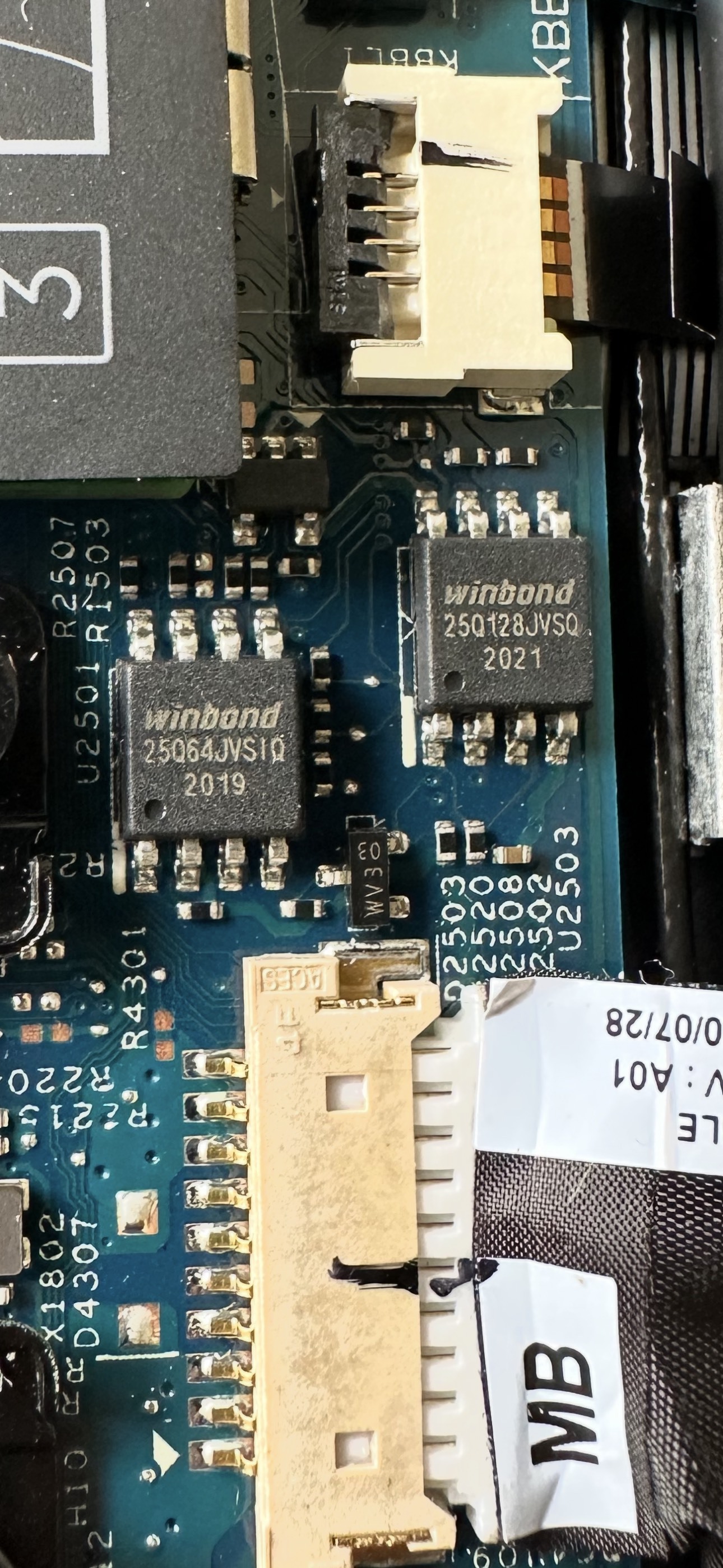

    hello,
    i tried to delete the bios password via clean 8 mb file and replacing the managment engine with the old one from the locked dump.
    now the system reports that it's in the manufactuting mode state. i can't quit this mode with alt-f, it's coming back every restart. tried different dumps (and searched for solutions), but the error remains even though the password is gone. can anyone help please? attached the original files.

          Hello, i really need someones help with my bios to unlock it has an 8fc8 lock
          i made an bios dump of both chips 64/128
          service tag 14vc403
          already thanks in advance
          Frank

          Big thanks for your reply and help is this file for the 64 or 128 chip ?

            Flash this to the 64 chip
            1st boot, press F2, write service tag, disable Absolute, save (Apply changes), restart. 2nd boot press Alt+F to exit manufacturing mode

              Thank u for the fast reply and help i really appreciate it big time. I solved it with your unlock.bin and steps thanks
