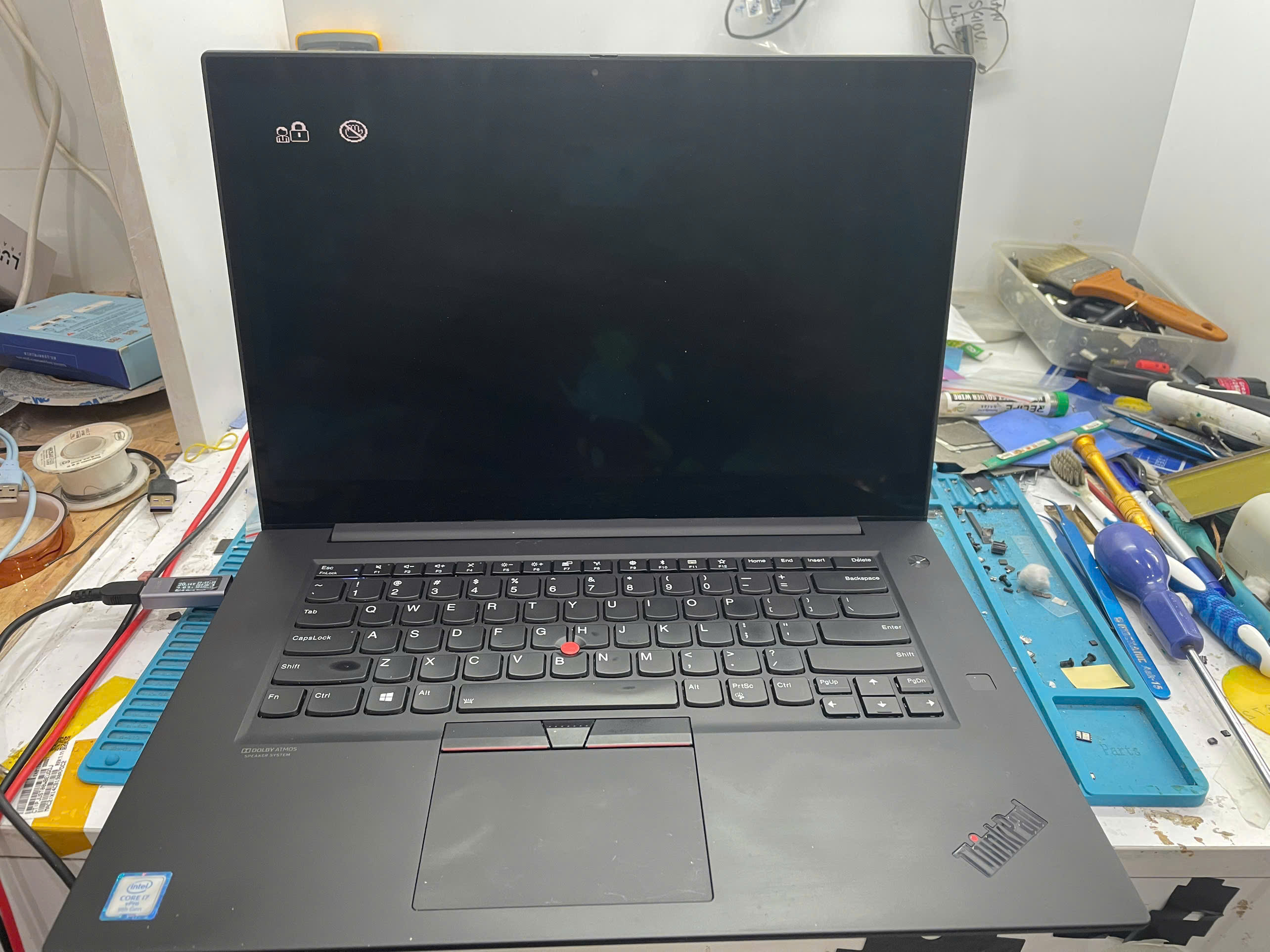

                          #32
                          Hey guys.
                          There's a Thinkpad X1 Extreme 2nd on the bench, asking for a supervisor password... any solution? I tried other dumps from this topic, but the machine doesn't turn on.​
                          in attachments original dumps ( working dumps but ask por password )
