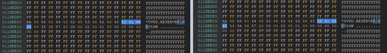

                      • igragon08
                        • Sep 2022
                        • 52
                        • madrid
                        #131
                        Thank you very much for writing to me, Hoaca388. I appreciate your time and trouble! You're the best.
                        I'll share the tests I performed with the image you provided:
                        When I turned on the PC, the following message appeared on the screen:
                        -Self-healing BIOS Backup Progressing...100% (when the progress reached 100%). The PC restarted and displayed the following:
                        0271: Check date and time
                        0183: Bad CRC on security settings in EFI variable
                        And then I pressed F1 to enter setup.
                        When I pressed F1, it next asked me for the supervisor password, and I tried 0000, 1234, and 1111, but it didn't work. I couldn't enter the BIOS setup.
                        It didn't work for me with the AC charger either, but I'm starting to suspect it's more of an electronic issue than a BIOS issue. I think something must have gone wrong on the motherboard, but I still have the battery to test if you'd like to send me any more pictures.
                        Thanks again!!!

                            • hoaca388
                              Badcaps
                              • Jan 2022
                              • 12243
                              #134
                              Originally posted by igragon08
                              Sorry, but I don't understand what you're trying to tell me, hoaca388, about the BIOS password.
                              Super Input/output
                              • igragon08
                                • Sep 2022
                                • 52
                                • madrid
                                #135
                                Okay, I understand what you're trying to tell me is that the BIOS supervisor password isn't in the dump/image of the 25R256JV BIOS chip, but is stored on the ITE/NUVOTON/LENOVO chip on the bottom of the motherboard. Is that correct? Because if so, there's something wrong with me. Let me tell you:
                                Flashing the image you provided in the post, it asks for the BIOS password, as I told you, and I haven't been able to enter the BIOS setup because none of the ones I've set work (luckily, I've been able to find the password I had set), but I set it, and it still doesn't work.
                                So I re-flashed the original BIOS image (25R256JV), which I read about at the beginning, and everything works correctly, but with the supervisor password, as it was at the beginning (since I was able to find the password I had set), I entered it and was able to enter the BIOS setup and make adjustments... and everything is fine!
                                So, my question is:
                                Why didn't my real password work on the image you provided? If it's actually saved on another chip, like an ITE chip, shouldn't any BIOS dump/image work with the password set on the device itself, saved on that chip?
                                I mean, I write the image/dump you provided with a password. Shouldn't it work if I enter my password saved on the device when it asks for the supervisor password? In other words, shouldn't my password work with both my original dump/read and the dump/read you provided? Or shouldn't your dump/read that you provided work with a password that you know works with that image/dump?
                                I hope you can answer my question as clearly as possible, since I'm still learning by reading your forum... reading various posts from other users... I know I still have a lot to learn and understand, and little by little, I'll be gaining knowledge with all of you...
                                Thank you very much!!!

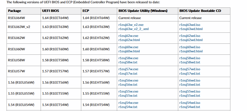

                                • Maxpower3
                                  Bad Veteran
                                  • Feb 2018
                                  • 1316
                                  • France
                                  #136
                                  So, my question is:
                                  try to find a R1EET58W version, the one provided is a R1EET64W
                                  Click image for larger version  Name:	image.png Views:	0 Size:	6.3 KB ID:	3670707
                                  Click image for larger version  Name:	image.png Views:	0 Size:	86.2 KB ID:	3670700
                                  may be variations in LenovoMultipleKeyboardService which replaces TranslateService
                                  I have already exchanged TranslateService and the password no longer matches afterwards.
