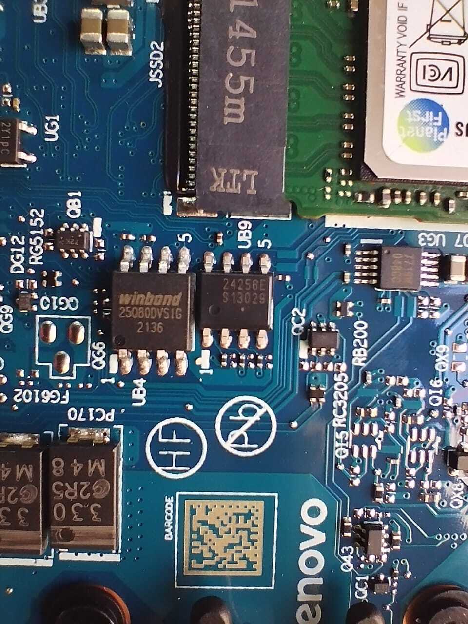

    Originally posted by hoaca388
    This is not bios chip
    Thanks I have 2 chips: 25Q80DVSIG and 24256E
    Which is the BIOS chip?

      Hi I need BIOS of: Lenovo E15 Gen 2 (Type 20TD, 20TE) Laptop (ThinkPad)
      Serial: PF-3BAFDT
      Memory 25Q80DVSIG
      My BIOS its corupted
      I download fron Lenovo the BIOS but i have an archive format .FL1 attached
      Please someone can help me to extract the .BIN File from .FL1 file ?​
      • Vesko356
        Vesko356 commented
        Editing a comment
        Did you read Hoaca388's reply?
        This is not the bios chip (24256E also).
        How do you plan to use the "extracted .bin" since you can't even find the exact bios chip?

      #43
      Thanks for the response, I'm sure the BIOS is stored in: 25Q80DVSIG
      PC: Lenovo E15 Gen 2 (Type 20TD, 20TE) Laptop (ThinkPad)
      Serial: PF-3BAFDT
      My PC shut down during a routine Windows update and the screen is now black.
      Now it doesn't turn on, it just turns on a sequence of lights.
      Could someone repair my corrupted BIOS file please?

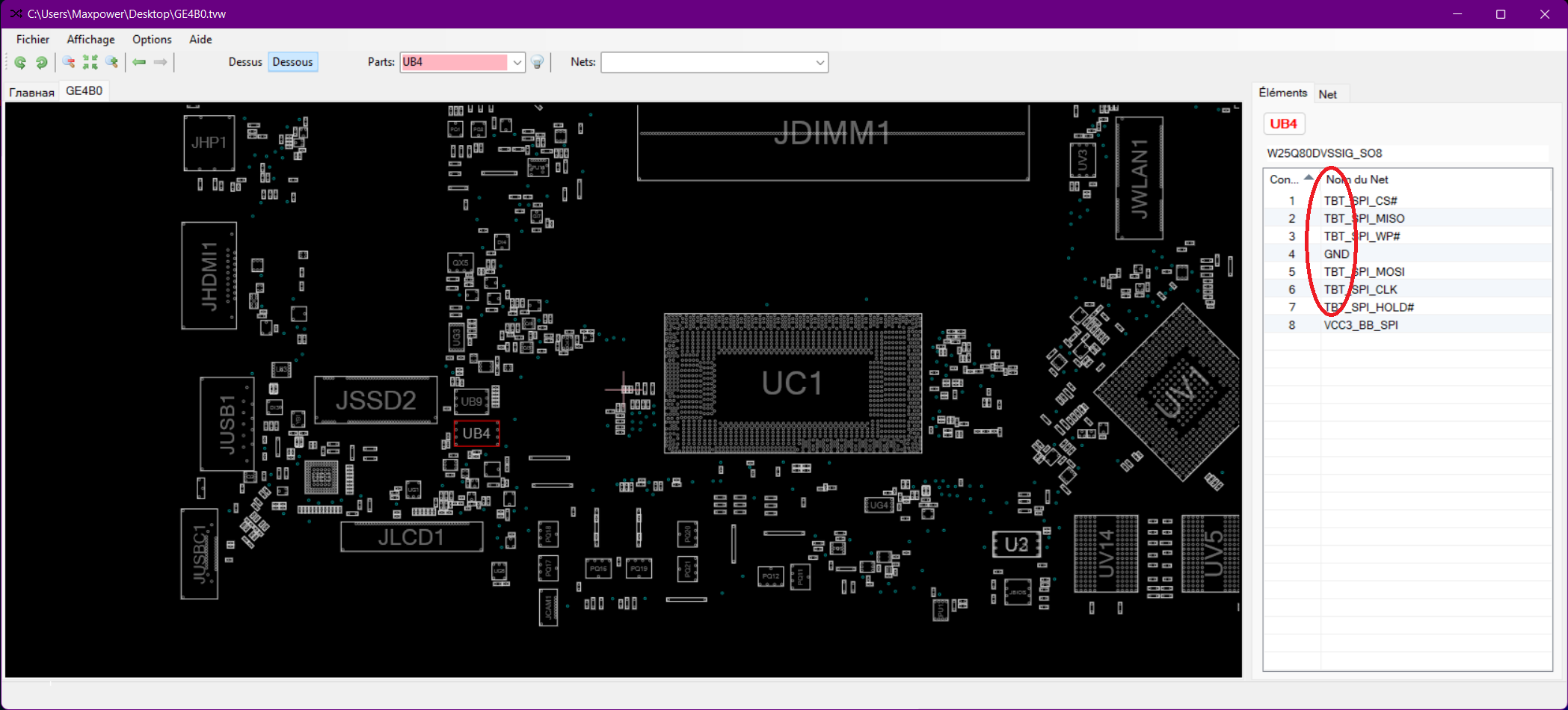

              #47
              Originally posted by bernalqz
              Is it possible that someone can help me repair that BIOS?
              Click image for larger version  Name:	Nouveau Image bitmap.bmp Views:	0 Size:	5.70 MB ID:	3225910
              as everyone said, it's not here
              Boardview link -> https://www.badcaps.net/forum/troubl...69#post1725869

                #48
                Thank you very much Maxpower3, for the electronic diagram, I was now able to recover the PC using the BIOS files attached to this Forum.
                By the way, I share with you the BIOS that I read with the CH341A once it was updated to the latest current version stored in: winbond 25R256JVEN​
