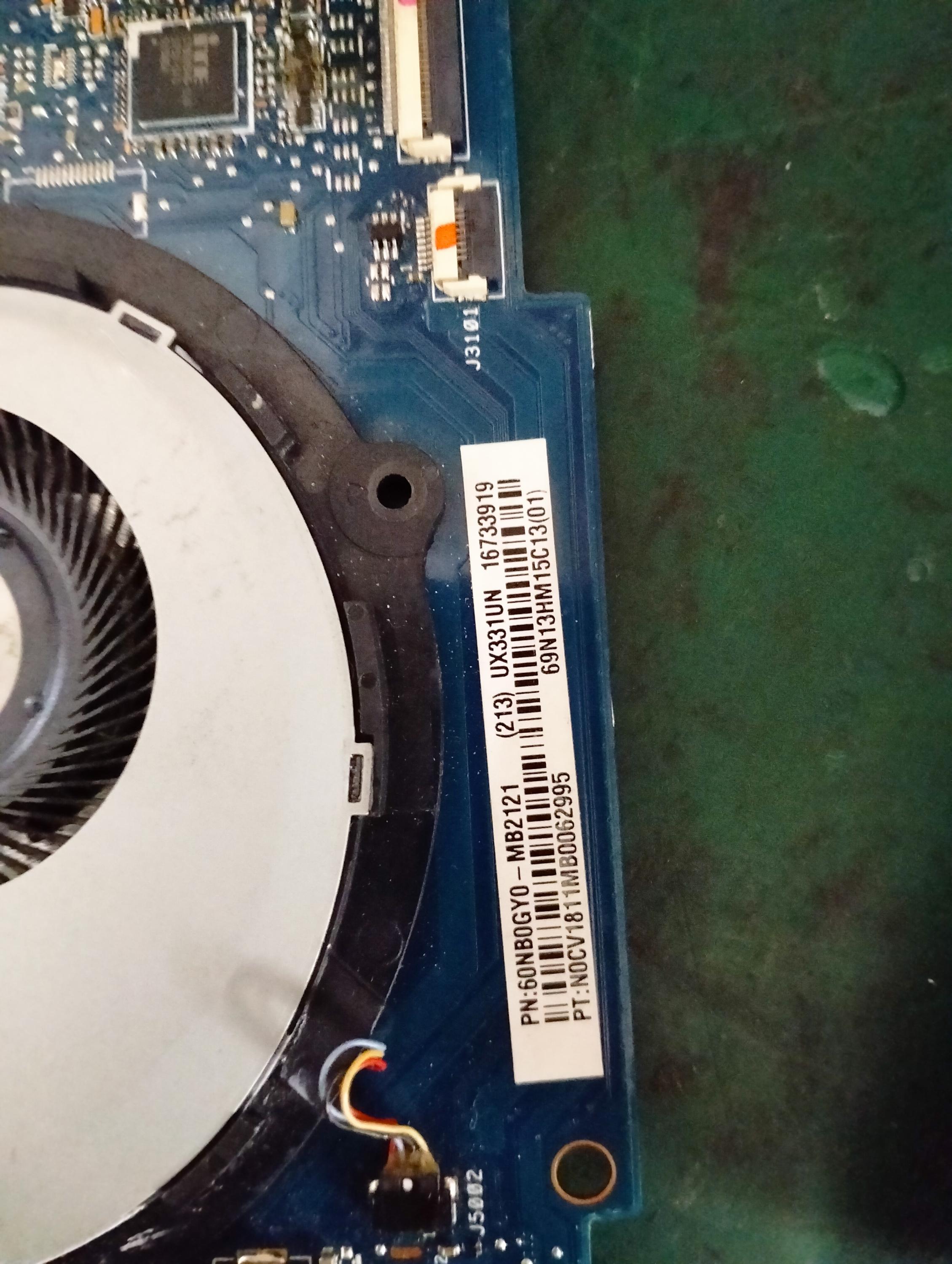

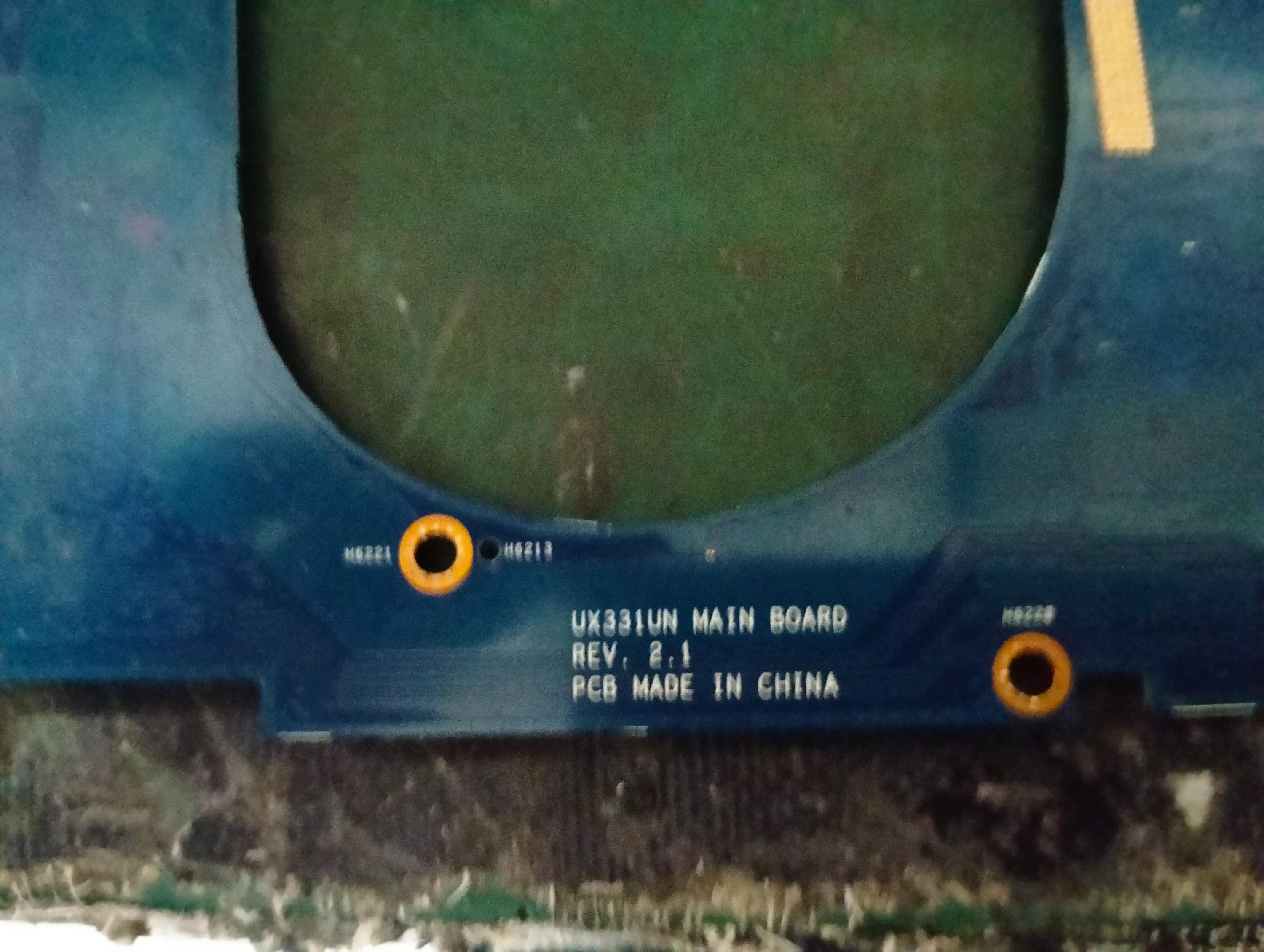

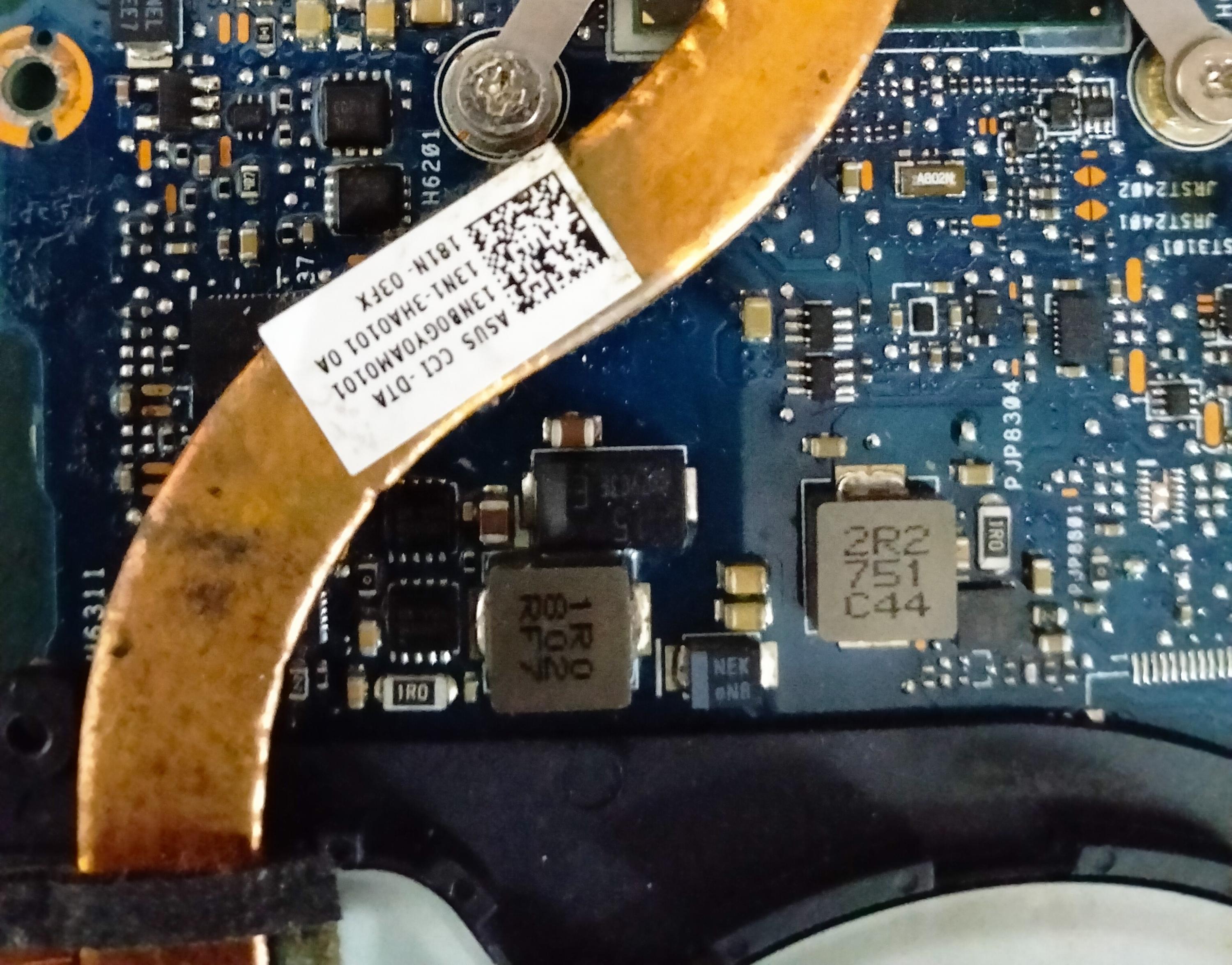

    Post the laptop serial number.Also post pictures of any white/green barcode stickers,or square white QR codes on the motherboard

      serial number can't be read on the case, and only that, nothing else

            i think this is your bios but without sn i cant be sure

                If you have "ux331un" on the barcode sticker like the one in the picture at post #3 you can use the bios from post #6 its an F1 Asus service bios

                    If you have "ux331un" on the barcode sticker like the one in the picture at post #3 (not the one on the heatsink,the one on the motherboard,3rd picture) you can use the bios from post #6 its an F1 Asus service bios. If that bios doesn`t work you have a hardware problem.
