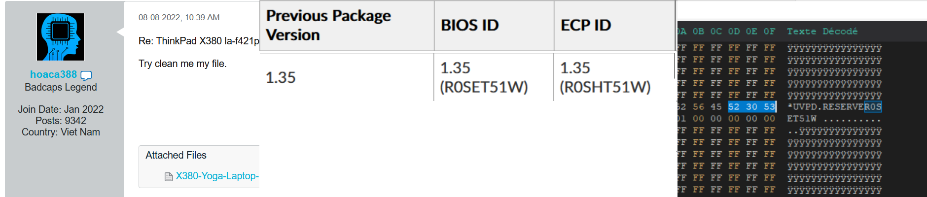

Hello try ....
ThinkPad X380 la-f421p rev 1.0

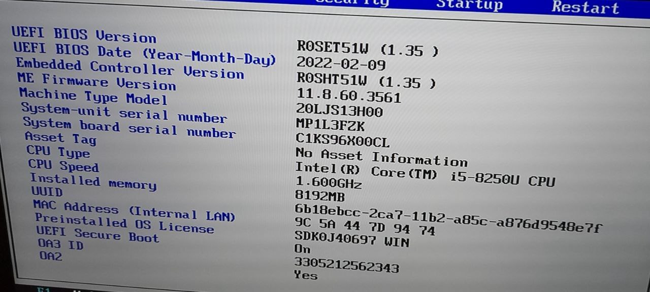

Update:
Sorry for bothering , I forgot that i have a taken a photo of the bios menu with all the information before doing the shorting method to bypass password. The problem may lie between the bios chip and the EC chip. Is it possible to get a bios bin and EC bin please ? Thank you in advance
UEFI BIOS Version: ROSET51W (1.35)
UEFI BIOS Date (Year-Month-Day): 2022-02-09
Embedded Controller Version: ROSHT51U (1.35)
ME Firmware Version: 11.8.60.3561
Machine Type Model: 20LJS13H00
System-unit serial number: MP1L3FZK
System board serial number: C1KS96X00CL
Asset Tag: No Asset Information
CPU Type: Intel(R) Core(TM) i5-8250U CPU
CPU Speed: 1.600GHz
Installed memory: 8192MB
UUID: 6b18ebcc-2ca7-11b2-a85c-a876d9548e7f
MAC Address (Internal LAN): 9C 5A 44 7D 94 74
Preinstalled OS License: SDK0J40697 WIN
UEFI Secure Boot: On
0A3 ID: 3305212562343
0A2: Yes​

Ok , so for flashing the EC file , I had to use the Vertyanov programmer and connect to the EC chip by using the keyboard port ; I read the dump 3 times and saved as many file in order to have a correct copy ; I then flashed the EC chip with the file provided and made sure that the file was correctly inputted in the cheap by reading again. Unfortunately, the laptop, when power on , light capslock, escape, F1 and F4 button then powers off; i have provided here the ec dump i got from the EC chip originallyAttached FilesComment
the files seem to correspond to the structure. I would like to have more normal information.
SER/USR and CON look correct too.
The content is almost identical apart from the 00 and FF which changes.
So for me the file should work.
Maybe at 870, half at 00 and the other half at FF. but nothing crazy
It's late, I'll watch more tomorrow.
Have you tried the bios also provided at the same time as the EC?
Have you seen a change in the habitual symptom?Comment
