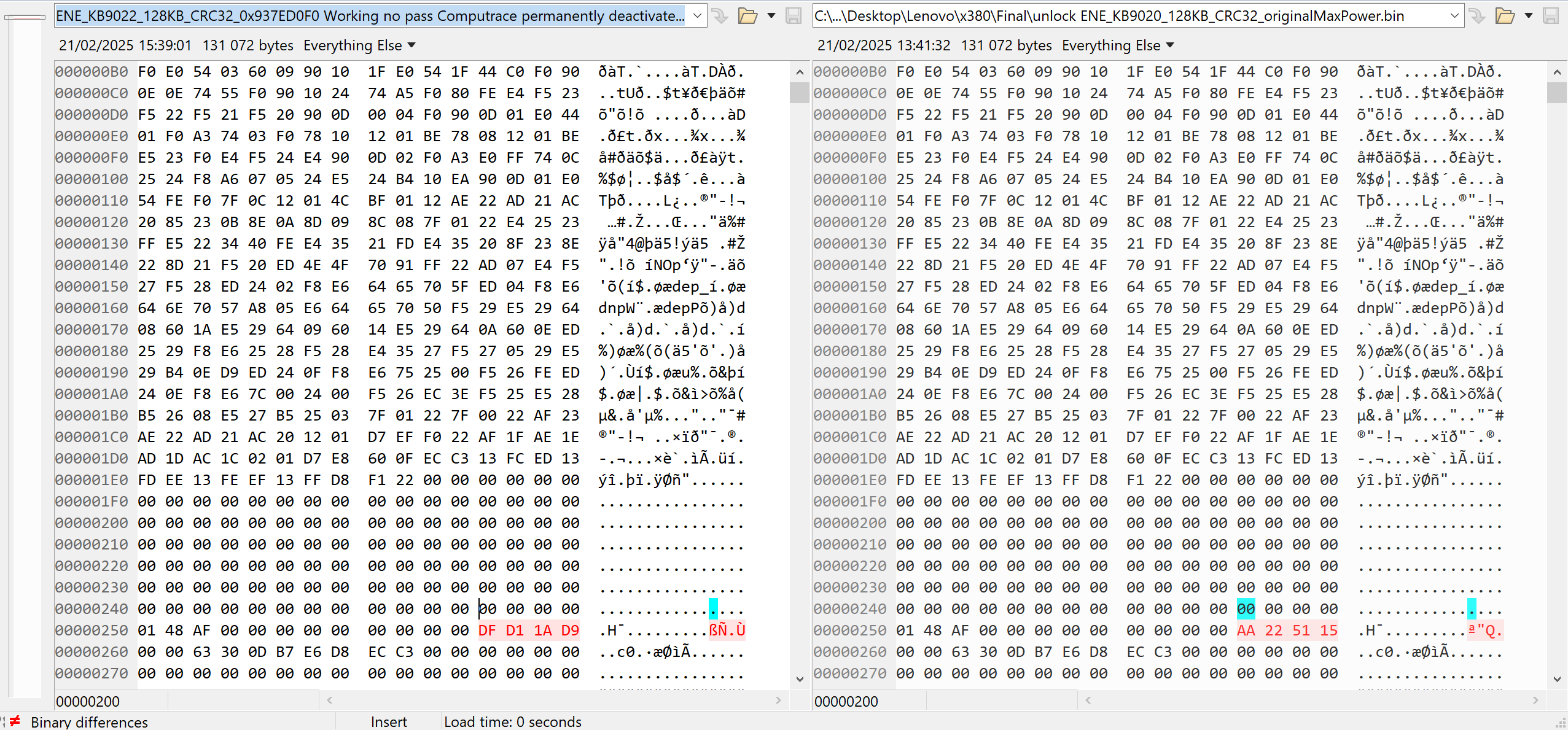

          #64
          Update : got a bit sick. Computer is working no problem : I had the choice to permently disable computrace (which is done ) and supervisor password is disabled with no errors thanks to MaxPower EC file . The working bios for x380 is from 4Matic (Thanks). I managed to learn a bit from the dump provided. So i am assuming that computrace are those two 60 on adress 00000200 which needs to be zeroed out in order to have the choice to remove computrace. Supervisor password is disabled from zeroing out from adress 00000210 to adress 00000230 approximatively (I uploaded a binary diff between the original EC file and the one provided by MaxPower). As a bonus, I also read the EC chip when computrace has been set to permanently disabled beforehand (I uploaded the binary diff between MaxPower EC and the one read on the EC chip). Last thing here , are all the EC file in a compressed archive for ressearch purposes. Thanks for all the help given.
          Click image for larger version  Name:	EC original vs no password no computrace.png Views:	0 Size:	257.3 KB ID:	3578893

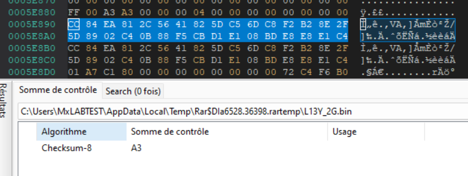

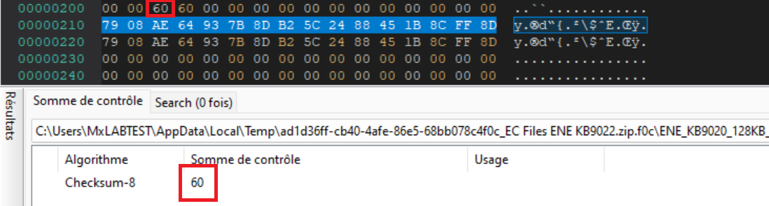

              #66
              Originally posted by FalconPunch
              I managed to learn a bit from the dump provided. So i am assuming that computrace are those two 60 on adress 00000200 which needs to be zeroed out in order to have the choice to remove computrace. ]
              lost, what you think is computrace, is the checksum of each line of the password.
              I will come back tomorrow for that.​

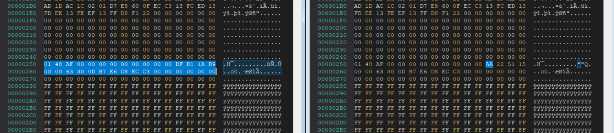

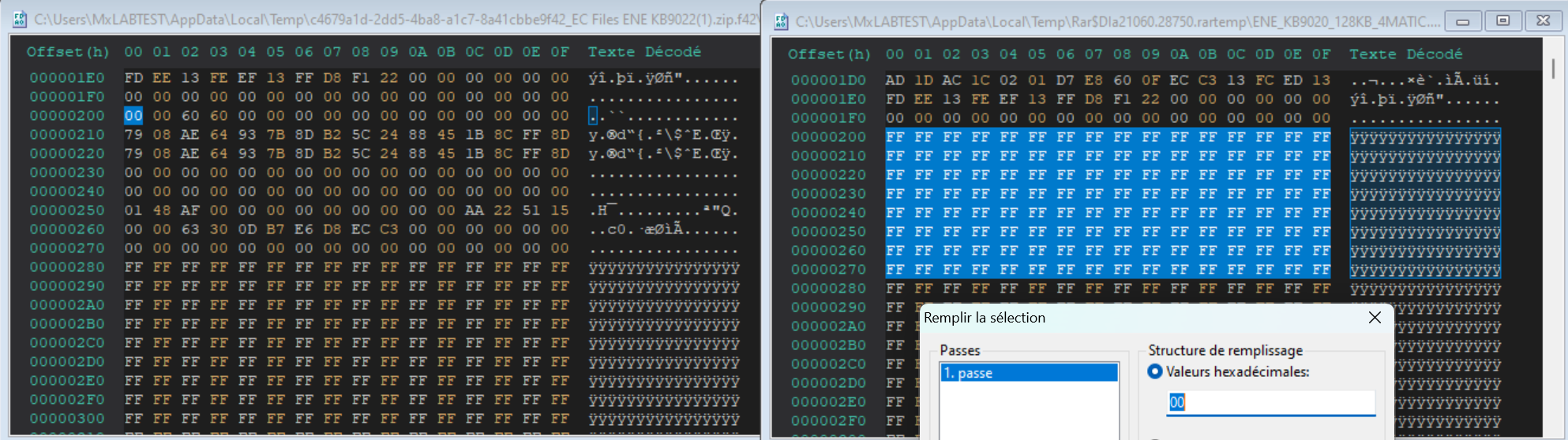

                • FalconPunch
                  • Oct 2023
                  • 20
                  • France
                  #68
                  Gosh, i am bad at sinking ship games, Ill need to check the other EC files i have
                  • Maxpower3
                    Bad Veteran
                    • Feb 2018
                    • 1224
                    • France
                    #69
                    on the double file, you must take 2 lines
                    • Maxpower3
                      Bad Veteran
                      • Feb 2018
                      • 1224
                      • France
                      #70
                      Computrace is enabled .
                      About Computrace: It was not previously enabled on your machine.
                      when you did your tests with my technique or when you entered the bios the first time with it was not present.
                      this was only declared with the gayvum file or mine post#47??
                      already no trace in your bios.
                      Click image for larger version  Name:	image.png Views:	0 Size:	10.7 KB ID:	3579232
                      Second, I've encountered this problem before on a PC that doesn't have Computrace enabled.
                      But when I corrupt the data it activates
                      Click image for larger version  Name:	image.png Views:	0 Size:	1,011.1 KB ID:	3579233
                      we also notice, if we compare the files
                      that it is filled with FF while this one should contain 00s here.
                      Click image for larger version  Name:	image.png Views:	0 Size:	257.9 KB ID:	3579234
                      causes errors code 0188 + 0189 and 0177
                      0177 for checksum stories, explained above
                      0188 + 0189
                      if I don't talk nonsense these 2 lines
                      creates RFID errors
                      Click image for larger version  Name:	image.png Views:	0 Size:	154.8 KB ID:	3579235
                      what becomes interesting now is if we compare my file with the one you deactivated computrace .
                      value has changed for the last 4.
                      I haven't yet fully understood these lines but we can spot them because there are always 4 bytes on one and 4 on the other side with 00s in the middle

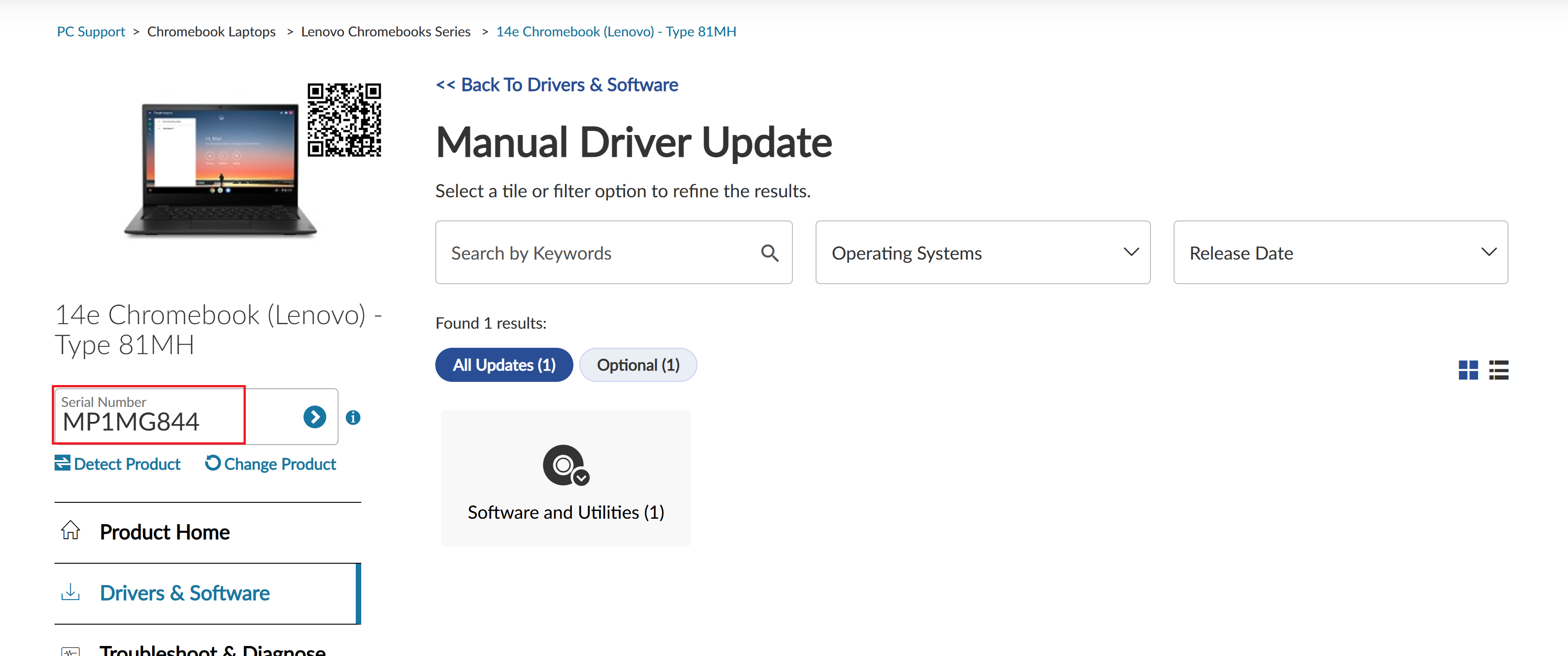

                              • hoaca388
                                Badcaps
                                • Jan 2022
                                • 11715
                                #75
                                Originally posted by spacez
                                HELLO X380 not power . only fan and keyboard lights on for some secondes . kindly fix my issues . thanks
                                Lenovo ThinkPad X380 yoga
                                DTZS1 LA-F421P Rev 1.0
                                SN MP-1MG844 19/09​
                                No bios for Chromebooks on Lenovo homepage.
Name:	2025-03-11 17_32_53-chromebook laptops __ lenovo chromebooks series __ 14e chromebook __ 81mh __ 81m.png

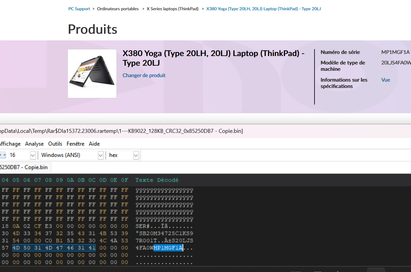

                                • Maxpower3
                                  Bad Veteran
                                  • Feb 2018
                                  • 1224
                                  • France
                                  #76
                                  MP1MGF1A
                                  Bios and Ec version 1.29 R0SET45W/R0SHT45Wcertainly
                                  Click image for larger version  Name:	image.png Views:	0 Size:	247.9 KB ID:	3590763
