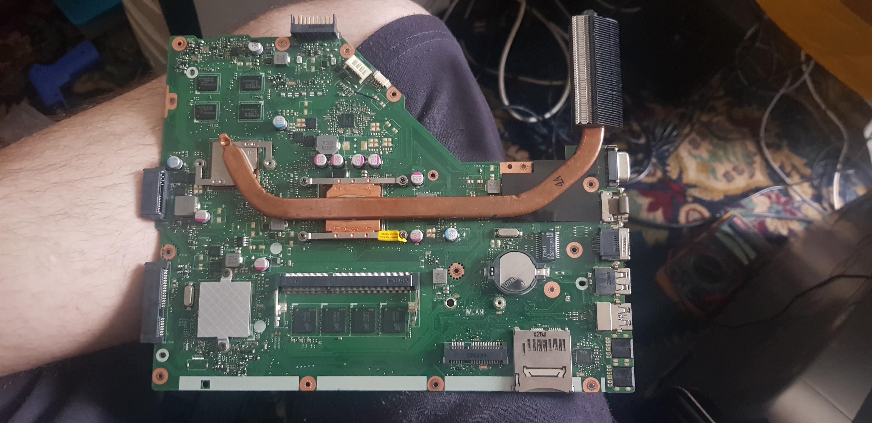

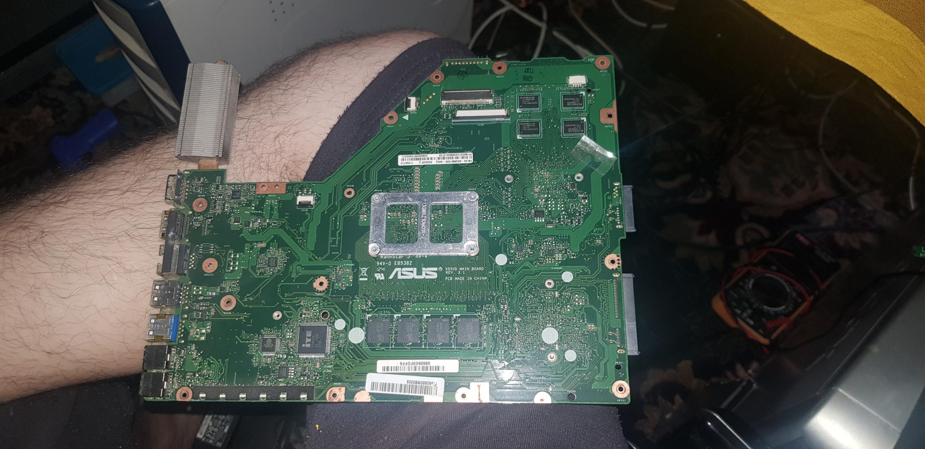

    As the title says, I am in need of a "F1" named BIOS, or a known clean ME dump for an ASUS F55V (or X55VDR, according to the mainboard)
    Information that I could gather:
    - fan runs 100% all time
    - discrete GPU is not detected, has not been physically tampered with, except for repasting as the thermal paste was rock solid at this point
    - soldered CPU, i3-2370M

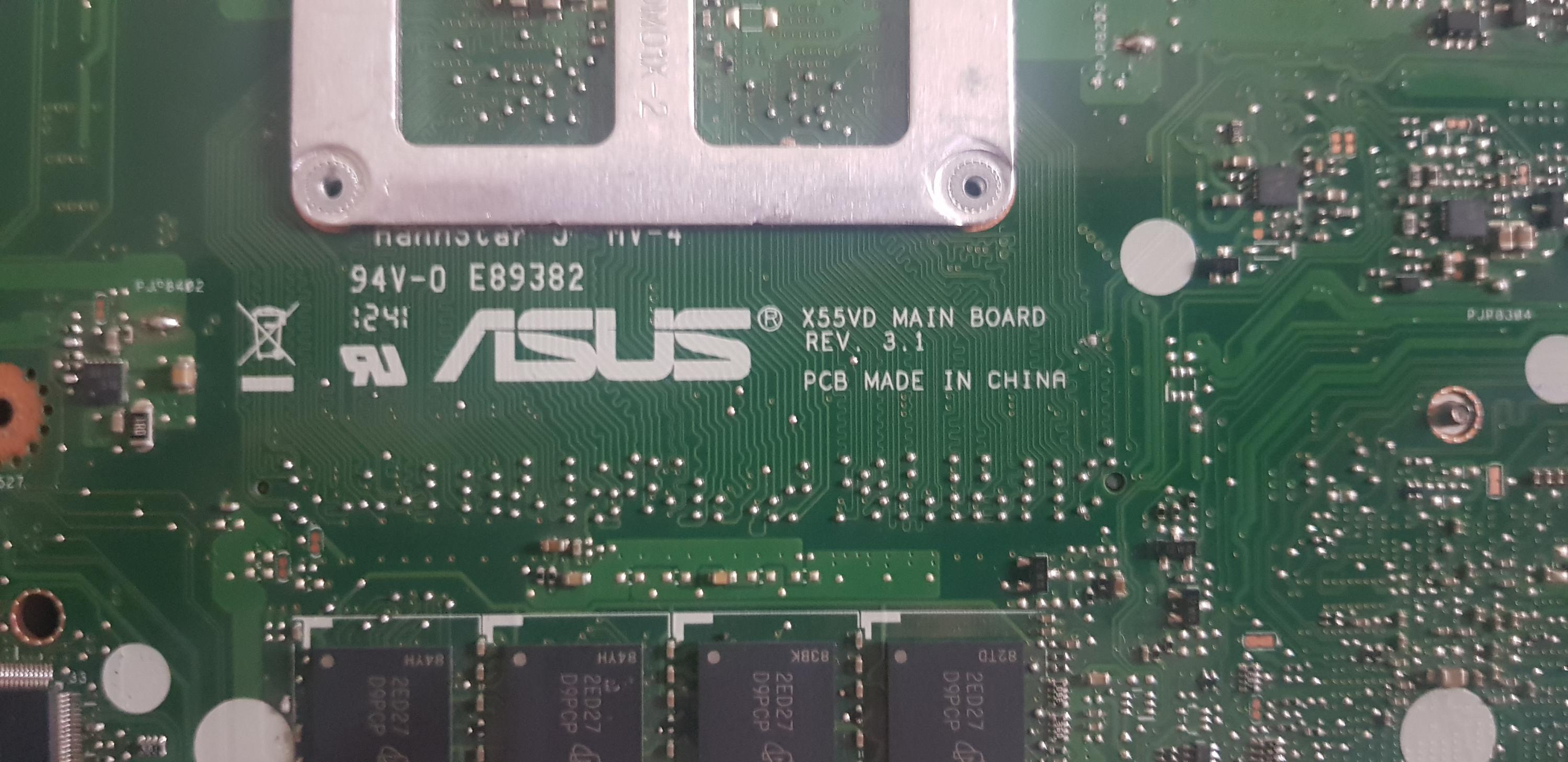

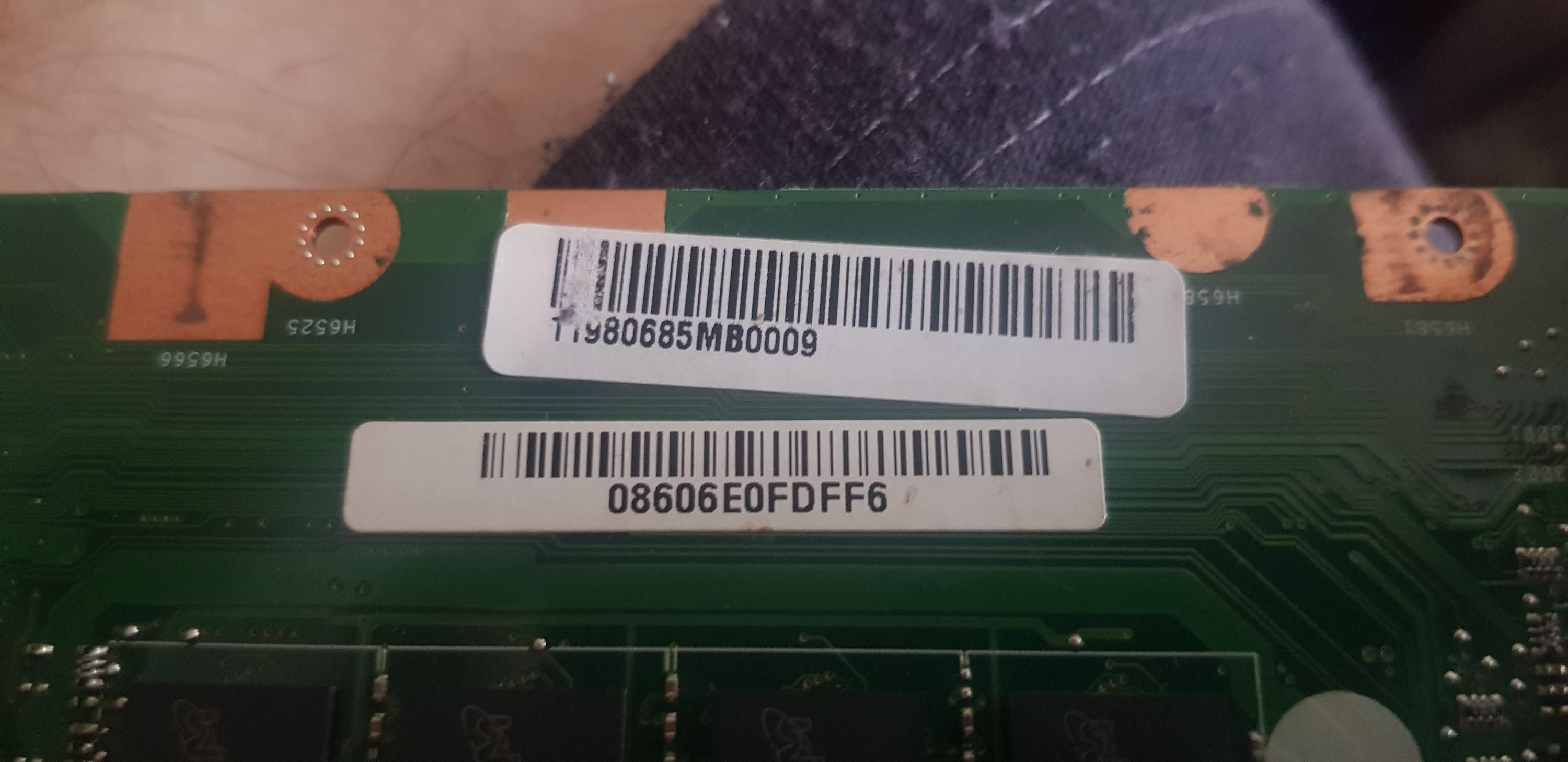

    - mobo model reads ASUS X55VD MAIN BOARD REV3.1, but the barcode adds another "R" after the X55VD model.
    Attached are the mobo model, and another shot showing the type of mobo w/ discrete GPU. I have also included a photo of two other stickers present. The first two torn letters under the barcode are TT (as in Audi TT )
    Any help is much appreciated. I heavily suspect this is a BIOS issue because of the fan running at full speed as soon as it is powered on.

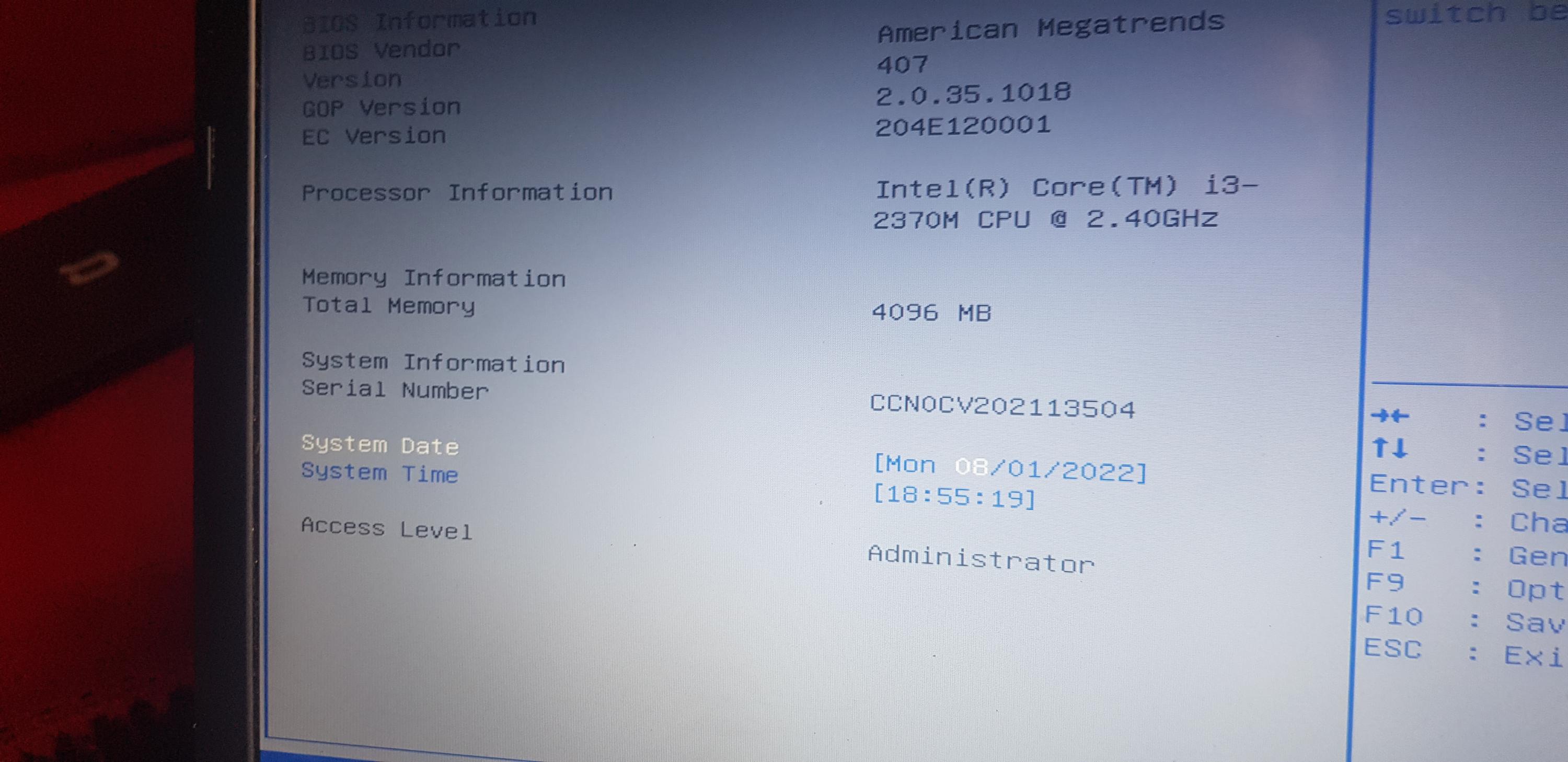

          Tried it, BIOS reports VBIOS N/A, and fan goes full speed midway through Windows boot.
          What I just noticed: the BIOS version is 409, but from what little I could find, the R variant goes up to 407 only. Chances are it's a botched BIOS flash someone did that I just dumped?

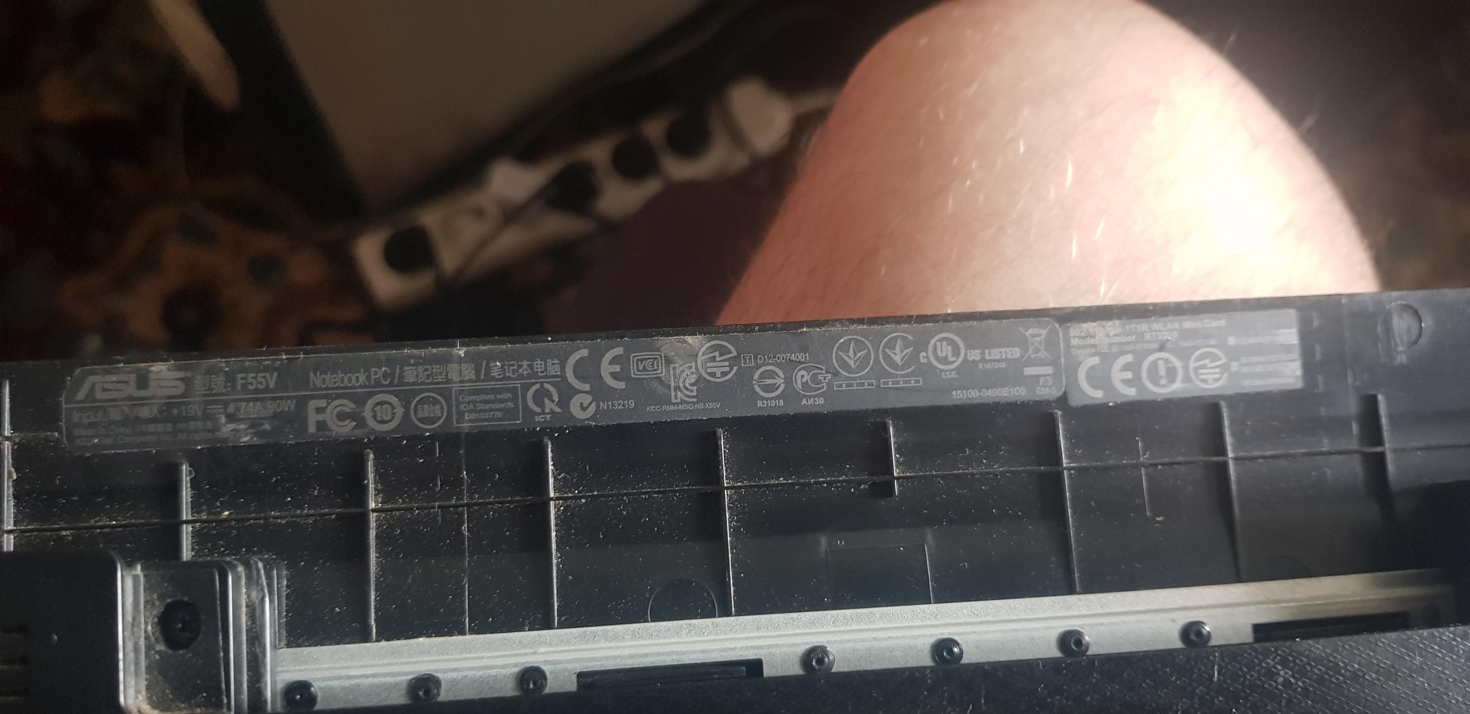

              Yeah, that does seem strange. The case reads F55V, and the most recent dump I did find had mentioned F55V/F55VD and the same mainboard silkscreen as mine (X55VD MAIN BOARD REV3.1). No mention of VDR but I'll check if it works. Maybe ASUS made the VDR specifically for the F55V models?

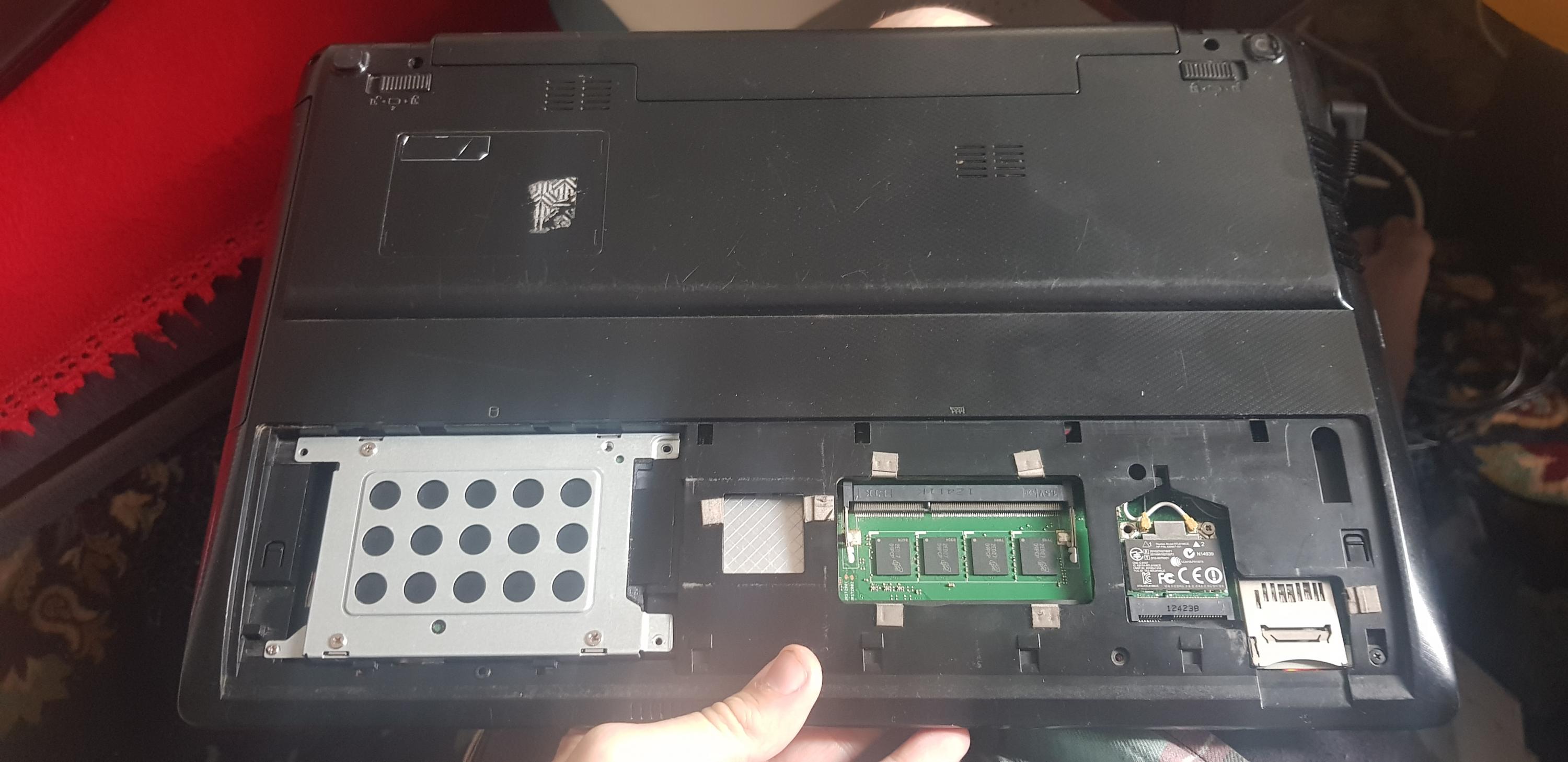

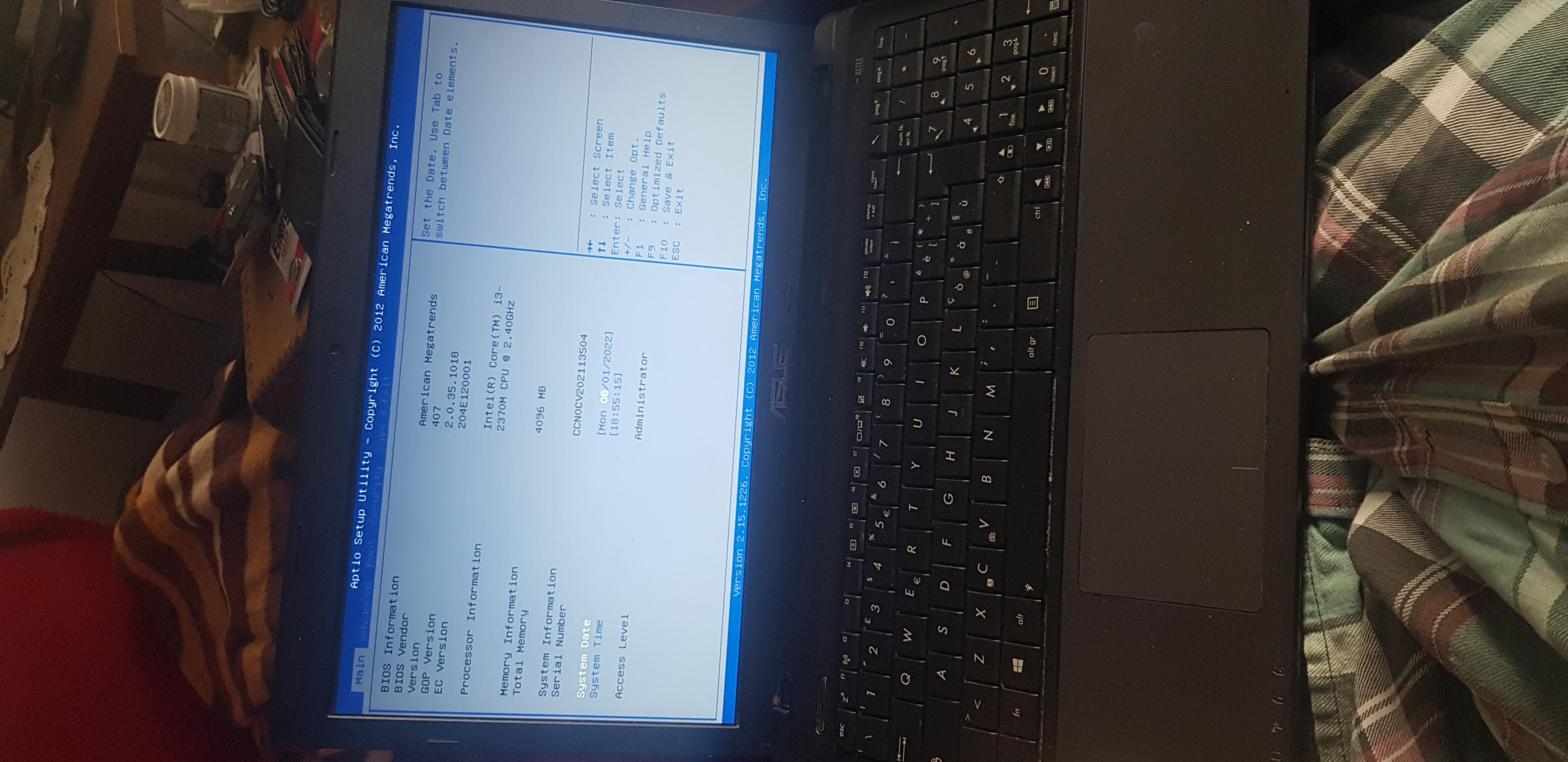

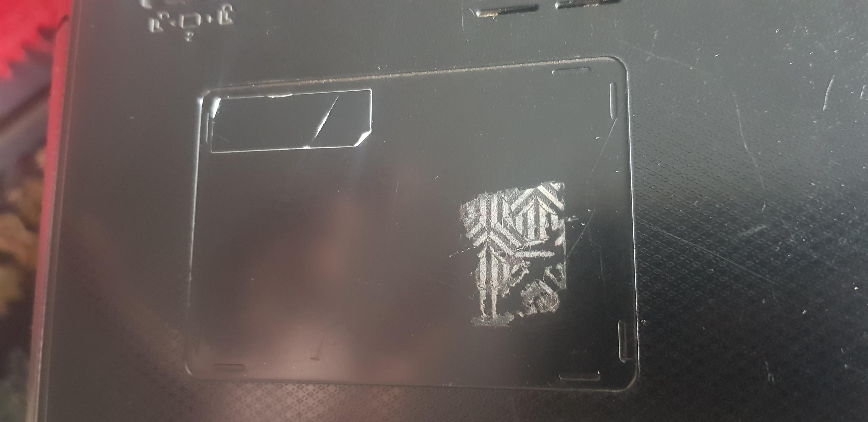

                                I can confirm CCN0CV202113504 appears. Unfortunately, the bottom case stickers that would show the model and SN are blank (possibly worn off or something else?) and the Windows 8 sticker that would have been there is torn off.
                                I'll quickly update this post with the BIOS showing the same CCN serial number though, as I see it appears over there. Can't say for the other two as the bottom case is blank in that regard but I can confirm the CCN one thru BIOS.
                                EDIT: Uploaded the photos of BIOS in actual state, as well as the bottom case. If needed, I can also show a photo of device manager missing the 610M and nVidia installer subsequently not detecting any hardware.

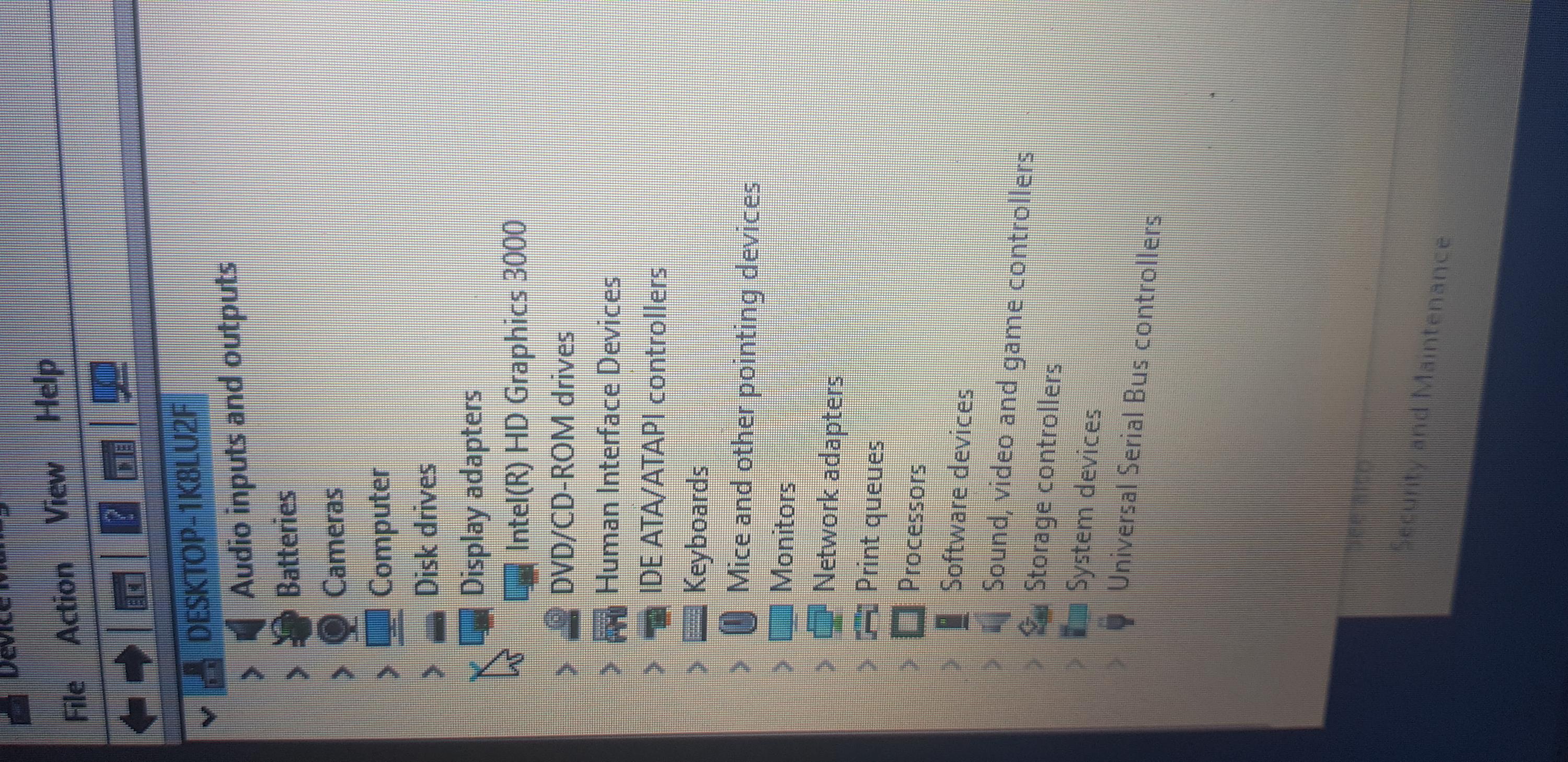

                                  Re: Need ASUS X55VDR BIOS Dump

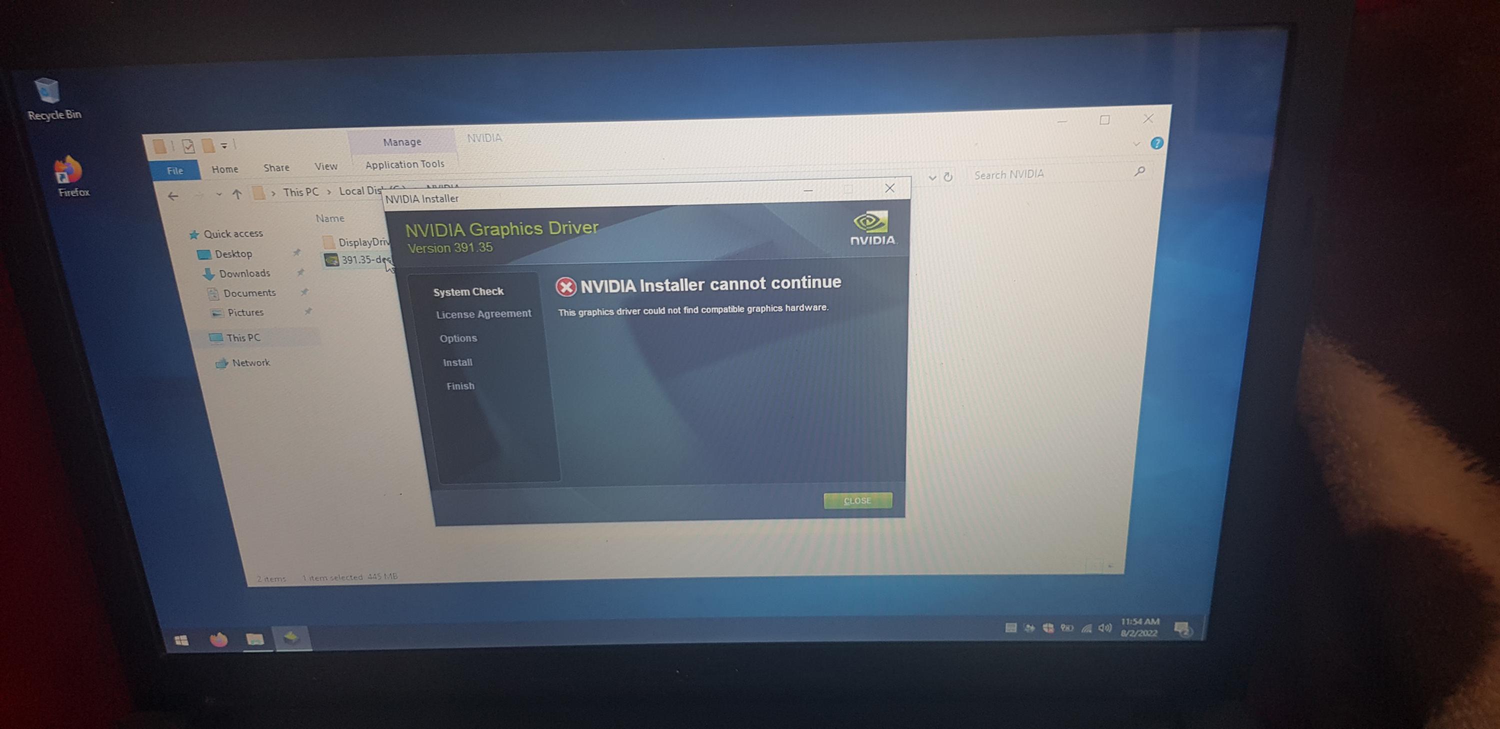

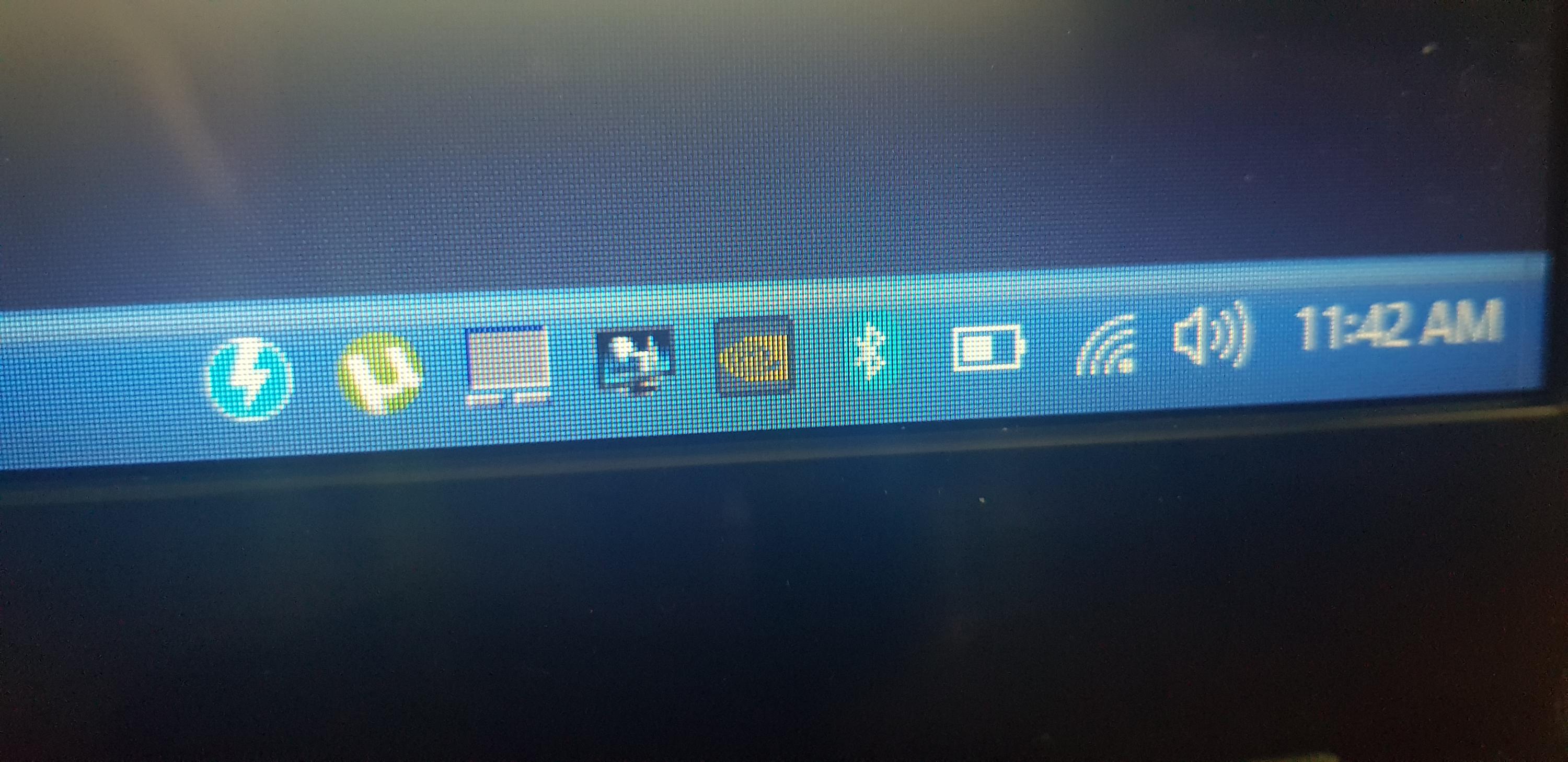

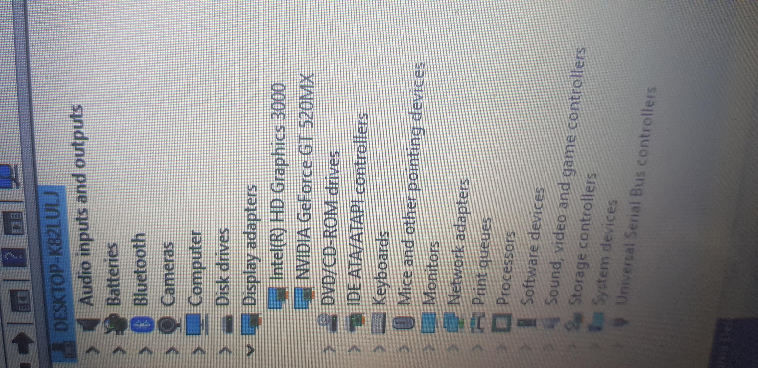

                                  Figured I'd post up the device manager too. I added in two photos from another ASUS laptop I have (X53SC-SX424V) just to show you what it should look like (since both machines have the same CPU - i3-2370M - the difference is the X53 has it socketed while the F55 has it soldered on the mobo) and another pic showing the Geforce installer on the F55VD not detecting any Geforce hardware, despite the GPU receiving power (as it does indeed actively heat up, and I can feel it being warm on the bottom).

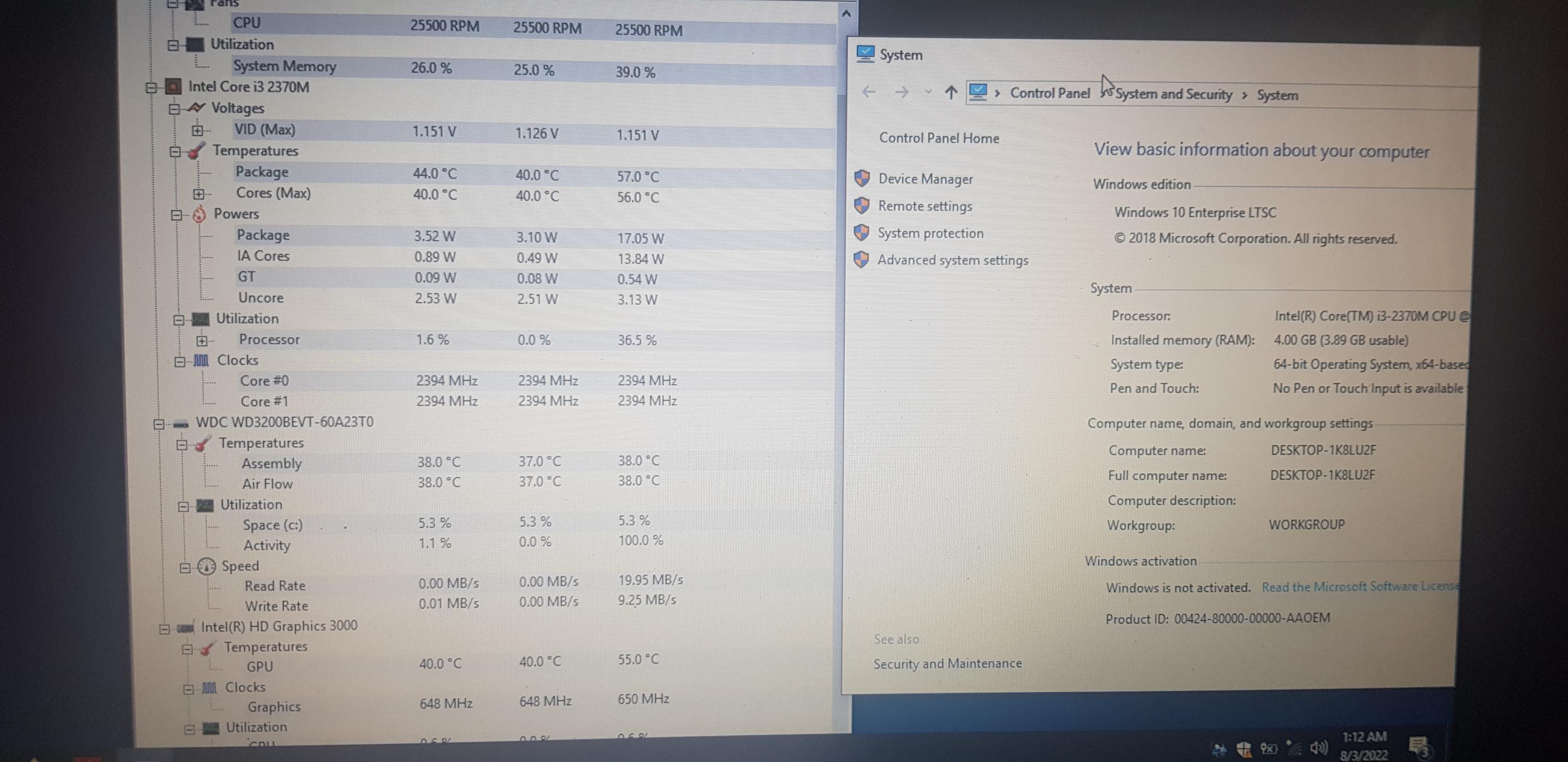

                                      Tested it. 610M still won't show up, and fan will go full blast after a restart.
                                      Interesting finding: HWMonitor reports 2500RPM as normal fan operation, and 25500 when it starts going full blast (as in 100% speed). CPU clock also sits at 2394MHz and won't budge while the fan is at full speed.
