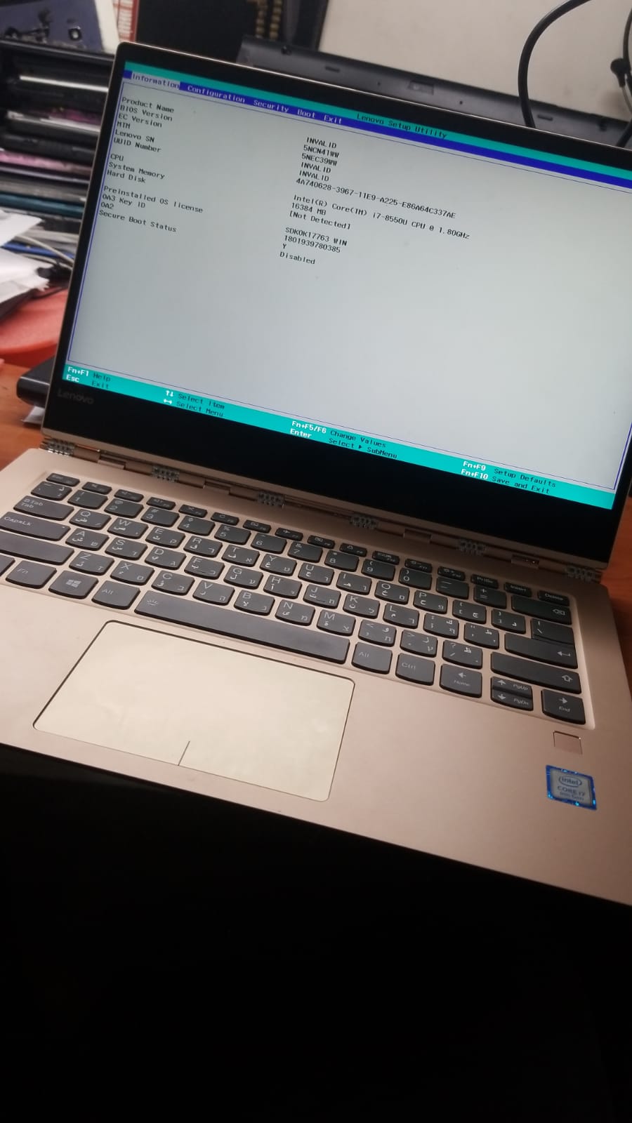

      Thank you soooo much it's working for me, but there is problem in
      SN : INVALED
      MTM: INVALED
      Attached pic:

        TRy

          Still IVALED both of them

            Re: Lenovo Yoga 920-13IKB Type 80Y7 BIOS Clean
            You have to find a manual DMI update tool. With bios, the DMI area has been added but it is probably incorrect or of another device.
