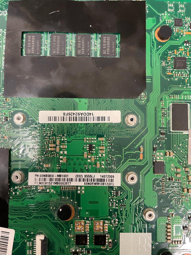

    MB: X555LD REV 3.3
    PN: 60NB0810-MB1001 (332 ) X555LJ
    CPU: SR23W
    GPU: N16V-GM-B1
    RAM ON-BOARD 6GB
    Run but black screen
    Can you help me?
    thx

    Post a picture of the long white barcode sticker on the motherboard https://www.badcaps.net/forum/showthread.php?t=96604

          The bios you posted is for a X555LB .The bios version that shipped with the motherboard is on the bardcode sticker X555LJ ,the picture is at post #3 .

            Try this one. Bios version 604 ,+ DMI + Clean ME firmware.

              thank you but same problem

                thank you for reply, but no luck.
                maybe gpu?
