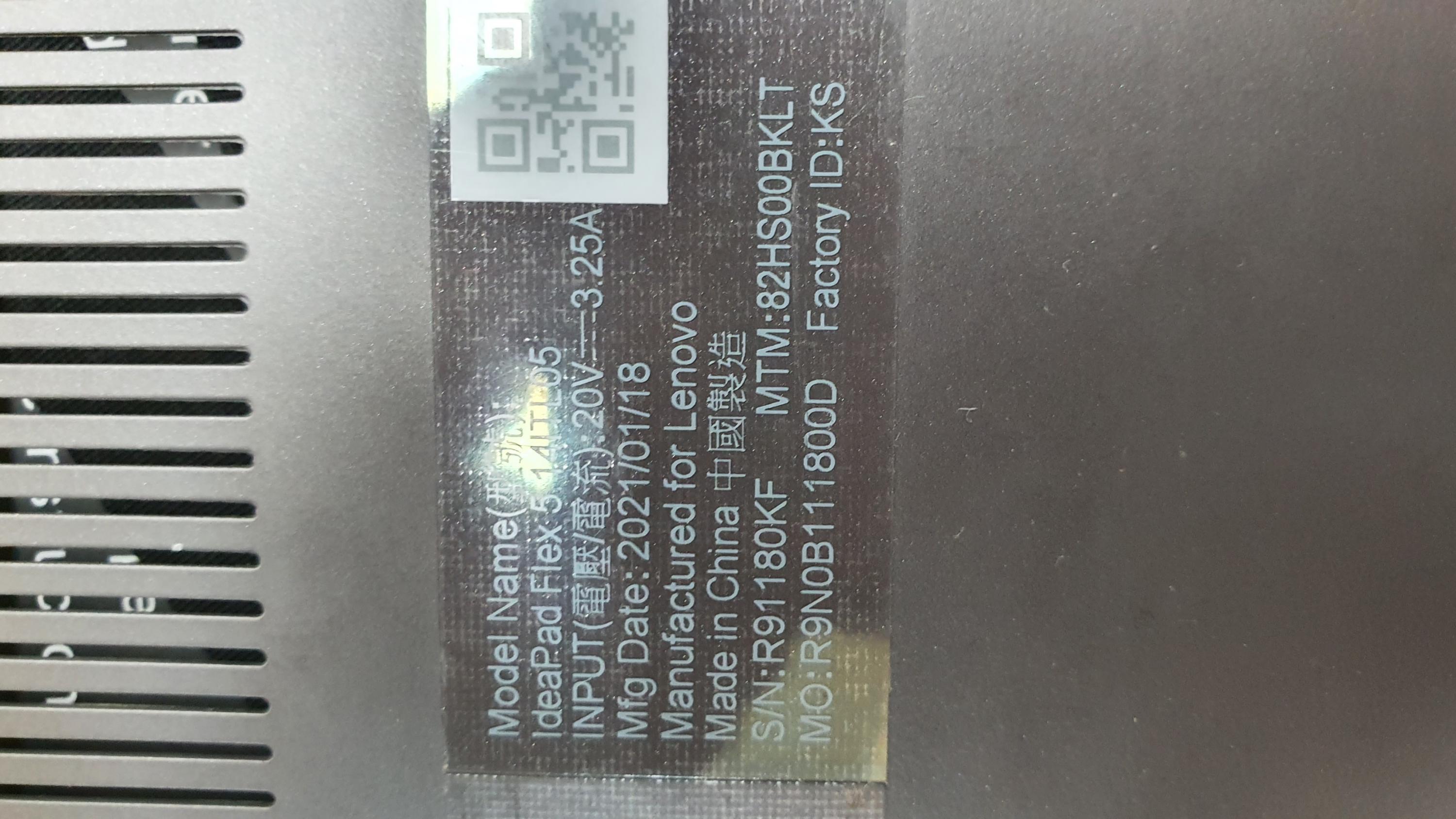

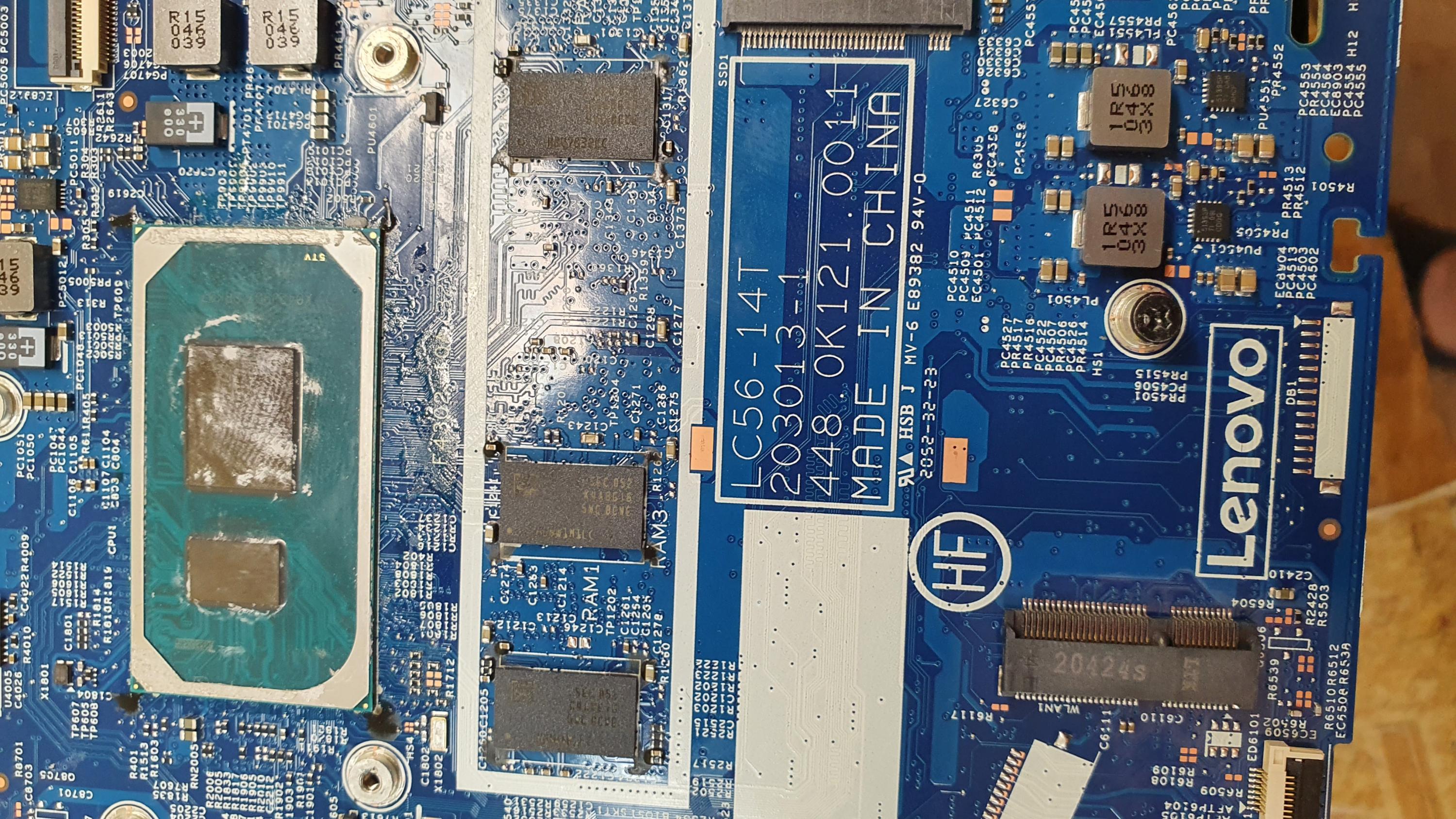

    please help to fix this bios. laptop with black screen.
    code board LC56-14T 203013-1 448.0K119.0011
    Thanks in advance

      Re: Lenovo IdeaPad Flex 5 14ITL05 bios dump
      Originally posted by hoaca388
      Flex 5-14ITL05
      Thanks so much, sir. This bios works fine. problem solved
