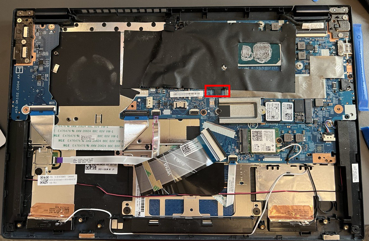

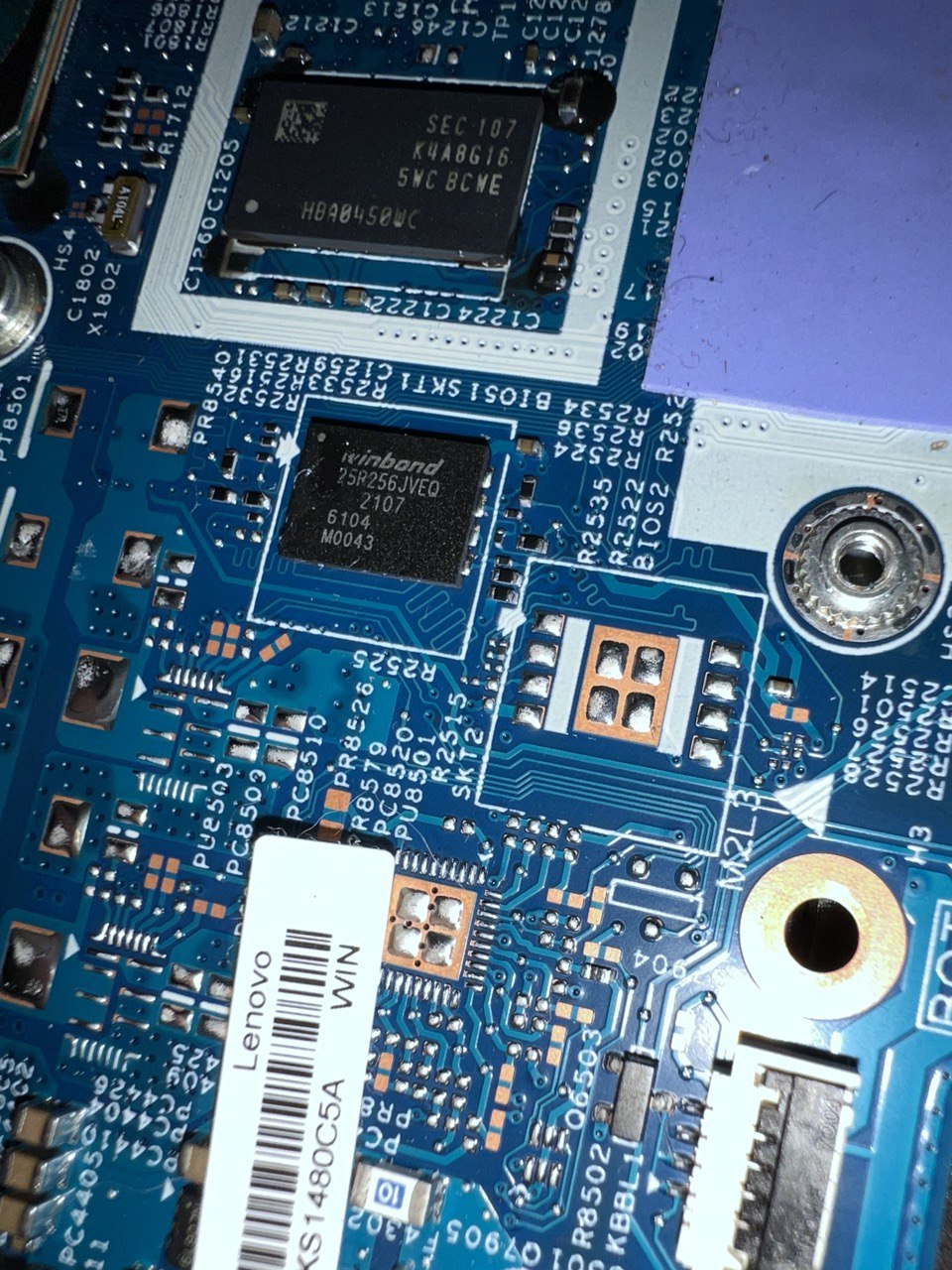

    Hello all! New here, trying to fix a Lenovo Flex 5 14ITL05 laptop.
    TL;DR: How do you connect a programmer to a "leg-less" SPI Flash chip? Model: Winbond W25R256JVEIQ on a board with part number 5B21B33119.
    Attached are photographs of the board for context. One is of the SPI chip close-up, the other is of the full board with the chip highlighted.
    I have a Lenovo Flex 5 14-ITL05 with the following symptoms following a BIOS update:

    I popped the laptop open and wanted to try to reprogram the BIOS. I was trying to take a back-up from it, but the flash chip isn't something I'm used to connecting to. It's "leg-less" (not sure what the proper term for this is). I'm not sure if it's possible to program it even if I were to remove it from the board.
    It's a Winbond W25R256JVEIQ flash chip on a board with part number 5B21B33119.
    I noticed that another post in the BIOS requests forum made reference to this chip.
    I would appreciate any advice that you can offer me.

    You need the right gear to do it, which you may not have. Quickest and simplest way is to remove it off the board with hot air, put it in a WSON8 to DIP8 adaptor and dump the contents with a SPI programmer. You upload the contents to the BIOS group, and one of the guru's there will fix it. Reprogram and put it back on the board.
    So you are going to need a hot air station, the programmer and an adaptor.

      The WSON8 to DIP8 adaptor was what I was looking for. I understood the kinds of equipment I'd need for the desoldering, the programming, and the soldering--but not how I'd get it to connect without any legs.
      It's my first time soldering and this might be well out of my league, but I'm going to practice on some boards and give it a shot since the laptop's dead. Thanks for your advice.
